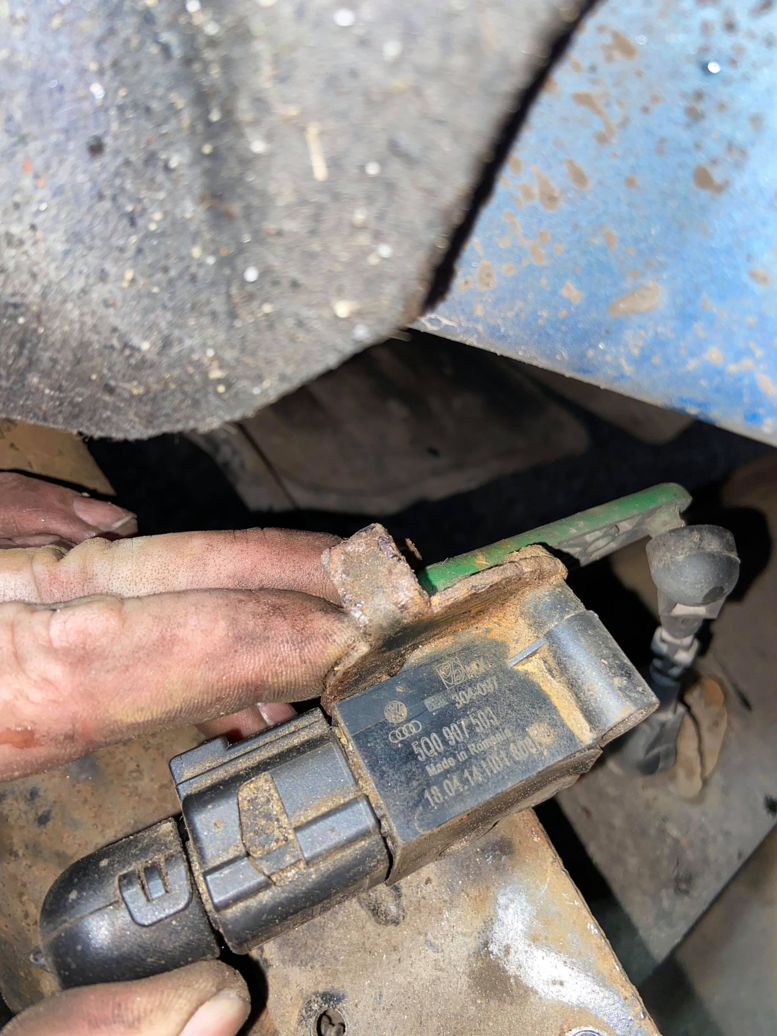

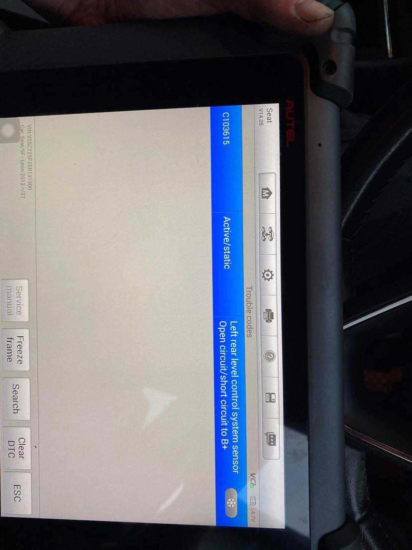

Hi Folks,
I've had a 'Headlight Range Control' error for the past while in my 2014 Leon. Plugged it into the scanner and was given error code C103615 for the left rear level control system. Then I got a look at the part in question so I could find out the part code (5Q0 907 503), I've had a look online and haven't had much luck, there are plenty of options however a lot say they're for the front left, right etc. and I just wouldn't be sure I'm buying the right thing.
Has anyone had this issue before and would you know where this can be bought? I am based in the UK.
Any help is appreciated, cheers.

Did you have any luck in sourcing one of these? I have the same issue as you and the level sensor I require is the same as yours. As far as i can see there is only the one level sensor on my car. However when searching the part number of the sensor the ones I find all have completely different metal fittings.

I did get sorted but only after I went to a scrap yard specialising in SEAT / VW / SKODA vehicles. Luckily they had the same model car as mine in and were able to just take the sensor off the scrapped car and sell it to me. Got a mate then to fit it and have had no issues since.

Thanks for the reply. I have been trying to source one at a reasonable price. Getting quotes around £160 for a brand new one, which seems a bit steep. Hoping I can remove and reuse the bracket parts and get just the sensor slightly cheaper from something different. Seems the part number of the sensor is readily available but with different brackets etc for the different vehicles. I am reluctant to buy a second hand one incase it's also duff. Seems quite common for these to fail.
