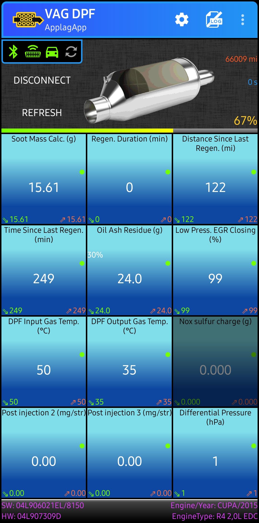

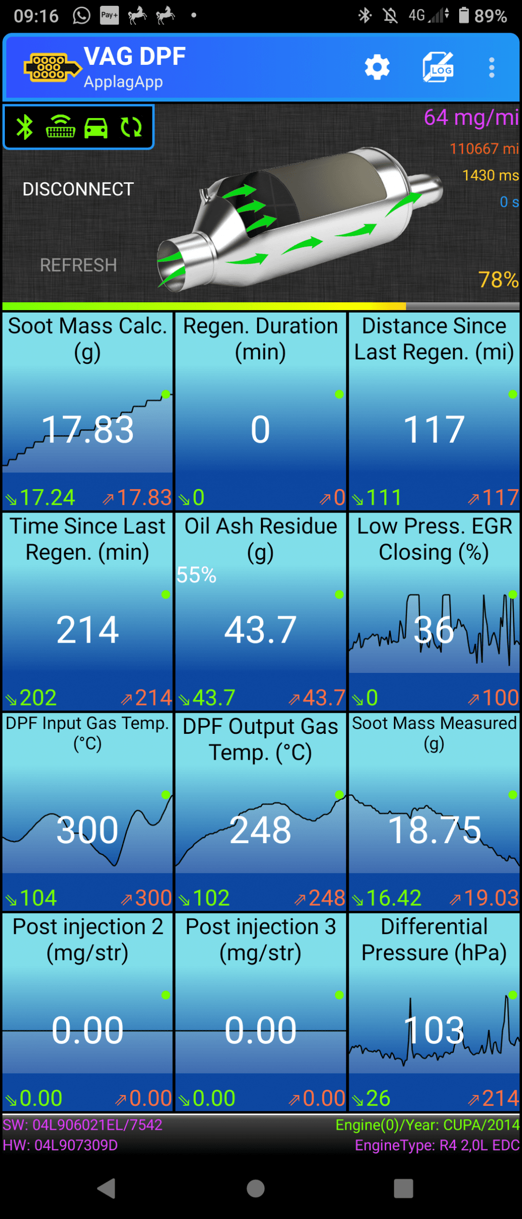

It will start to build up again after a regen so that should be fairly normal. Try and see how many miles it does before it gets to about 22 grams as it should trigger a regen around then.
If you had VAG DPF, it would be a lot easier to help!
I’ll get it downloaded. Guessing it’s for android?

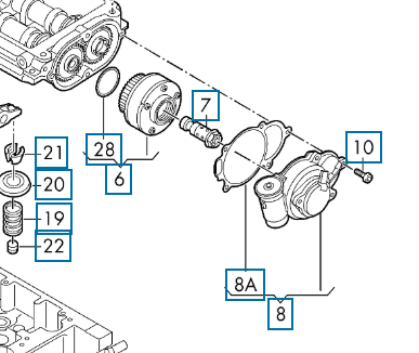

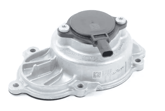

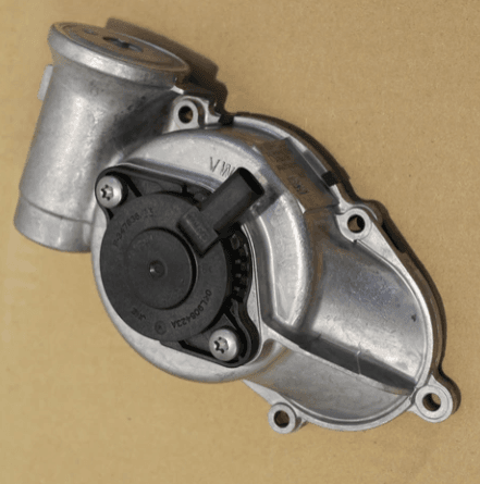

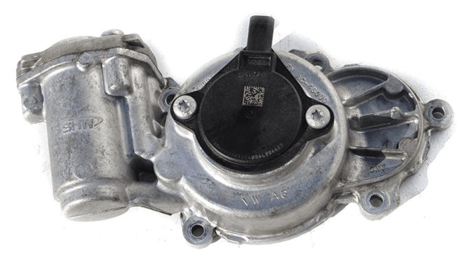

3) Known issue with VVT. I let my glow plug light go out and wait a few more seconds before cranking. Sometimes helps, sometimes doesn't. Worse in cold weather.
4) Buy a Carista dongle and get VAG DPF app on your phone. You can then see the state of your DPF, when it is due a regen, performing a regen and also see how much `bottom ash` is in the DPF (basically how used/full up it is). A DPF light coming on suggests it is not completing a normal passive or active regen and can be a symtom of other issues. Not the end of the world but not to be ignored and for £30 you can monitor it yourself.

Regarding point 3; see my previous comment! I don't even have VVT and still get occasional long crank! :oops:
Further research on CUPA-CUNA from my 'small' sample of cars for sale on autotrader:
ALL DSG's have CUNA engine which is ULEZ compliant and has VVT
early 2015 MAN cars are CUPA which are NOT ULEZ compliant and do NOT have VVT
later 2015 MAN cars are CUNA which are ULEZ compliant and DO have VVT
CUPA = NO VVT
CUNA = VVT + additional EGR
Edit:
Just to add it looks like all Golf GTD's have the CUNA engine which = ULEZ + VVT
Octavia looks to follow the Leon regarding CUPA/CUNA, but I also found an early 2014 Octavia with DSG AND CUPA engine - so maybe there are early Leons with DSG and CUPA engine - just weren't any on autotrader!
