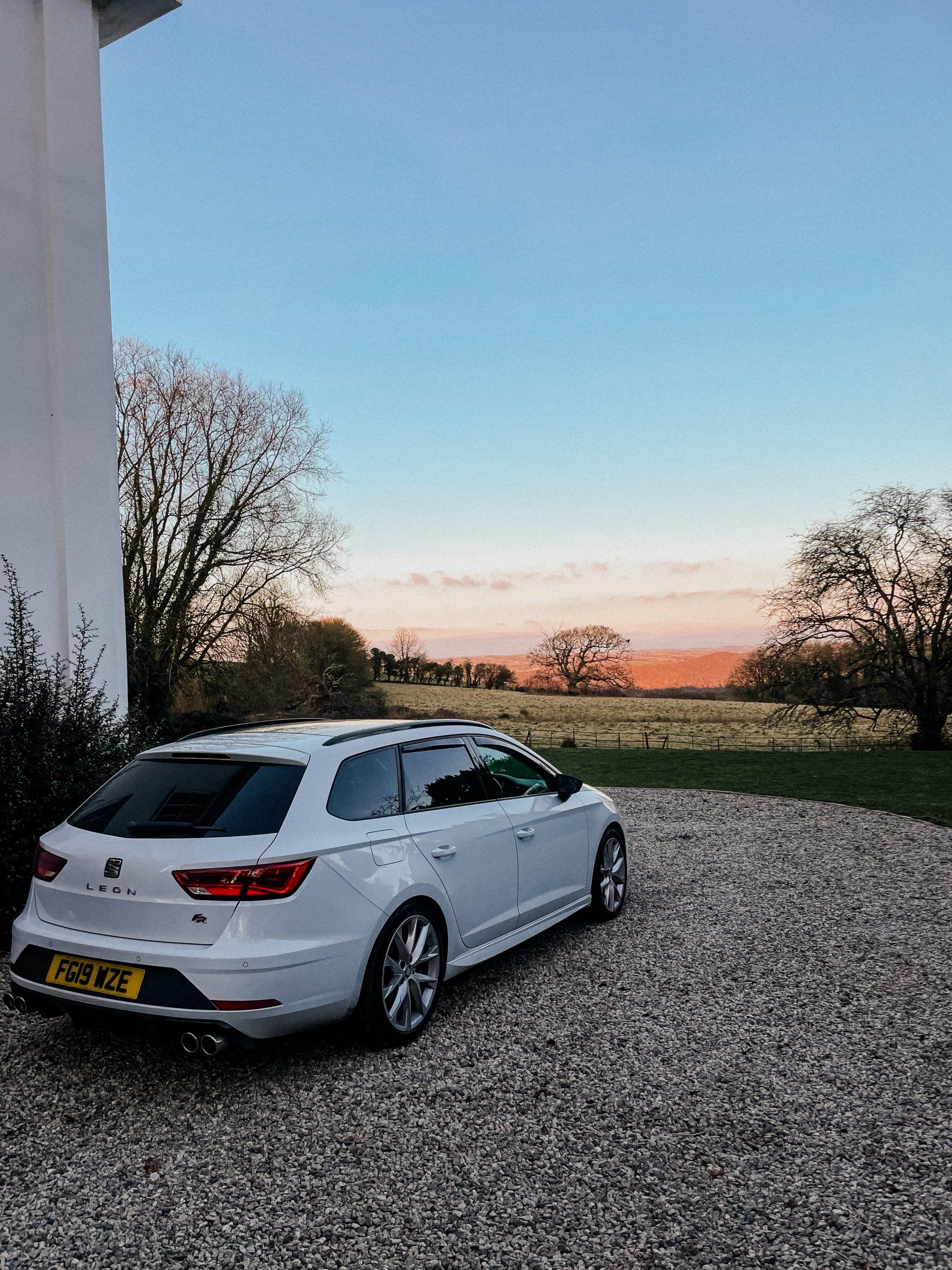

I did!
I went to an independent exhaust place and got a backbox delete with quad tips. See photos below. This is on my 1.5TSI 150 2019 so it has the GPF so the sound isn't much different from stock. See photo. On reflection I think I'm going to swap them for oval tips as opposed to round and have them adjusted so they sit underneath the diffuser a bit more so they feel more OEM+

I did!
That’s a very cool picture mate, love it!
I’m going to be changing my 23 ateca 190 to the same sort of thing with reiger diffuser but considering the GPF may have to go mid pipe too, in order to get the sound I want (not pierce your ears loud just a nice deep bass sound).
Ovals would look cool, for me on a white car I’d go with black tips with the blue steel (or orange or pink) Etc
