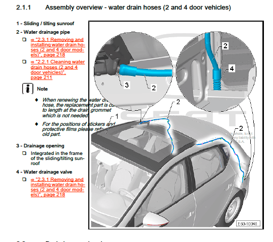

Hello,
I have a 2015 Leon with the sunroof.
I can’t seem to find any info regarding the from sunroof drains. They seem to not go into the A pillar in the cabin, but simply drain along the edges of the windshield.
All info or threads i found are related to the estate version which clearly has the usual drain tubes in the a pillar.
Anyone has any more info regarding this?
Also, has anyone with the hatchback+sunroof combo did a windshield replacement? Curios if the sunroof drains were affected in any way.
Thanks!
Dont have a sunroof but following may help show you where it goes

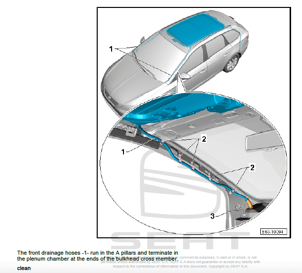

Yes sorry did not look properly at the diagram
I have just sent you a PM With some information, check it out.
