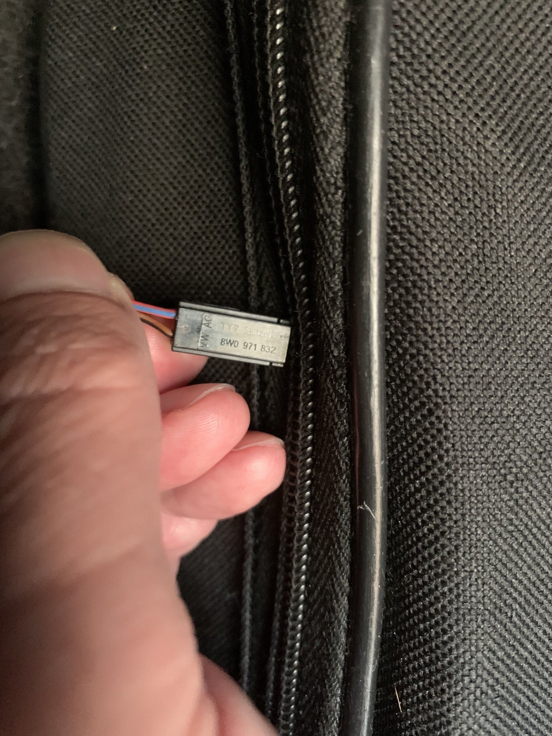

There small but the connectors have the part numbers on too. If you then Google that number I’m sure it would come up on AliExpress probably?
Yeah, this is one of the connectors on my car, it has the smaller of the two types by all accounts.
Mines the bigger / wider ones… took a bit of getting the angle right and it was google auto suggestion which hinted to the first letter which I couldn’t quite make out. The part which plugs into the light fitting is a 1J0971972.
Looks like I’m after - VAG 2 Pin Connector Plug Set Male & Female 3B0972712 1J0971972 + pins.
