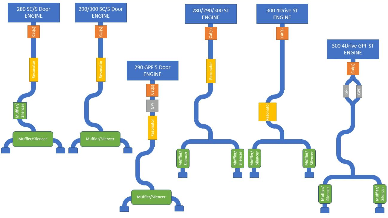

Sorry to be the bearer of bad news.
There are no exhaust flaps on the Cupra of any kind, hatch, or ST. Its all piped in noise via a sound actuator.
Even the Golf R estate didn't have the exhaust flap, only the Hatch.
There is also no resonator on the GPF estate models to delete....
Your options are:
Get a Golf R/Cupra R exhaust (and a Maxton Diffuser) as these are slightly louder.
Aftermarket/custom system.
Reactions: H Rafiq and DaveMac
Your options are:

Besides changing the exhaust to Golf R/R ST or aftermarket?
If you want to keep the stock exhaust, then only sure fire way is to either get a down pipe without GPF (and mapped) or take out the internals and route the pipework from the entrance to the back box to the exit, but with some perforated tubing, that way you get the extra noise but should still stop drone.
Have a read of this thread:
Cupra interals (same thread as above):
Golf R Estate internals (same thread as above):
