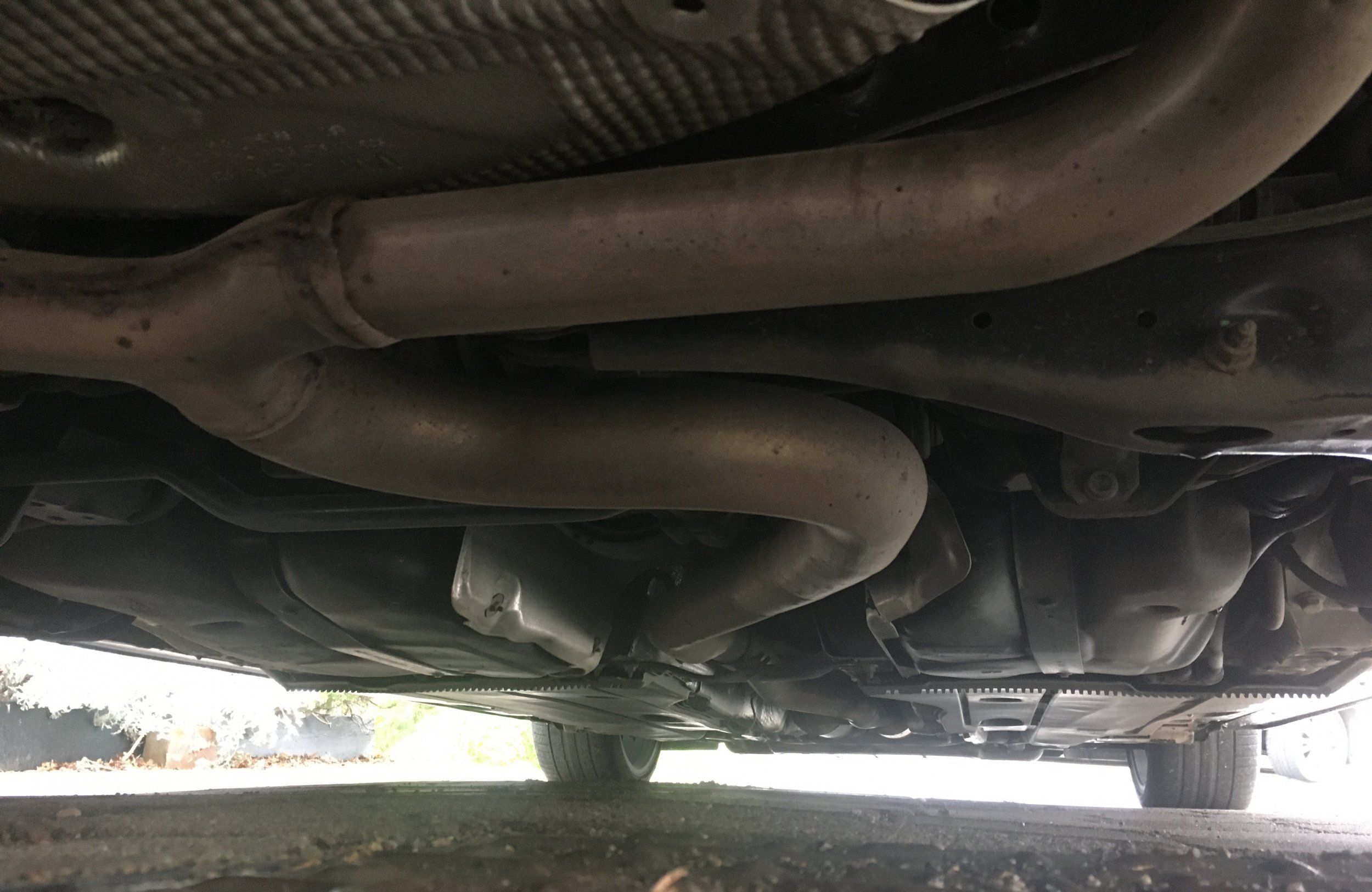

Hi, sorry for another exhaust question on here!
Can I swop out the twin pipe exhaust on my 300ST 4Drive DSG 2019 facelift, for the Carbon R ST quad tip one with no res box fitted?
Is it a straightforward swop if not what are the differences I need to be aware of. Also can it be done DIY.
Have heard the 300 has a single resonator in the centre pipe but I cant see this on mine?
Any help appreciated, cheers

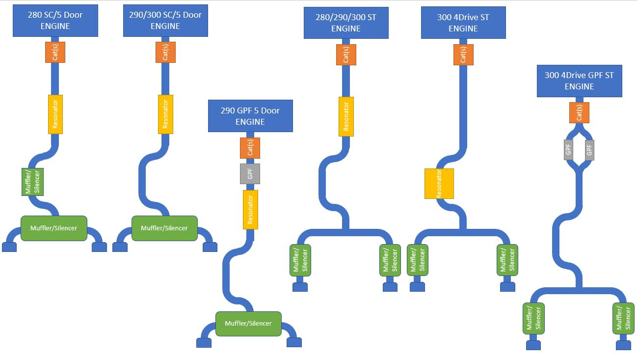

Your car is still a a GPF car, and the estate GPF cars don't have the resonator. Here is a diagram I pieced together to show the differences between systems, however doesn't take into account anything internally in the silencers.
The R ST with the 4 exhaust pipes is laid out the same as the 4drive GPF, its just got 4 exits out of the rear silencers, and likely different internals to support them.
As per @Damo H ’s post above, the single resonator on the 300 ST was removed circa Oct 18, when the Cupras were WLTP compliant and had the OPF/GPF fitted.
FWD cars have the single OPF/GPF, and the 4WD ST has a dual OPF/GPF.
ST R is based on the ST variant post Oct 18, so will be broadly similar in layout to your current car.
Instead of the ST R exhaust, there are a number of manufacturers that are now doing OPF back aftermarket quad tip exhausts. If you go for the quad tip, you may require a different diffuser on the bottom of the rear bumper to allow additional width (carbon edition / R had a carbon version).

Excellent thanks all, so should be straight swop just to consider rear diffuser fit which I have been looking at changing anyway. Suppose in the short term could cut standard diffuser for clearance if req.

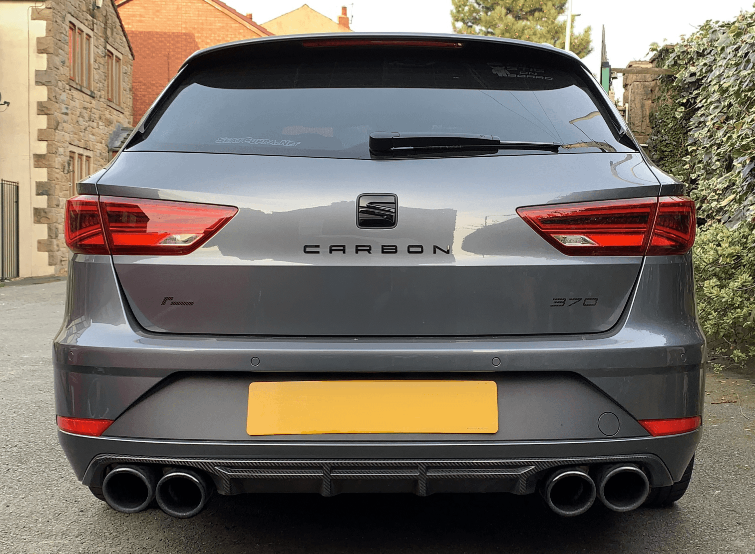

I’m looking for an aftermarket exhaust for my R ST.
The Remus one is a tad too expensive for my liking and the recently released Scorpion one has round tips and not oval, so doesn’t look that great with the Cabin diffuser (doesn’t fill gap in diffuser enough)
soooo
Milltek to a quad (oval) tipped GPF exhaust for the Golf R Estate.
Milltek SSXVW490
Would this be a staight fit on an R ST ??

When you checked the price of the Remus, did you check which tips. One of the Tip options doubles the price of he exhaust.
As a minimum you need 100mm tips for that rear diffuser, something the Remus offers, but as you say Scorpion doesn't.

Cheers Damo, I was hoping you’d have some expert input on this.
Yeah the Remus with Carbon tips is £2100 now (it went up about £200 last year)
With Chrome tips it’s £1400, but a don’t think they will be a good match for an R ST colour wise.
What you say is spot on, about the tip sizing.
I’ve pretty much been out off the Milltek route now as a few people have mentioned quality can be hit and miss.
