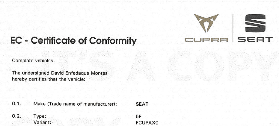

I requested my Certificate of Conformity from VAG - to check my emissions class, but It has my GVW and trailer max kg for my VIN.
CoC Requests <[email protected]>
SuperV8
May 30, 2019
1,836
910
No, the COC is 2 pages.
Guessing your Cupra will have nothing in the max towing limit? - but it's free to request this.
