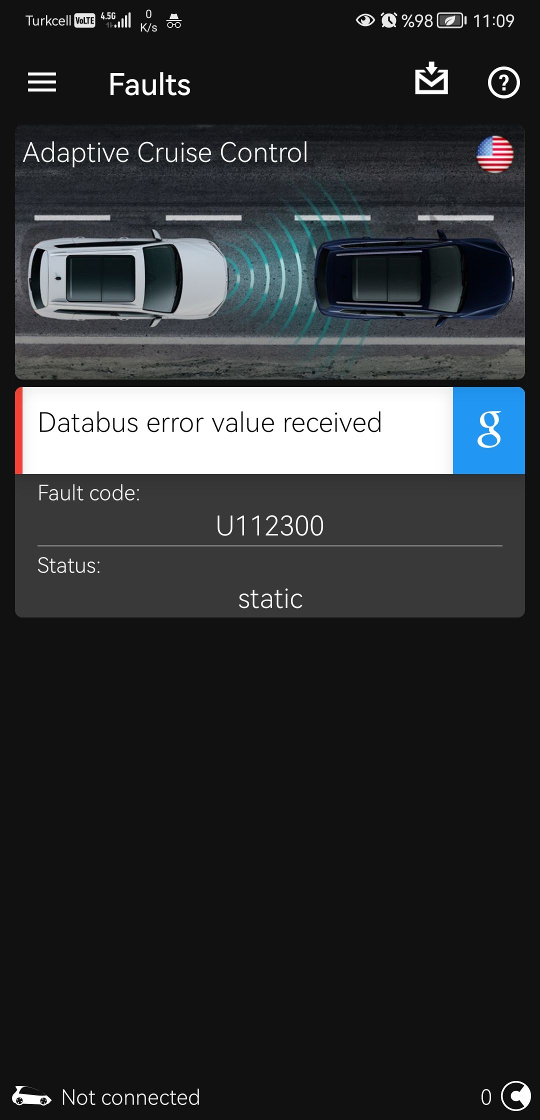

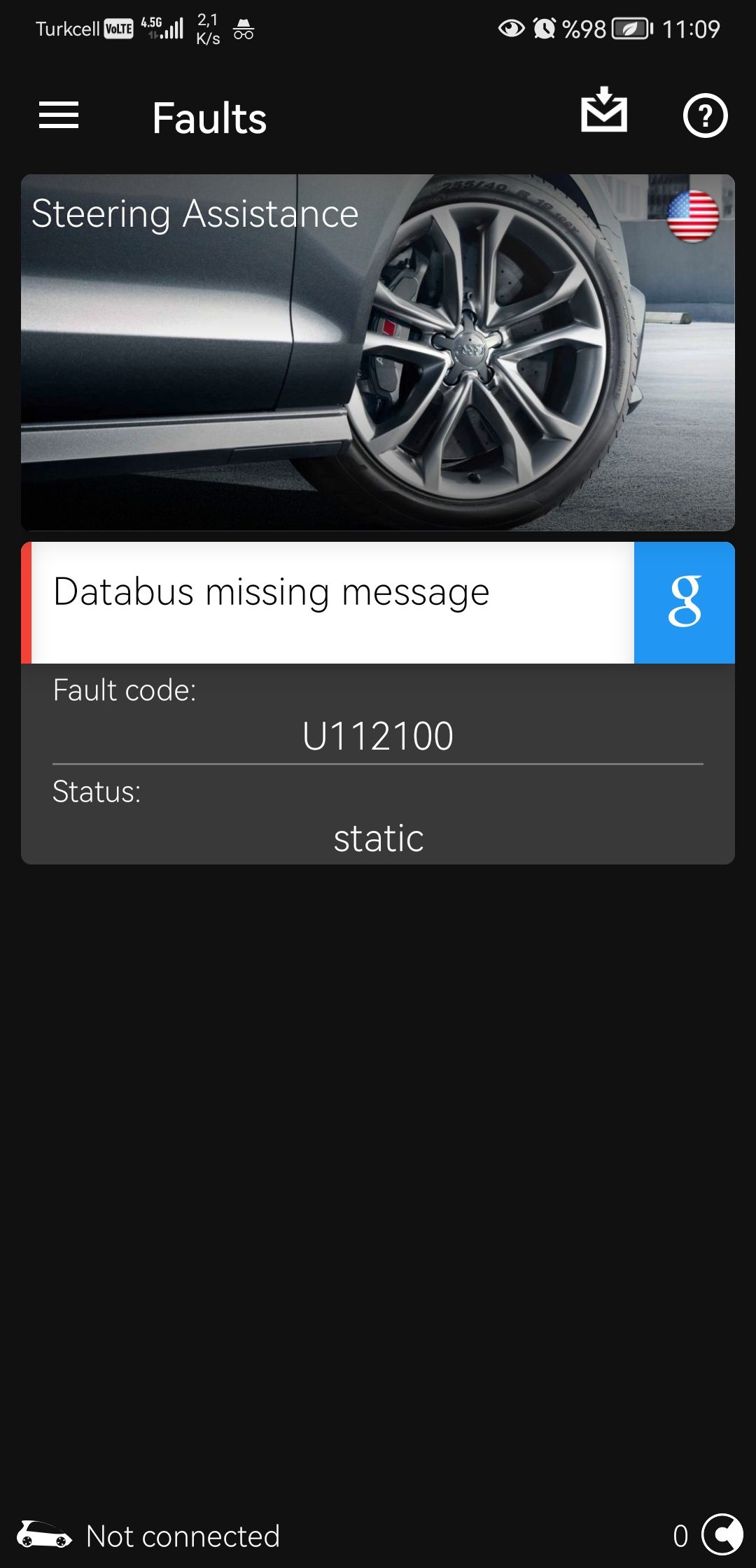

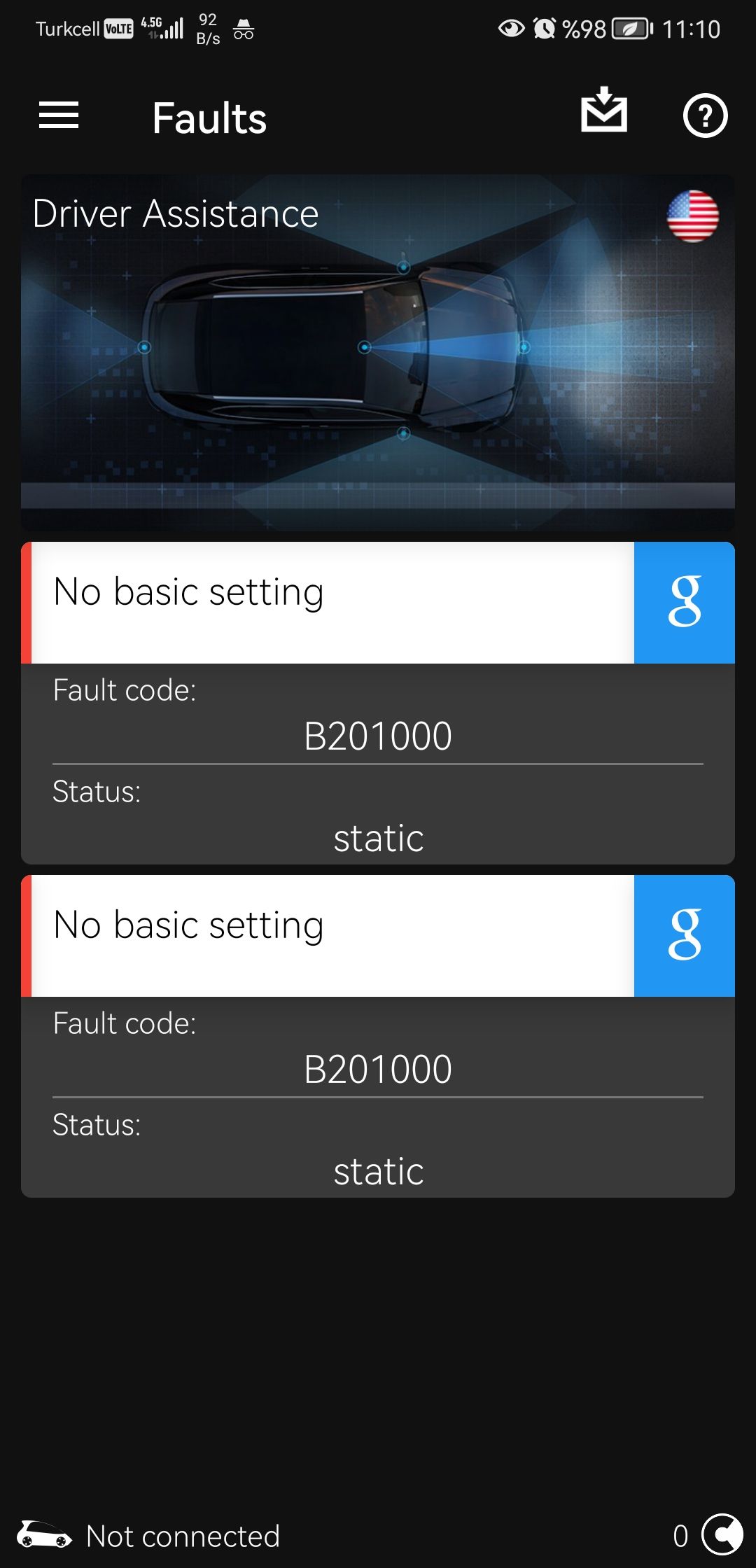

I was able to reactivate it using this code. Thank you very much. However, now new error codes have appeared :) Currently, I’m getting the U112100 error in the Steering Assistance control unit, the B201000 error in the Driver Assistance control unit, and the U112300 error in the Adaptive Cruise Control unit.
Bitte write the Error Text
I managed to clear the error in the Steering Assistance control unit. When everything was working properly, I had taken a full backup with OBDeleven. How can I use this backup to resolve the errors in the A5 control unit?
