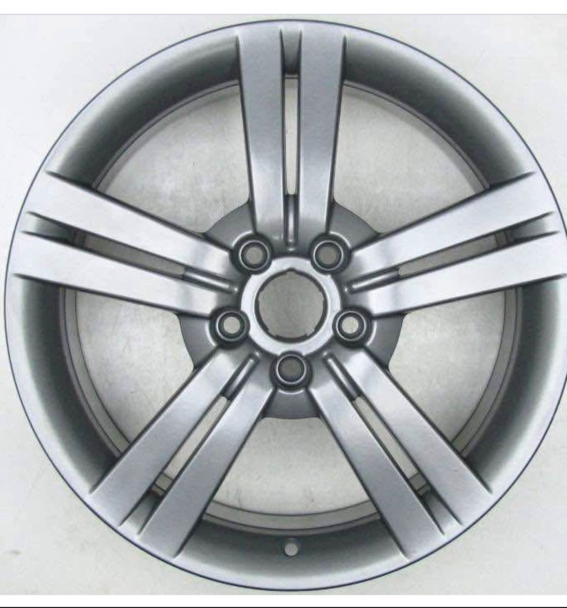

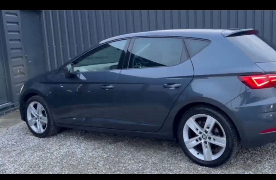

I’m after some advice before changing the alloys on my Mk3 2019 Seat Leon FR. It currently has the standard factory fitted 5 spoke 17” alloys with 225/45 R17 tyres. I’m thinking of buying a set of 18” Seat Andromeda 5 Twin Spoke alloys from a local breakers which have come from a Mk2 2008 Leon FR Tdi and have 225/40 R18 tyres fitted. Would these alloys fit on my Leon?
Both have the same PCD (5x112).
Center bore is 57.06 in Mk3, it is most probably the same in Mk2, though I don't have definite info on that.
Mk3 wheel is 7x17 ET49, Mk2 one is 7.5x18 ET51.
As you can see in the comparison below, the differences are minimal (outside +4 mm, inside +8 mm)
There won't be any problem fitting those 18s, I believe.
