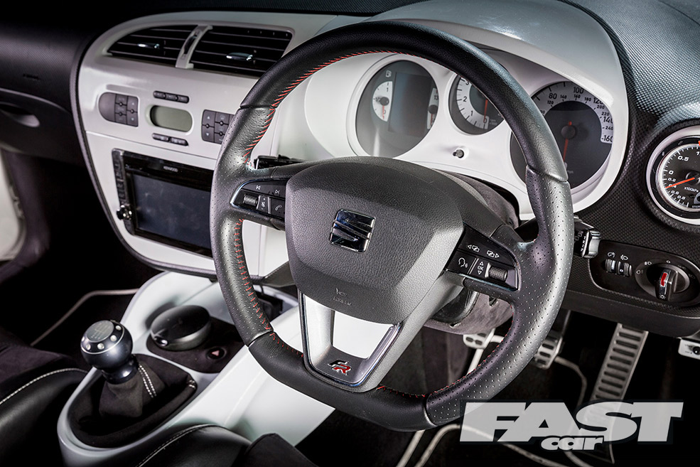

I also want to know whats is needed to get it to work. Its done before see picture.

Hi that look great I’m not 100% sure if you can get the buttons to work the mk3 has a lot more features then the mk2. Ie phone etc

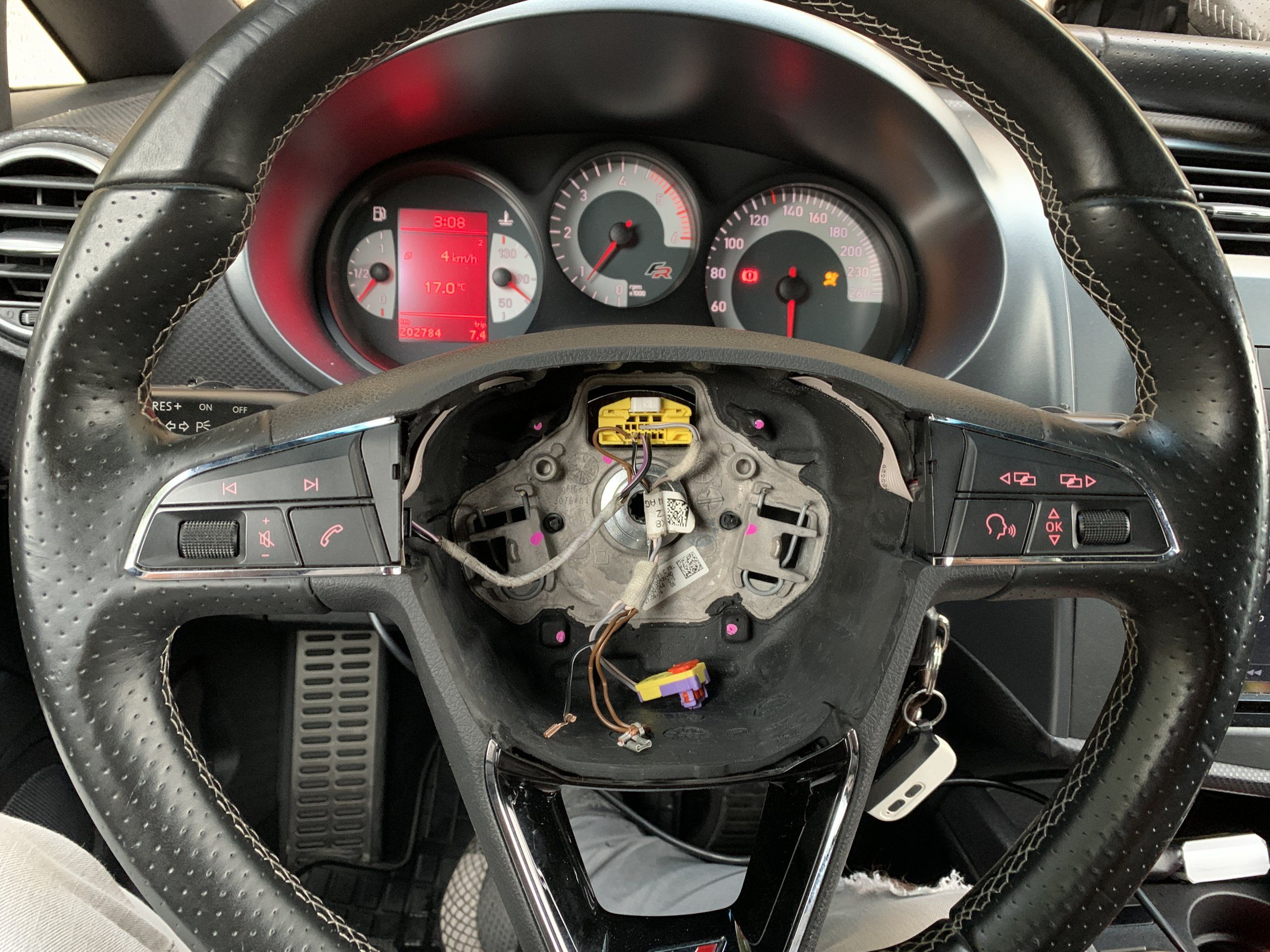

Little updates, i managed to get the buttons working, at least most of them, i have the buttons for change stations and volume working, on the right side i have only the round button working it changes only the trips, but i cannot manage to control the whole board computer. The biggest issue is the horn, still can't manage to get it working. Anybody managed to get the horn working or any ideas ? I changed the steering module to the CH version
maxko
May 26, 2015
the buttons lit up as well

Going to go against the grain here and say the Mk2 wheel looks better in the Mk2, the Mk3 doesn’t look great. Miss match for the rest of the crazy dash of the mk2

Hi, I'm the same, I use a CK instead of CH.
How did you get the buttons to light up?
The horn I saw that it must be powered by pin 8, and at least in my car it does not receive current from that pin.
