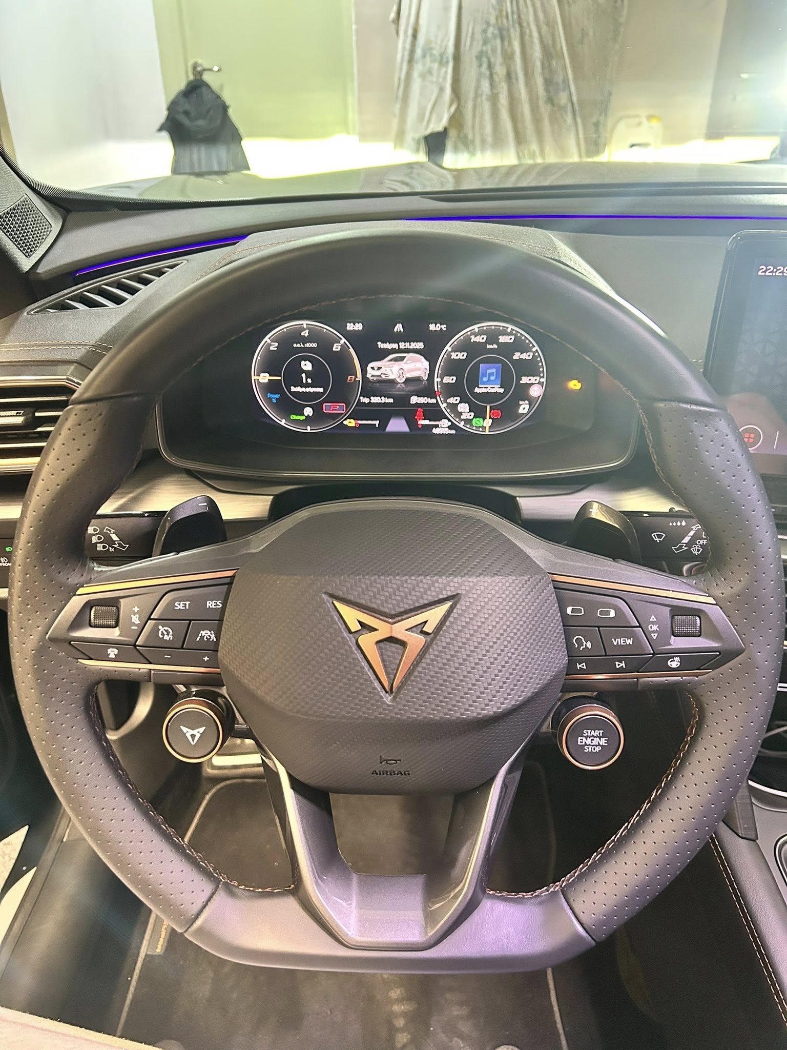

I have been browsing the forum and found several topics regarding upgrading the steering wheel, but did not really find the answer in them.
I currently have a '22 formentor, with the 'default' steering wheel (attached a photo).
It is a heated wheel with ACC. I am looking to upgrade it to the version with travel assist and the buttons for mode select and start stop.
My main question is, has anyone attempted this themselves and how difficult of a job would it be?
I am quite new but I have some technical knowledge. I understand I need to buy the steering wheel with the buttons, but in a previous post there was some mention of parts for the heating, but since I already have those for my current wheel, can I just use those?
Thanks for taking your time to read my question and for any replies! :)

You'll then need a new slip ring. It has two additional connections for the Cupra button. The driving profile selection is done via the LIN bus and must be coded in the gateway.

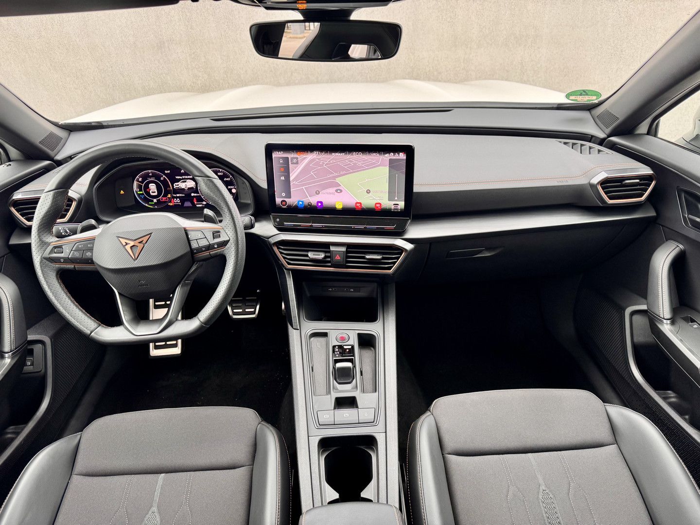

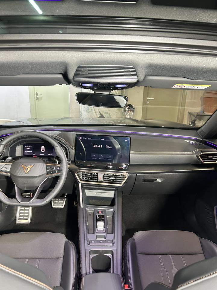

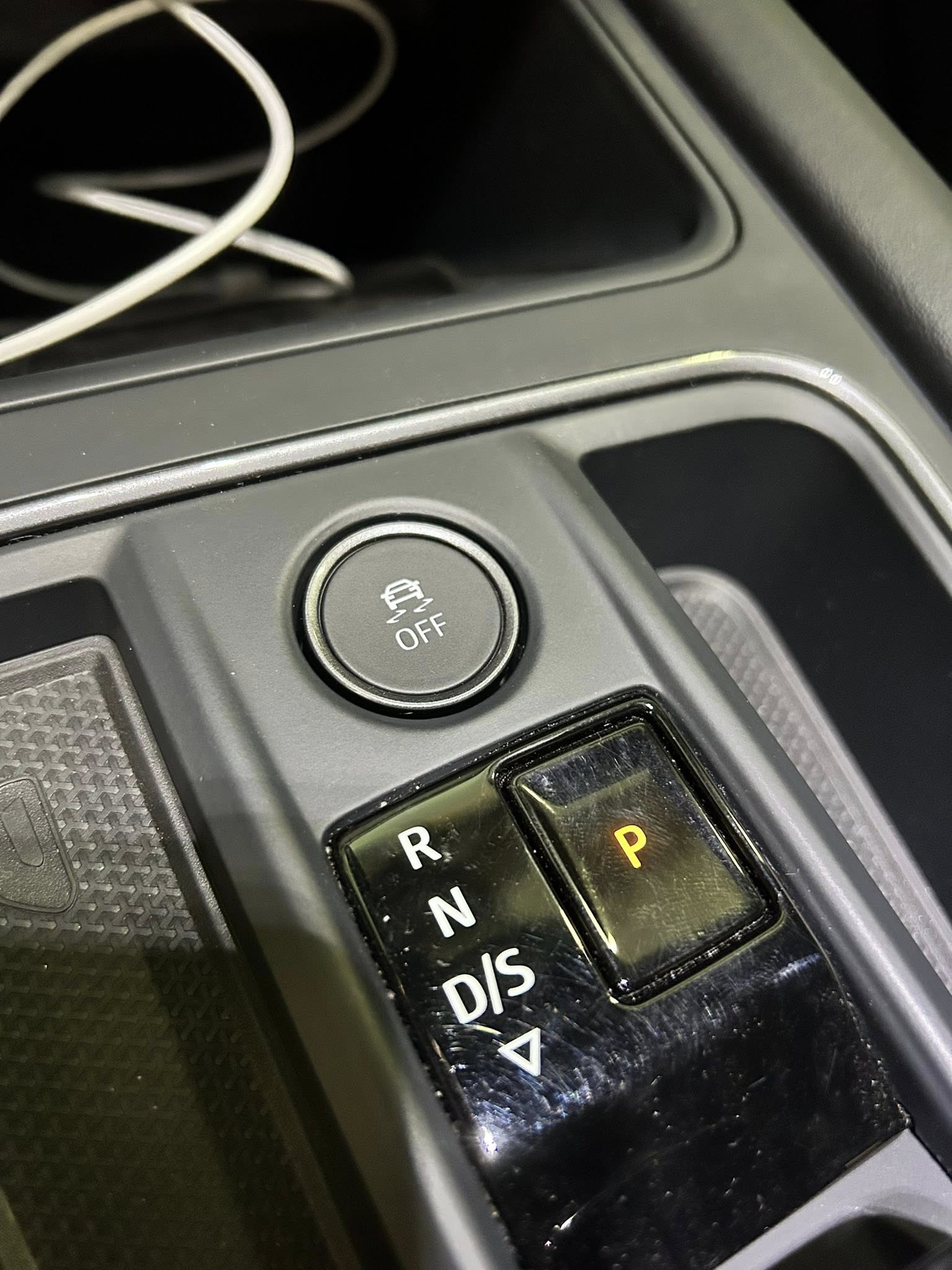

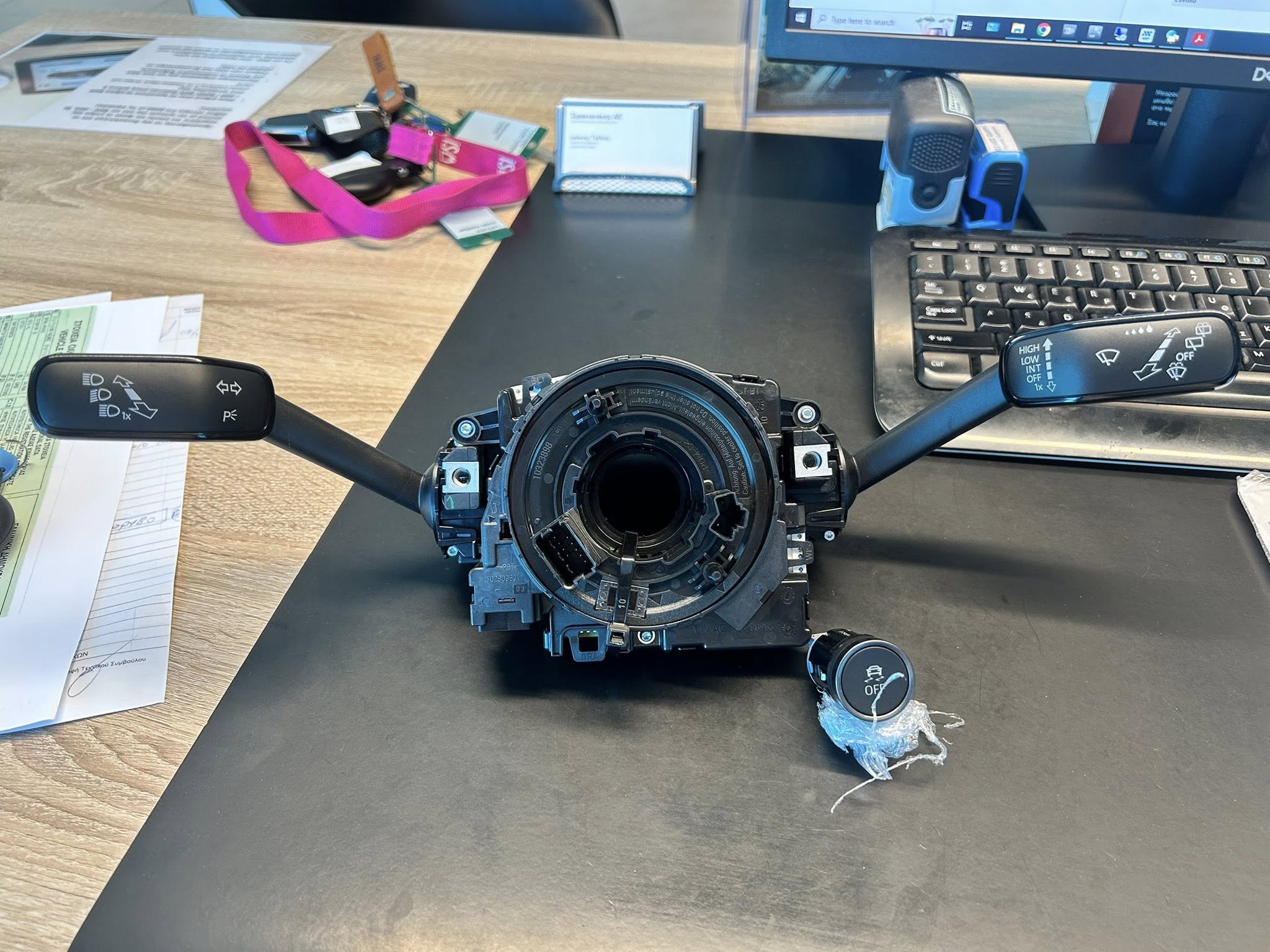

Hello ,
i have made a complete supersport steering wheel retrofit + ESP/TCS Button
I don't know any kufatec wiring .
You need a steering wheel, Slip ring or complete indicator/wiper module-leveler , new airbag or repin at the existing wiring .
I don't know any information about the repin and the wiring and the coding, i gave all the parts to a vw retrofit specialist and he made it .
Some photos from the project :
