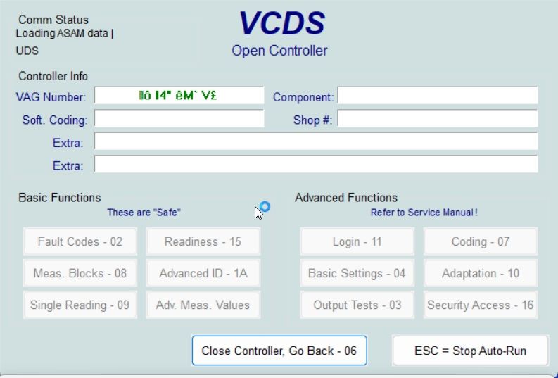

I tried a VCDS scan and it would not complete and hangs after about a minute or so, and displays this -
If I pause the scan before it crashes, I can clear the codes but they come straight back

I'm not sure about SEAT, but on other marques those codes would be indicative of either battery low voltage or ABS sensor/reluctor ring issues, or even a faulty brake light switch
