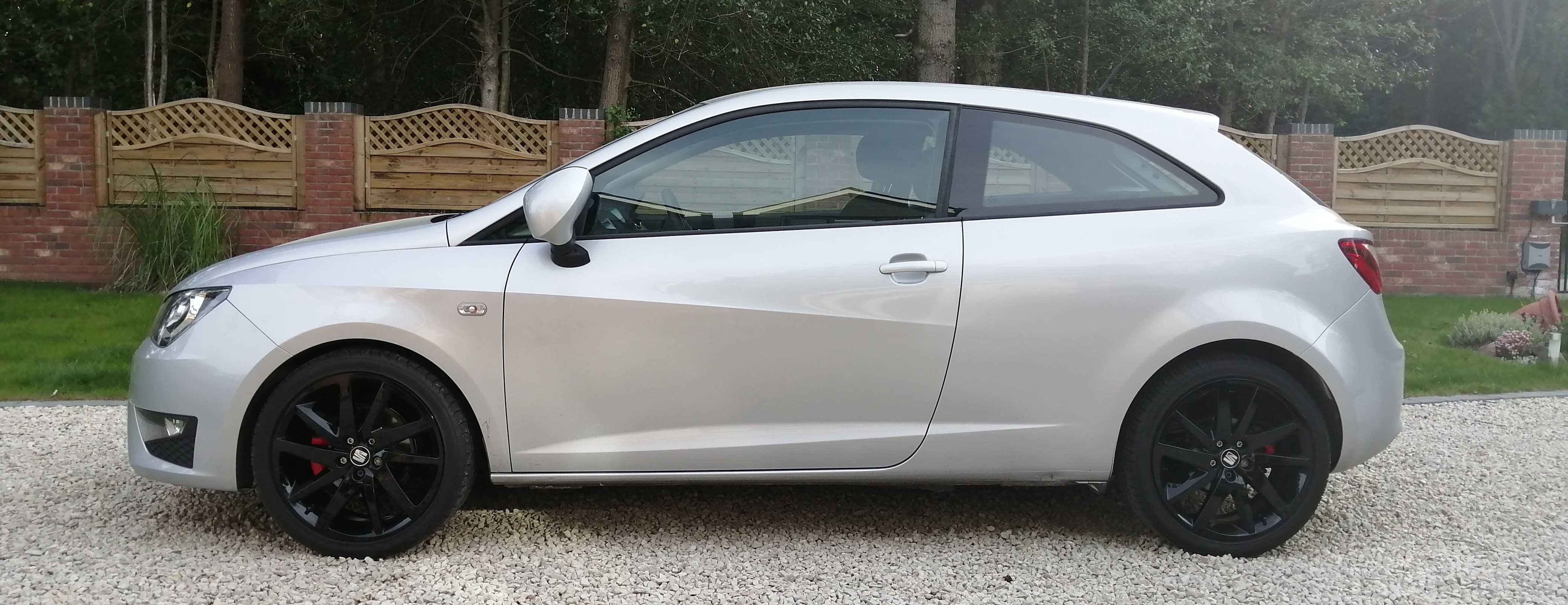

Sorry, only just seen this!
Yes I did, they look good and ride is pretty comfortable but did take a while to come tbh!
Picture to show height. This was for a 2017 1.2tsi FR. It's on 17' alloys. Don't have a before and after unfortunately!
