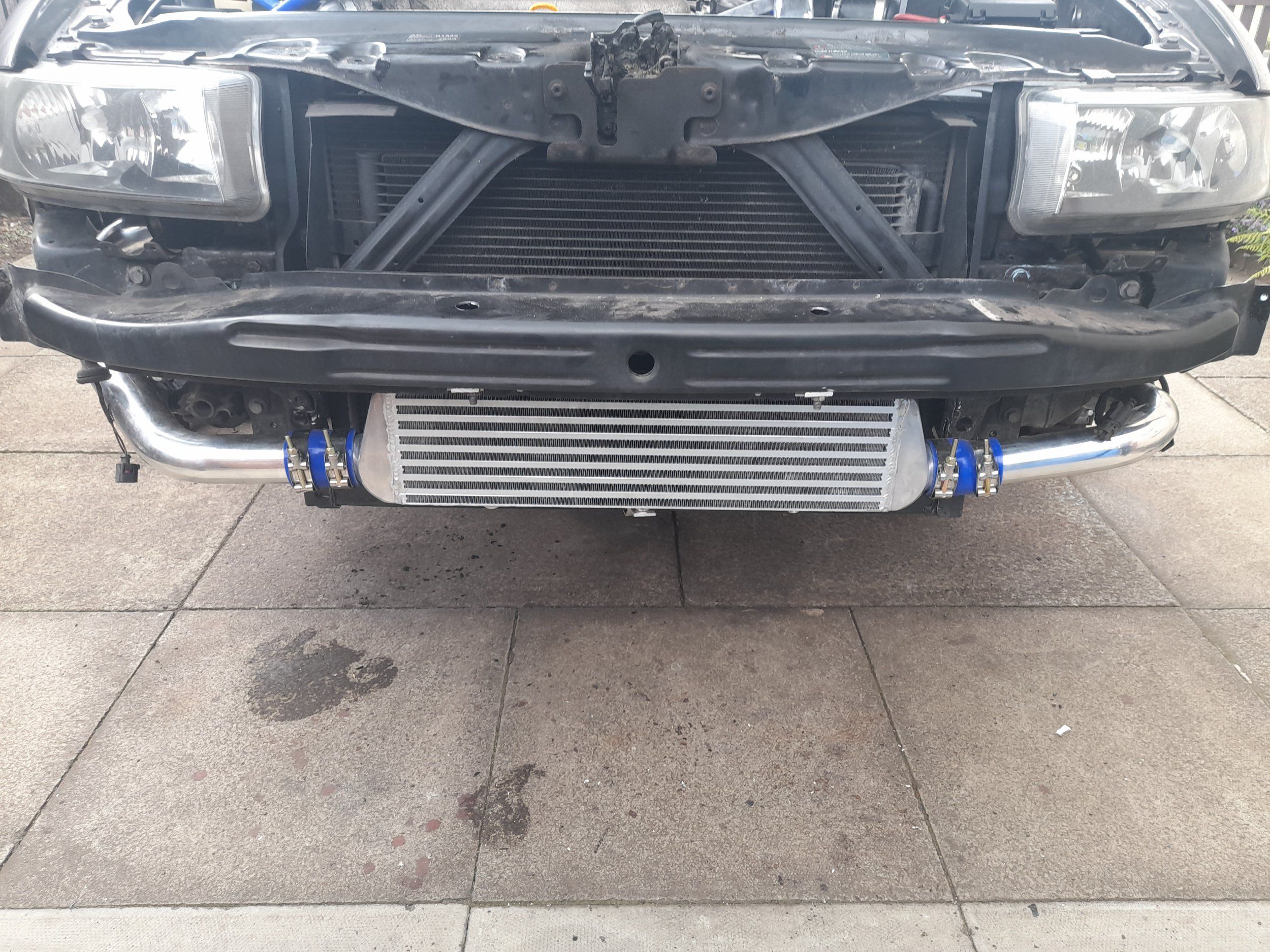

Hi guys, I've just fitted the Toyosport intercooler but the map sensor hole on the pipework is huge compared to the map sensor on the car, Ive fannied it up with washers and rubber orings right now but I'd like to get it sorted properly. I've seen some adapters but they need welded onto the pipe, my question is are there any adapters out there that just bolt onto the one on the pipe?

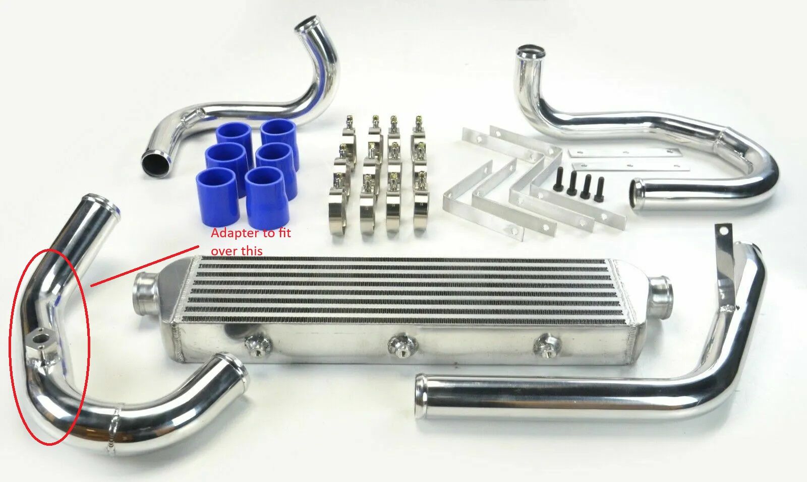

it would mean i had to cut the metal pipes to fit that in with another couple of silicone couplers. below is the pipe that came with the kit that i need an adapter to fit over to fit the standard map sensor into. the hole in the middle is way too big for the standard map to fit into.

found that there are 2 different map sensors for the car, one with a large diameter probe and another with a small diameter, the larger one fits perfectly in the hole in the toyosport kit so if anyone buys the kit and finds that their map is the small one then you can just buy the bigger one its 20 quid and the part number is 038906051, installed earlier and working fine with no codes.
