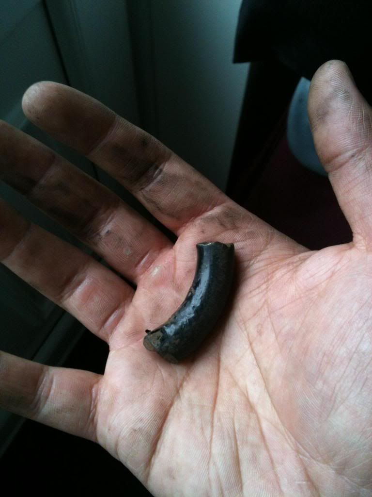

right guys found the problem got under the car properly and in the arm a piece of my rear spring was dropped in it that was making the sound! now then need advise on it do i just change the rear drivers side or change the passenger sides with it ? and how much do the springs cost? thanks
