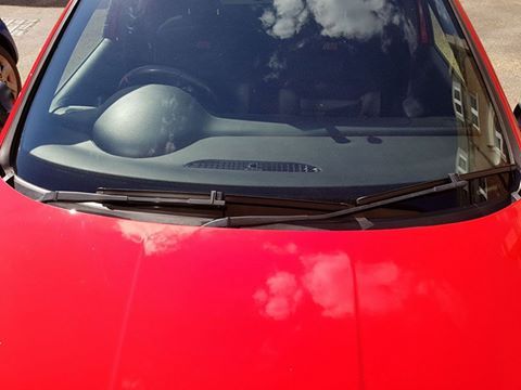

The mk 4 golf wiper blades are 21'' and 19'' and the annoying thing is, that you have to cut the passenger side wiper down to fit everytime. Well I just bought 24'' and 18'' and they fit perfectly and no cutting is required. Picture down below-
I stuck with the stock size mk4 Bosch aero blades and cut down the nearside wiper arm instead.
Looks like a stock fitment now.

I've done the exact same, although mine could do with a lick of paint:(
