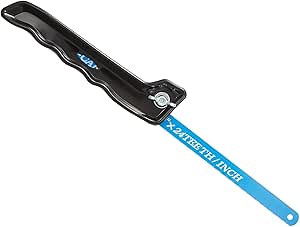

Removing the rear door is a two man job as it's way heavier than you think, but the wiring loom plug is right there and is fairly easy to remove. After removing the rear door i managed to get an open ended hacksaw blade into the gap between the drivers door and the A-pillar, and spent about 45 mins slowly hacksawing through the silver U shaped clasp that the door lock fastens to!

Yeah I had to cut both sides of it. The hacksaw blade was one that just fits in a handle rather than an actual hacksaw frame, so it was long enough to cut both sides of the 'U' at once.
