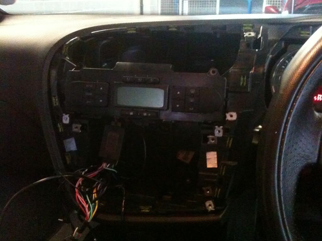

One thing to look out for is the air con unit.
There are 2 screws underneath the unit, not highlighted in the FAQ pictures.
After the radio is taken out you will be able to access/see 2 screws under the Air Con unit.
These screws also need to be taken out.
screws underneath Air Con Unit mentioned in this guide
http://www.seatcupra.net/forums/showthread.php?t=139255#8
As above, nearly broke the dash because I didn't know about those screws. Also the vents will fall out, and there a right pain to put the back correctly.
