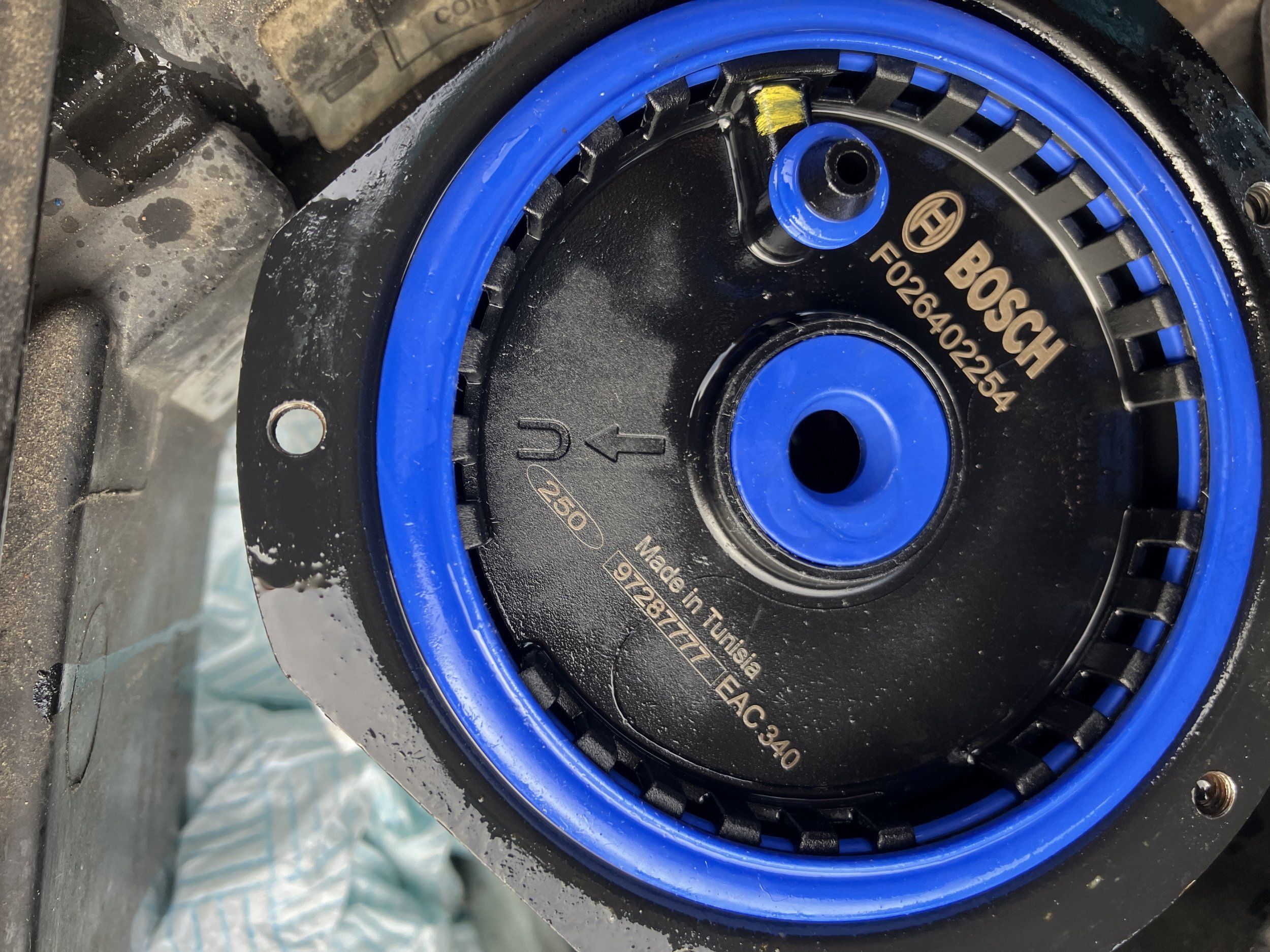

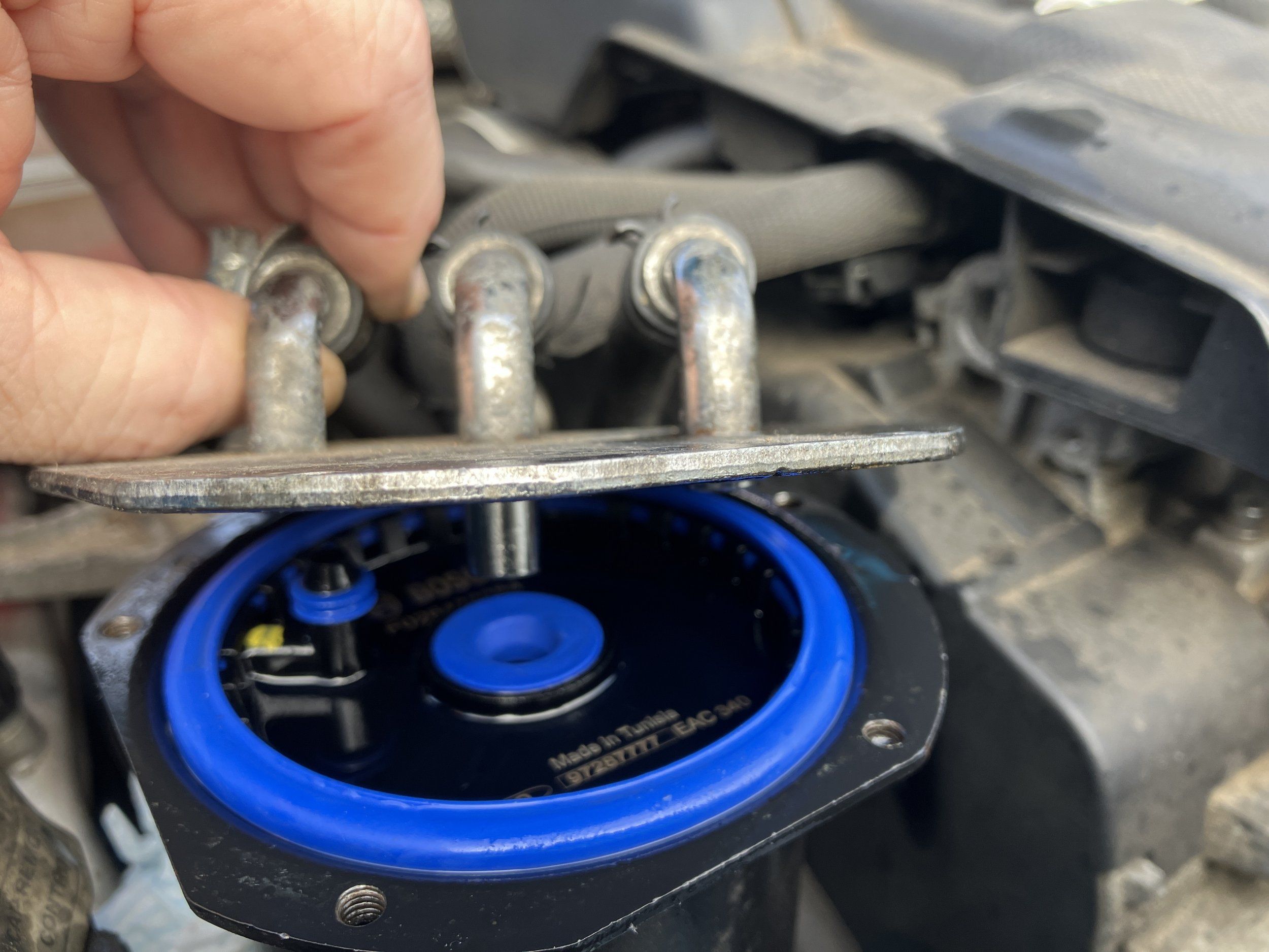

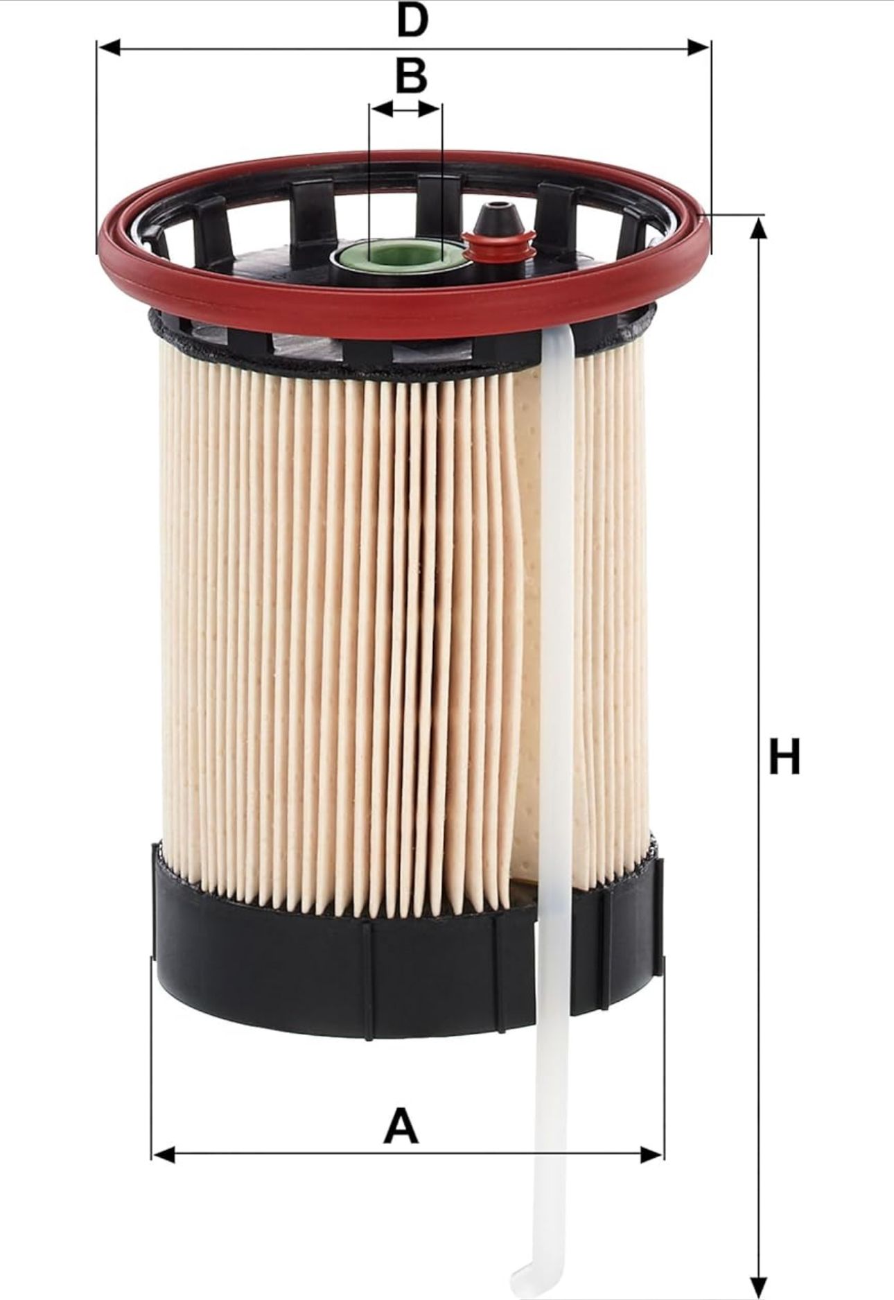

I changed the fuel filter insert on my Leon FR184 a couple of years ago. The first one that arrived being too short and it had obviously been tried before as it had oily finger prints all over it. I sent it back and got the correct one sent out.
This time I found one that had a water seperator, I checked the part number against my car registration on several websites.... all good.
I guessed the filter insert could only go in one of two positions, there's an arrow pointing to the section of the housing that has a cam shape.
Fantastic, just need to put the top back on and jobs a good un.
The centres of the fuel flow in / return / out top cover do not line up with the filter insert hole centres.
My question is; has anyone else had this problem, is this filter insert for a different region, which has a different top and finally... have I once again been a twat and tried to fit it incorrectly?

Did the one you took out have the extra outlet on the top? I've just done mine and it only have the one hole in the middle.
I put the same "standard" type fuel filter insert in as a replacement.
There was no way the water seperator one was going to fit, not without modifying it and that possibly would have opened up a can of worms that I'd rather leave unopened!
Job done, now need to monitor the fuel consumption to see if it improves.
In the UK we don't get the filter with 'water separator'. Just for markets who have crap fuel quality. PR: 1A8.
The filter element OE number for my 2015 184 is 5Q0127177
When finding parts - most aftermarket suppliers don't have enough part level detail to accurately specify the exact parts. Their registration look-up can only link parts for an 2016 Leon for example; it doesn't go down to PR code and VIN specification level - so normally give the end user a choice of several parts which fit all 2016 Leon's.
You're also reliant on the aftermarket supplier correctly linking to the OE numbers and vehicles. Believe me; this doesn't always happen.
5Q0127177C is the OE number with water trap and PR code PR:1A8 (1A8 = Fuel system for DISI engine (tropicalized))
5Q0127177 = BOSCH 1457070014
5Q0127177C = BOSCH F026402254

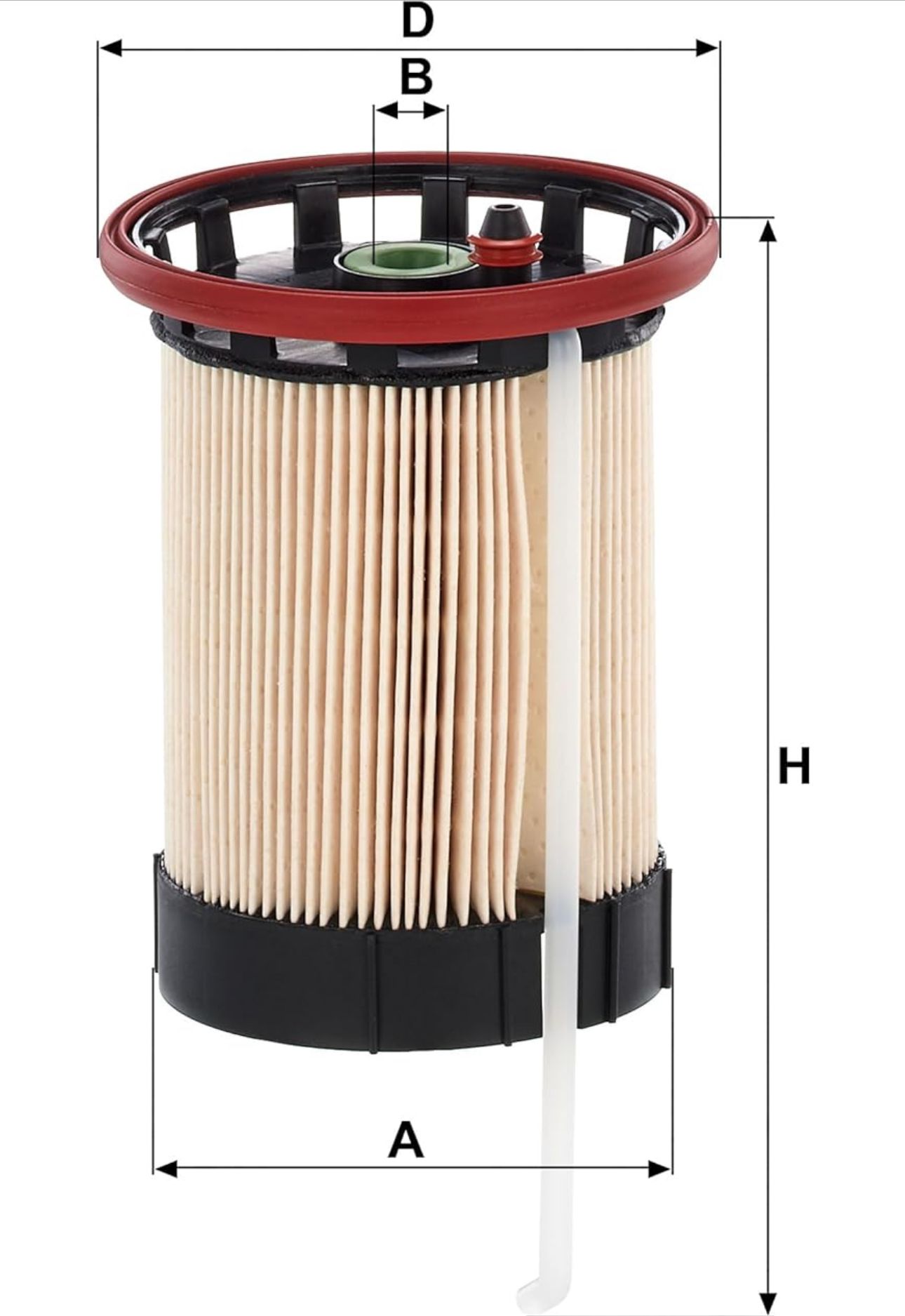

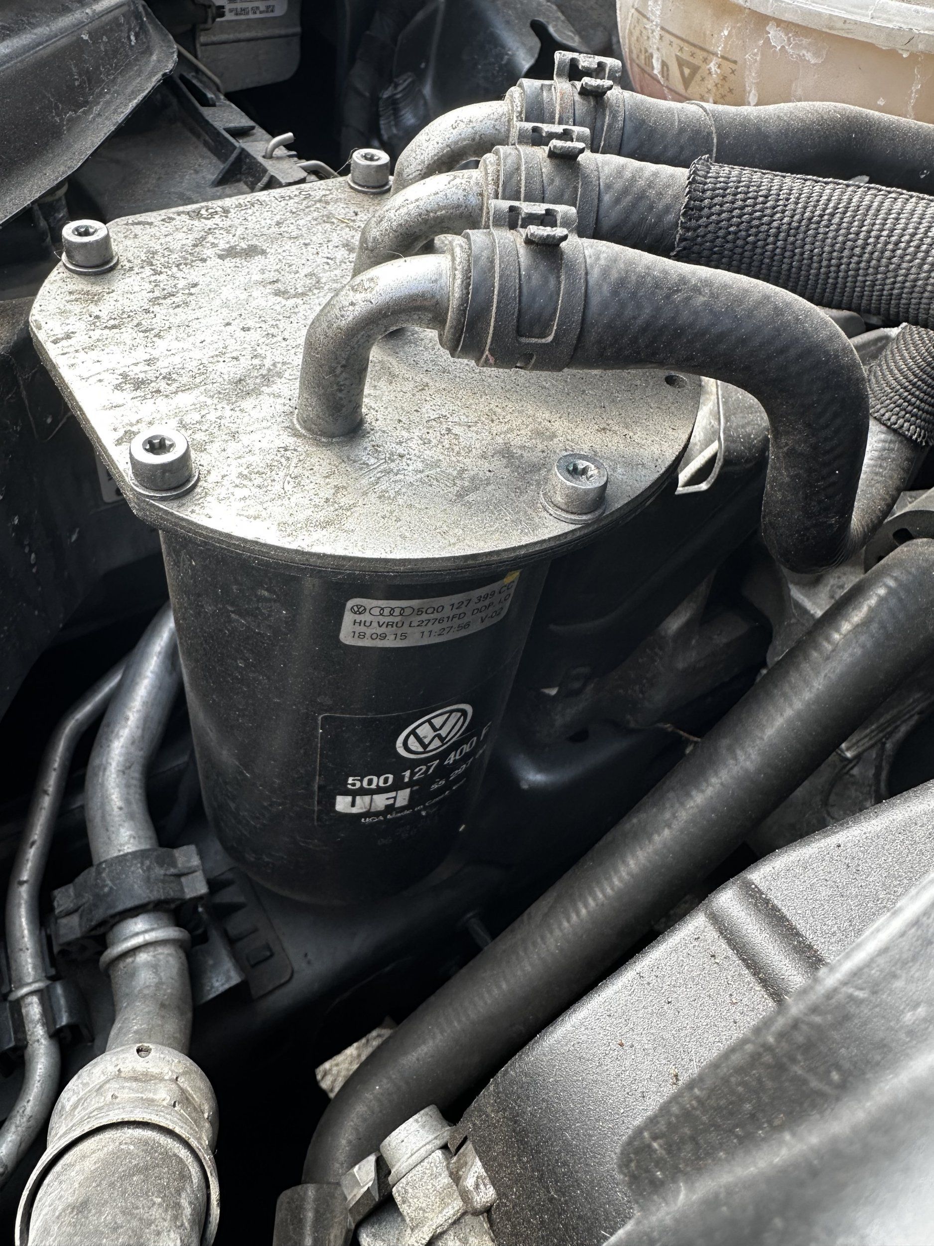

Hi, I have the same car, well 65 plate but near enough. It’s been playing up juddering and losing power. Thought I would try the cheap fix first and replace the fuel filter before sticking it in a garage, see if it makes any difference. It’s turned up today and has the same water separator on the top but it’s a MANN PU8014 (pic attached).
before I even try and replace it, do you reckon it’s worth returning it and reordering the longer one without the water separator? I can’t find any info anywhere about the one I’ve just received. Attached a pic of the housing lid too. Everywhere says it’s compatible when I put my reg in but I’m not sure.

Get the correct item. I have 65 plate 184 and the ff is not as per your picy.
Reactions: SuperV8 and LGHN-FR
View attachment 49040View attachment 49041
Get the correct part.

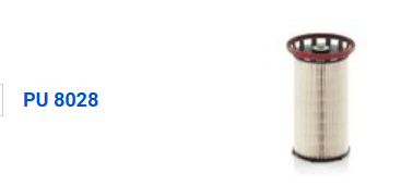

MANN PU801 is linked to the wrong OE number - 5Q0127177C. The C is important!!
You need PU 8028 if you're sticking with MANN filter which links with 5Q0127177
Reactions: LGHN-FR
Thanks! I’ve just ordered the Bosch one without the C from your previous post. Hopefully it’ll make a difference and save me those garage prices
