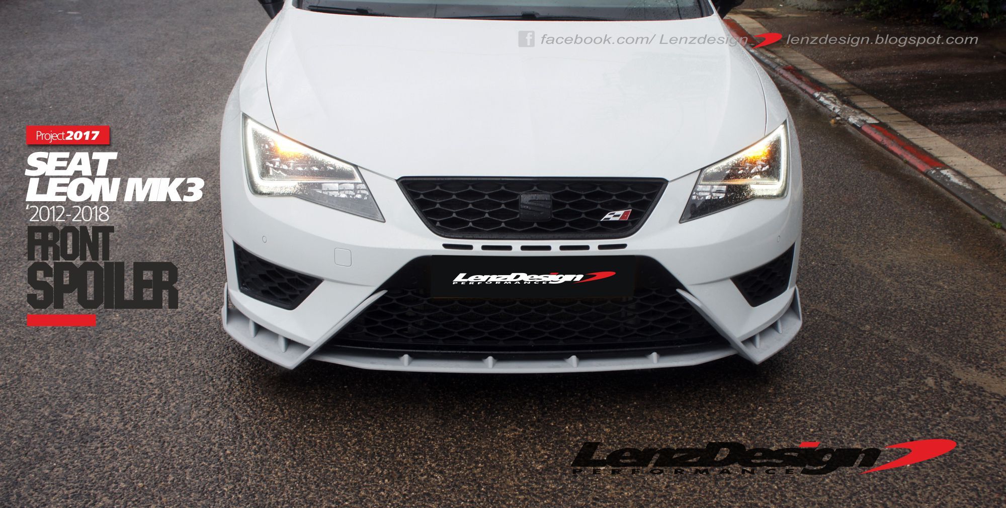

Hi does anyone know of any instruction for vag com system that would enable front indicator lights to be turned on full time
