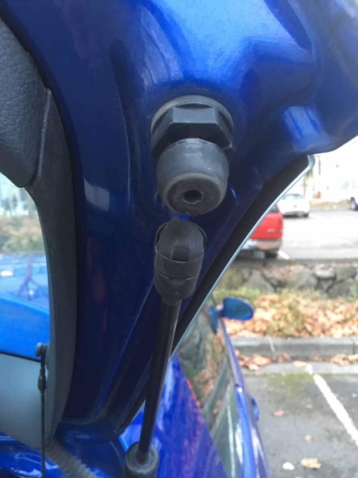

I noticed a noise from the rear of my car on my 1st drive. After trying various things I narrowed it down to the rubber hatch stops. I twisted both anticlockwise and rattle disappeared! Huge relief as I hate rattles.
Thanks, i will try it. Do you mean this type of rubber stops? Or you mean something else?
Yes. The small round rubber stop. I also, temporarily put a thin piece of material over the boot lock in case it was that. Never heard it since luckily.

I had the same issue with my car after the dealer replaced the third brake light due to an internal crack. I thought to myself they didn't put some plastics clip on properly. But after adjusting both sides rattle sound is gone. I've done an adjustment with a piece of cardboard to see how much pressure will be generated after adjustment
