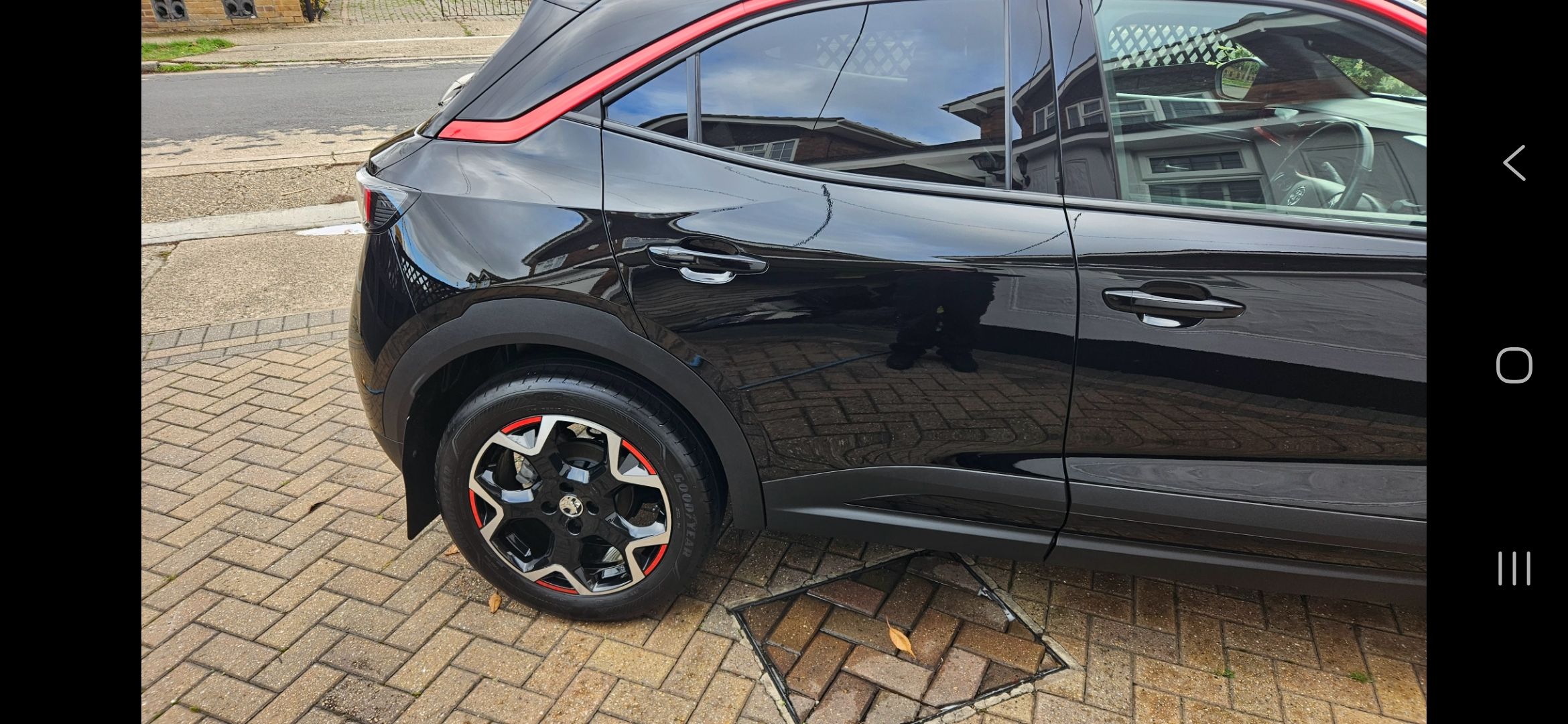

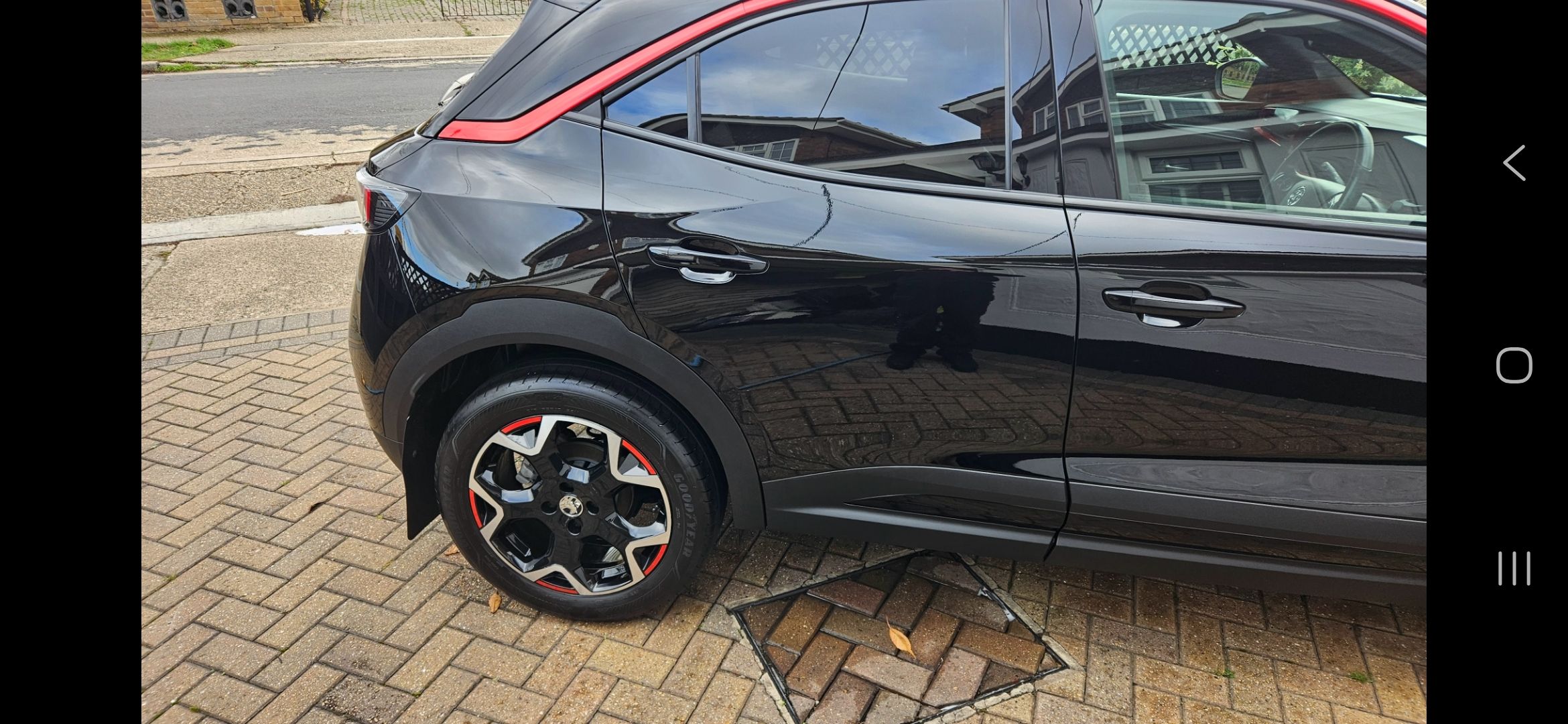

Okay thanks had these on my Mokka might be able to fit to Cupra

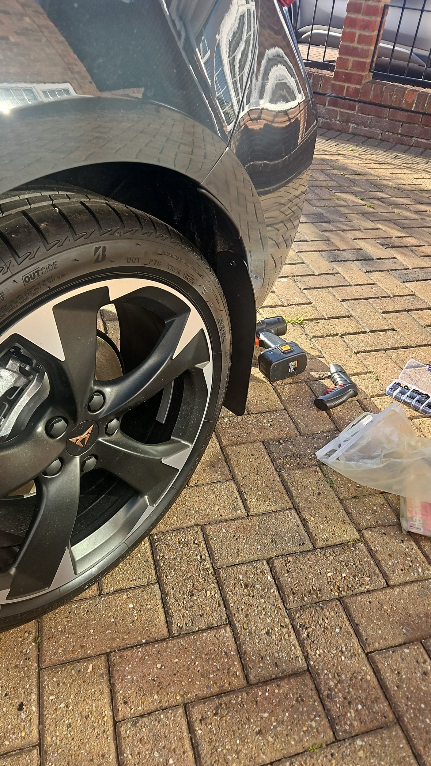

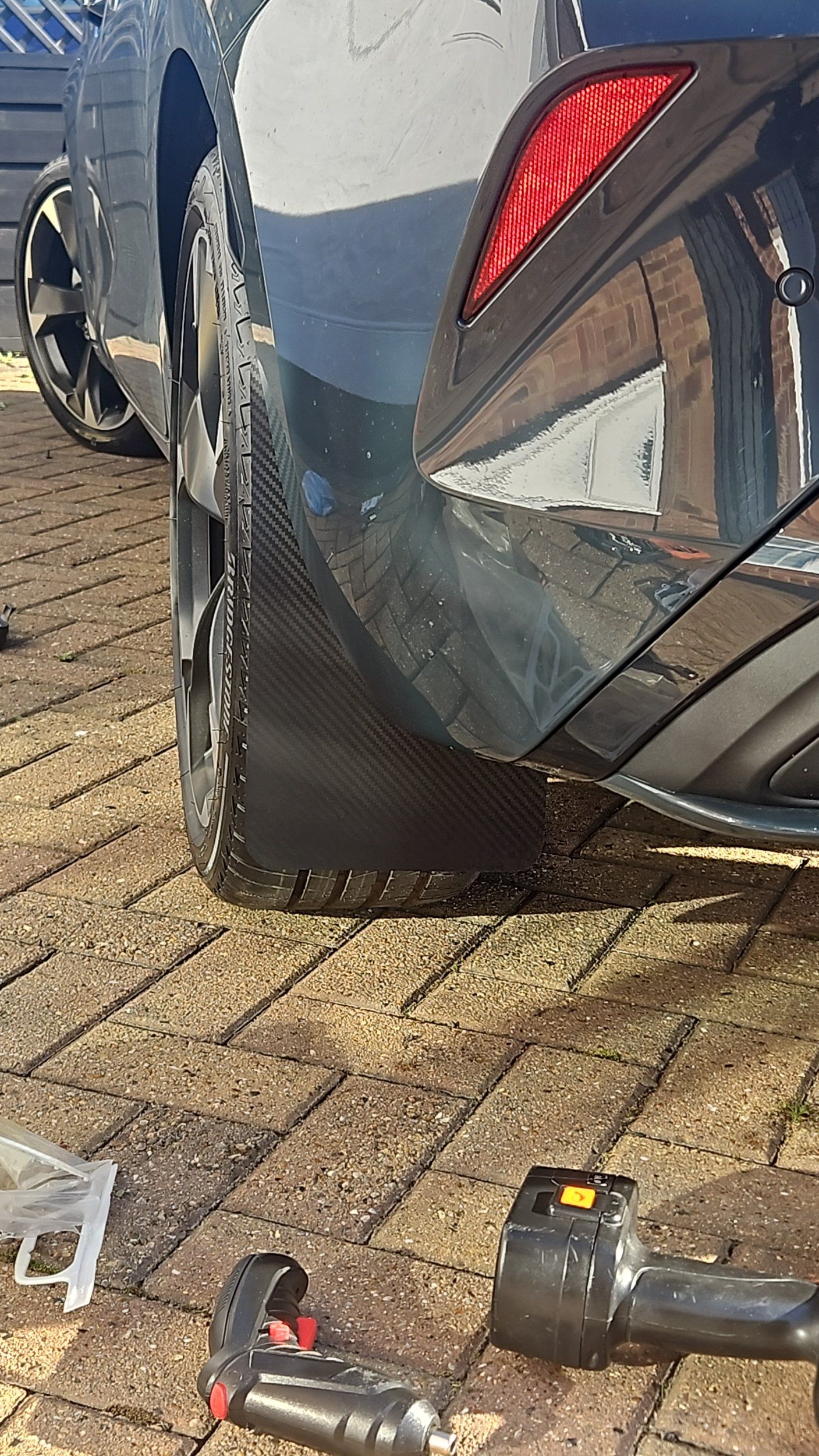

My car turned up today put these mudflaps on using wheel arch liner screws
Those look well. Are the bolts that are already in the liners long enough to reuse to fix the flaps and did you have to use some sort of spacer because the liners aren’t in line with the edge? Thanks.
Hi,

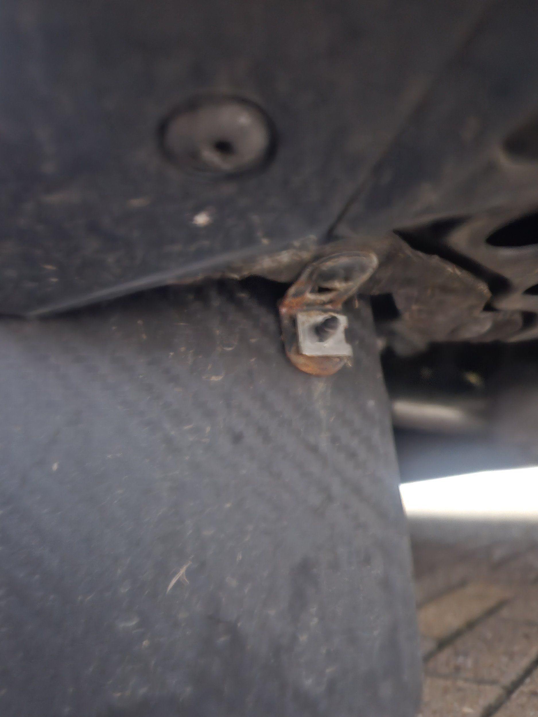

I used a couple of rubber washers for the top screw both the original liner screws are long enough and i used and l shape bracket under the bumper to keep mudflap straight on inside edge will post a picture the weekend.
