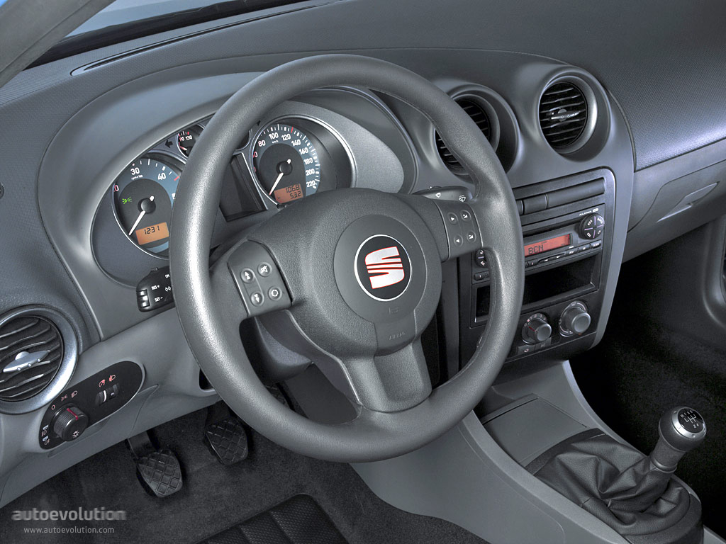

Hi everyone can any one help me
I need to upgrade my steering wheel to a multifunction steering wheel
So i need to know the wiring diagram connectors ,etc...
So plz help me
I Don't know the year of your own car, mine is 2004 and i have this problem, this is why a lot of people don't have a working one.
you need to wire between T41 connector and Alana for example or use a Linbus converter for non OEM radio.
Don't forget , i never had 2006+ model in my hand, but the old one is Lin-bus, not Canbus
