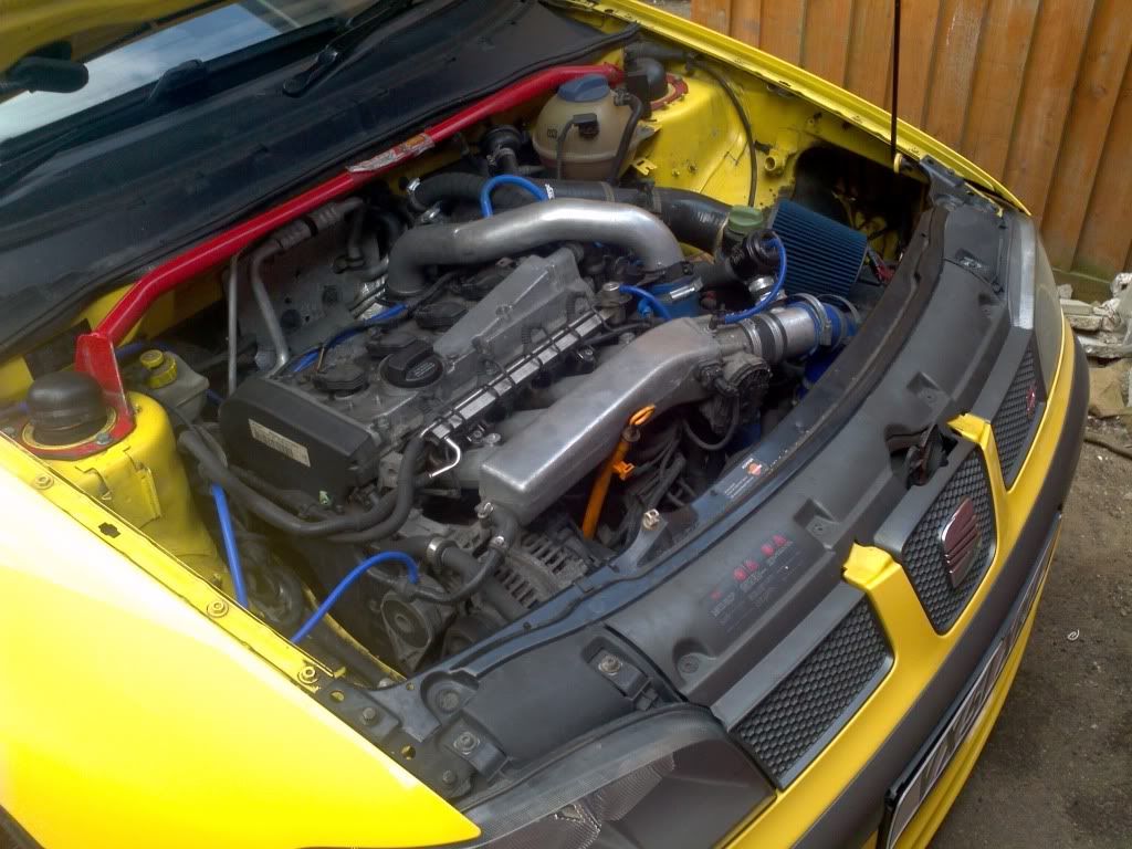

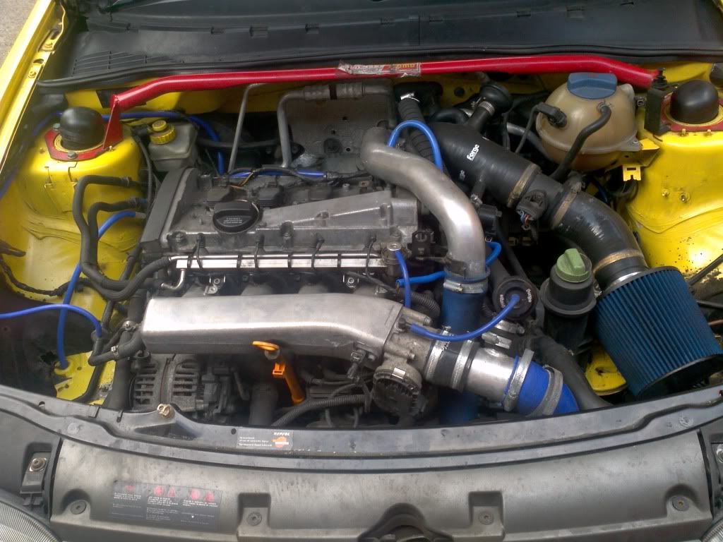

Sry to bring it back,but this maybe interesting to others....Still yellononvi-R replay here, I believed,that
Cupra R are with k03 +seat soft. Last night we test the car with my friend torque 5 PRo and shows peak boost 8.7psi or 0.6bar, wich I believe is the stock boost of 156bhp
cupra. My car is genuine
cupra R and registered 132 kw/180 bhp. There is three options:
1. I have a boost leak,although my car running very good, no woosh sound or codes. I drove with 200 bhp leon
Cupra 4x4 from 60km/h and 100km/h I kill him with a bus!!!I know he nearly 1500 kg,but I don't believe I can do that with 156bhp biza...
2. I my turbo had been changed...... I wiil try to look the number on the cold side.
So mates what is the OEM pressure
Cupra R running with these seat software ?!
I'm going k04-23 but this info will clear me, if I have some
problem,boost leak or what...Thanks...
