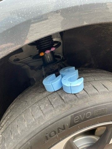

Hi, Cupra Tavascan V1 arrived last week -
Totally smitten with it apart from 1 thing and its making me not want to drive it as its so uncomfortable - The suspension is awful!
I cant help but think that something must be wrong with it? On the flat its amazingly smooth - The minute you hit the slightest mound, not even a bump the cars bouncing all over the place. Any road that is slightly uneven, its all over the place. It has a real thump that makes you cringe over the smallest speed bumps/pot hole - drove to town yesterday and felt sick by the time I got back - surely this cant be right? ( I want to go back to driving my old Audi that Ive just put up for sale!)
We watched loads of reviews of The Tavascan, not one person mentioned the suspension, if it was as bad as mine is, it would have been mentioned!
Im loving everything else about this vehicle - Any advice greatly appreciated.

There have been instances in the past with cars from some of the VAG brands of dealers forgetting to remove the transit pucks from the front suspension struts when they carry out the pre-delivery inspection. If they’re left in place in error (it was quite a common occurrence with VW’s mk7 Golf), then the ride is unacceptably harsh, firm and crashy.
Have a read of the posts at the links below. Those posts include pictures - or links to other posts - that show what the transit pucks look like and precisely where they’re located. Removing them should be straightforward if they weren't removed by the dealer.
Please update this discussion topic for the benefit of other forum members once you’ve checked to see if that is the cause of your car’s bouncy, uncomfortable ride.

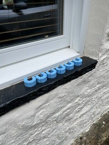

Thank you so much for your help! and the links - Very useful!
Transport Blocks were left in and thanks to your links, we new where to find them.
Im absolutely raging as this car was driven by a delivery driver from Carlisle and we stay in the Highlands of Scotland!
Going to be calling the dealer first thing - Im so relieved, been out for a drive and its super comfortable, what a difference, we knew there must be something not right!
Very glad I joined this Forum, thanks again for your quick responses, very much appreciated.

Thanks for the update. It‘s really good that the issue was something that was easily rectified but very disappointing that the transport blocks weren’t removed by the dealer. Like you, I’d also be extremely annoyed and it begs the questions;
  • what else might have been missed when your car was PDI’d?
  • what is the likelihood of there being future suspension issues (premature wear or failure of suspension components) as a result of your car being driven with the transit blocks left in? If there are any such issues, how would the dealer propose rectifying them? Would the dealer bear the cost of repairs if not covered by the warranty? (Warranty T&C’s at the link below)
I think you’re owed a big apology from the dealer and hopefully a decent selection of ‘worthwhile’ freebies.
