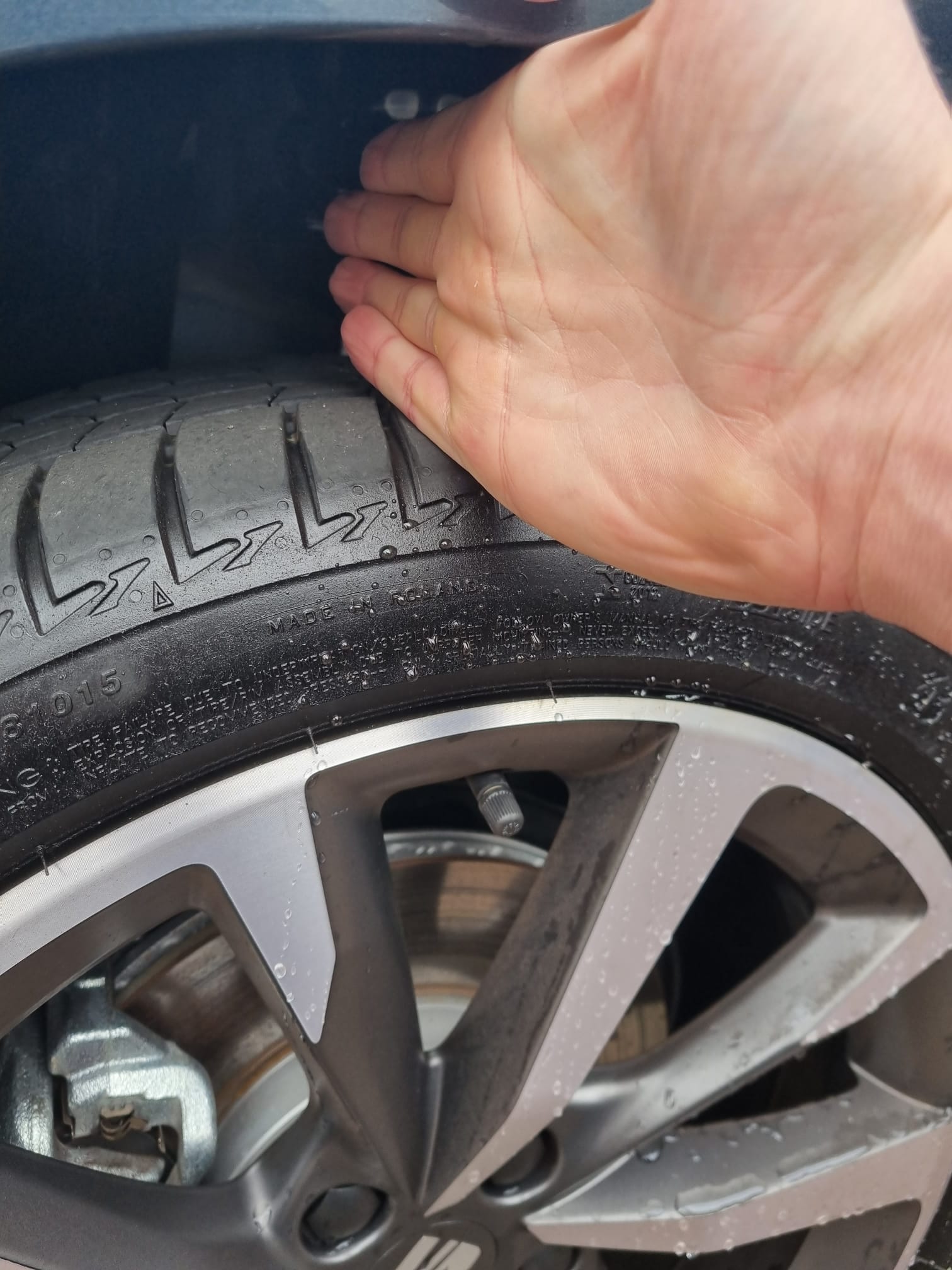

Hi all,
New member here but I've had a mk3 Leon FR ST 2019 until recently. Sold it for a very good price at Arnold Clark but bought a grey mk4 Leon FR Sport hatch back yesterday, 72 plate pre-registered with 20 miles on it.
I test drove a similar car and all was fine but noob mistake I didn't test drive the car I purchased and as soon as I left the garage it didn't feel right. The front end of the car seemed to be bouncing all over the place on the slightest bump and yet the slightest pothole was met with a violent smash. This car has the 18 inch wheels but so did my last and that was firm but ok. This new one is so bouncy. I should have gone straight back to the garage but I had the bairn in the car and my wife was already making her way north in her car.
Thing is I thought it was just the dampers needing setting but another noob mistake, I hadn't realised my new car didn't have active dampers unlike the last car. Got it home (40 miles later) and then realised I'd f'd up. Furthermore, the car seems to be sitting really high at the front compared to the back. Is this normal? I thought it was meant to have lowered suspension.
Honestly, it's got me sick with worry thinking I've bought a lemon despite a warranty.

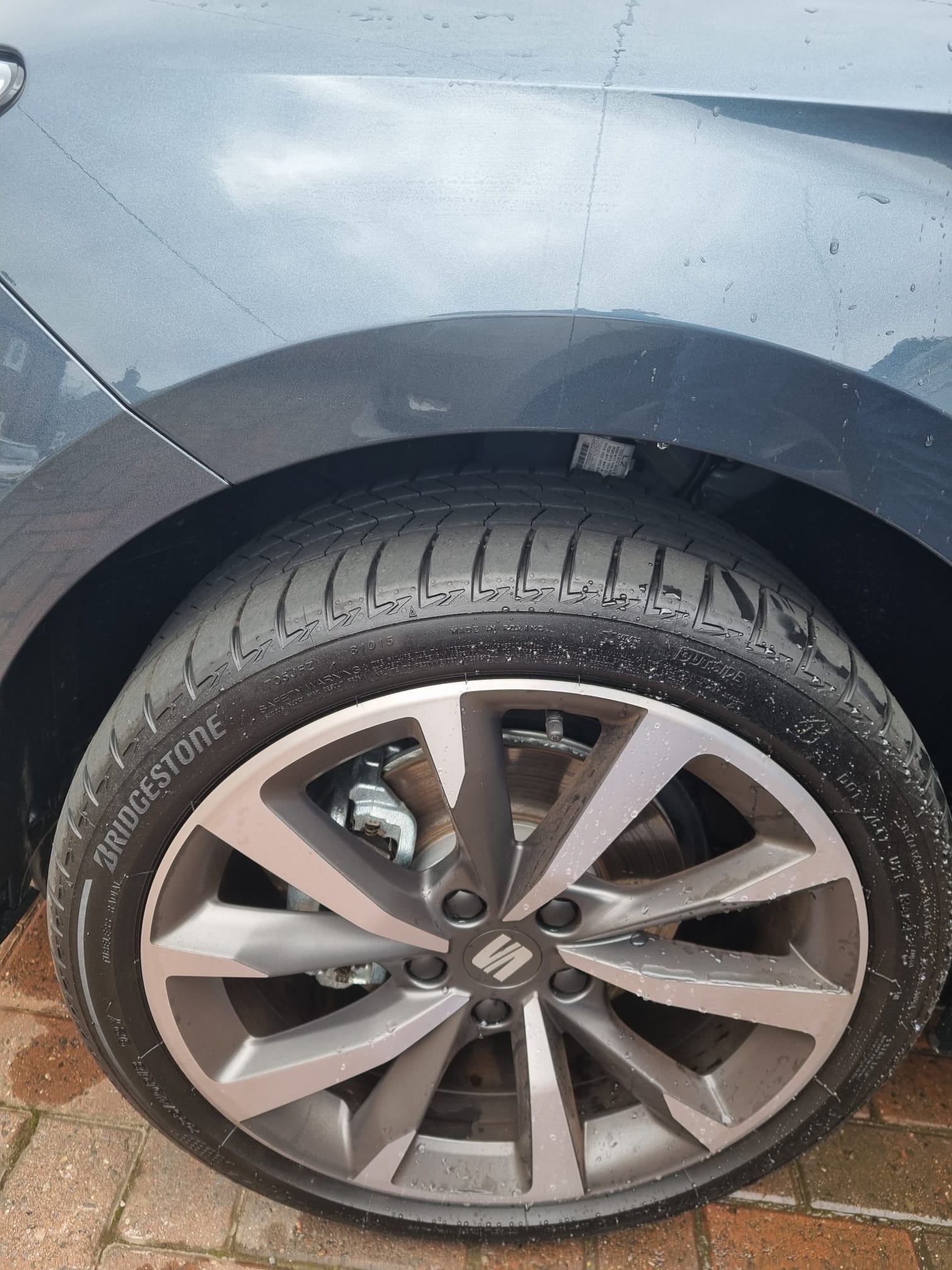

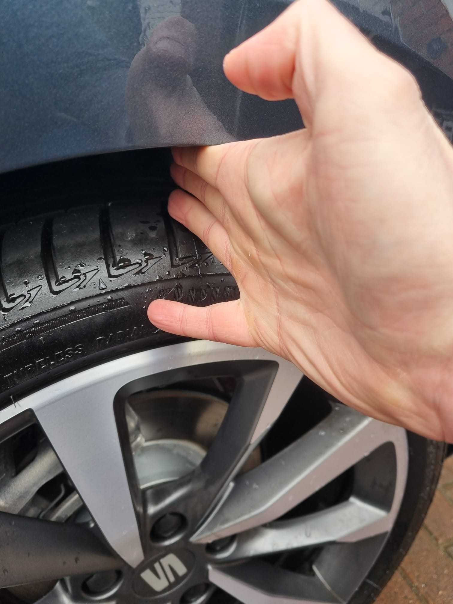

I've attached some pics with the gaps in the arches, the bigger gaps being the front, which look ridiculous being able to see all of the top of the tyre. It's not just the way the car is sitting on the drive, because it looks the same if not worse on the flat.
Can anyone advise please? Is this normal? Is it just because the car is new and needs to settle in?

Sounds like the dealer hasn’t removed the transit pucks from the front suspension struts when the car was PDI’d. This was quite a common omission by dealers on the mk7 Golf when it was first launched - tell tale signs were rock hard, crashy suspension and raised ride height at the front. I’m assuming the Leon has a similar front suspension set up to the Golf and also has these pucks installed for the transit journey from the factory to the dealers.
Worth checking out the discussion thread at the link below. There are pictures of the offending transit pucks in replies #30 and #32 (they aren’t always pink in colour). You should be able to check if they’re still in place on your car (they’re only used on the front suspension).
If your issue is down to these pucks being left in place, then IMHO it’s unforgivable as VAG have been using this particular type of transit puck since at least since the time of the mk7 Golf launch; so for around 11 years now. Therefore, dealers should be well aware of their use, their location and the need to remove them.
Edit; meant to say that there may be more than one puck on each front suspension strut, so if this is your issue, make sure you’ve removed them all. I’d also make a point of reporting this to the dealer in case any damage has been caused to the suspension as a result of the dealer not removing them.

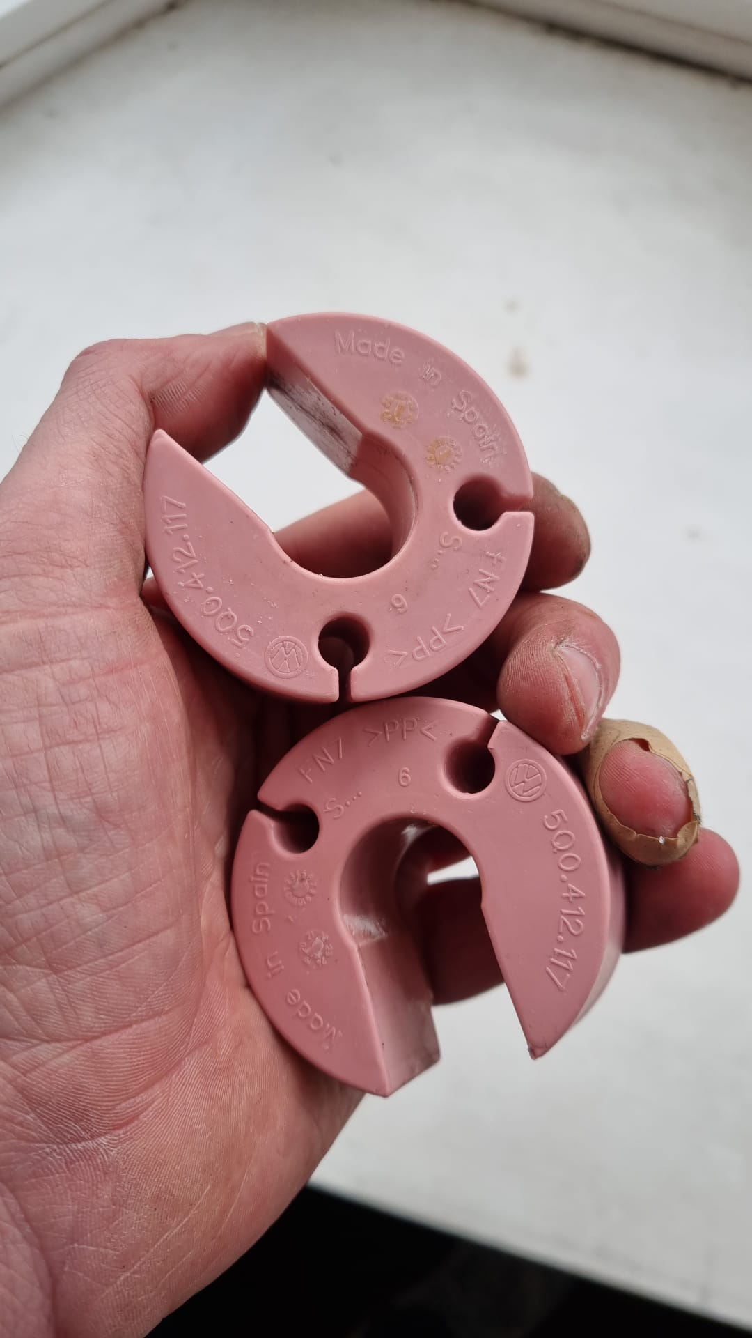

Mate, you sir are an absolute legend! Thank you so much for taking the time to reply and dig out that link.
I was sceptical, it couldn't be that simple surely... jacked it up, sure enough those two pesky things in there! Took both out, went for a drive and the car is a different car altogether!!
No more bouncing about and it's a bit less harsh on the potholes now (I always to try avoid them but sometimes it's hard to).
I honestly can't thank you enough! Barely slept last night worrying about this. I'll sleep tonight I tell ye!
Much appreciated!

And after reading the full thread you posted, I decided to investigate further and there was another two on each side!!!
No wonder it was so bad.
All 6 removed now and honestly the car drives like a dream!

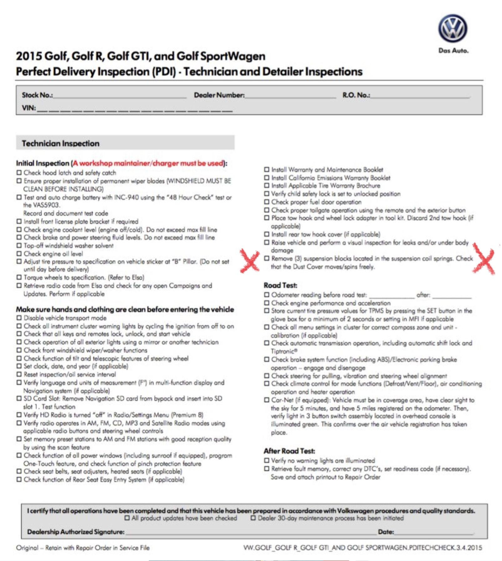

@chembers - I’d be very interested to see the PDI checklist that should have been completed by the technician who undertook the PDI on your car.
I found a copy of a VW PDI checklist - see below. Admittedly, it’s an USA PDI checklist that was posted on vwvortex.com forum, but irrespective of it being a VW USA document, I’d assume that the content is pretty much generic across all VAG brands in all countries. The list includes a specific item for removing the suspension blocks in the suspension coil springs.
As VAG have gone digital for servicing records, there may not be a physical hard copy of the PDI checklist for your car. However, whether digital or hard copy, the dealership should have retained the copy of the completed PDI checklist in their records for your car that you could ask to see. If the checklist shows the suspension pucks were removed, then you could ask them to explain why it was necessary for you to remove them; it would also suggest the dealer does just treat completion of the PDI checklist as a tick box exercise and if so, as others have said, it does make you wonder what else they may have missed / not checked or actioned that’s on the list ?.
Here’s the VW USA PDI document;

@SRGTD thanks for that! There's actually a lot to check then, it does make me wonder what else they have missed.
