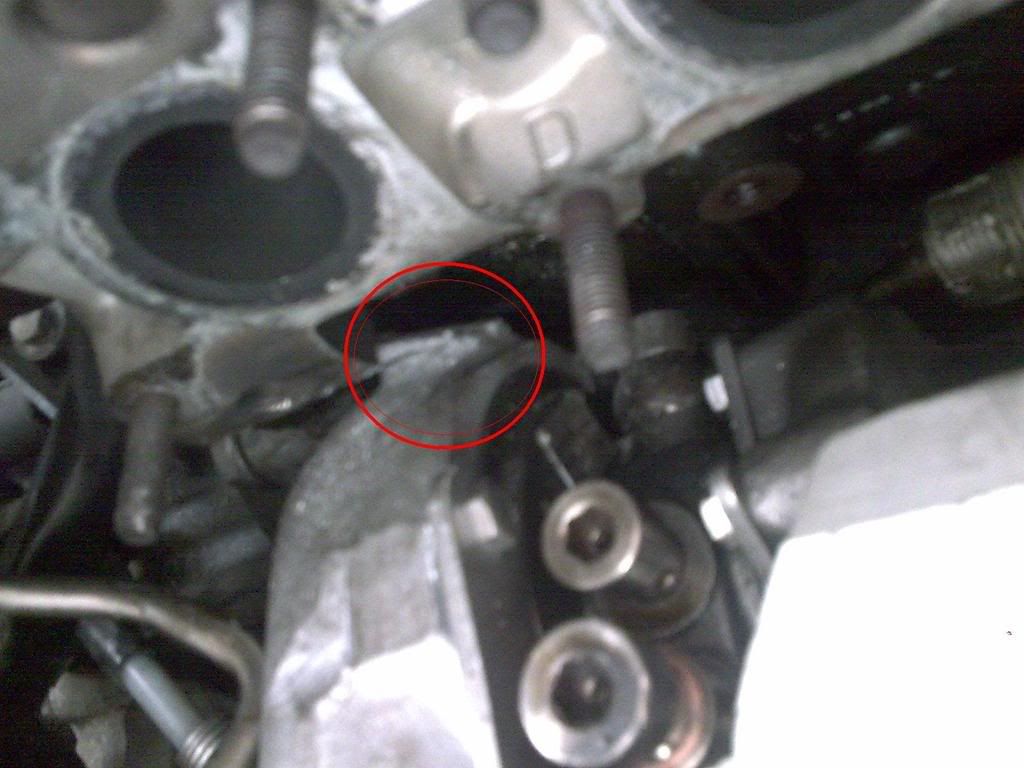

But what i nightmare we've ( Jim and Me ) had, was easy to take the existing mani and turbo off, then came the annoying bit! :censored: should off put out a swear box! lol. first off we had grind the turbo housing as there was an extra fitting point then had to grind a bit off the ATP mani to make a flush fit, we started to bolt the turbo in-fixed braket, 1 oil line and 1 water line then we hit a problem.....there was an extra fixing point on the turbo housing that was stoping us to fit the top oil line :cry: sooo....turbo back out again, then once it was all sorted we fitted the turbo back in and fixed all the lines. yey getting somewhere. next was the mani ( im an idiot as i read on here to do something before you bolt the mani to the head ...put the bolt in the mani else you wont get it in when fixed ) D'oh... :doh: so after mauling our arses off getting all bolts screwed on the mani we had take them back off again [:@]

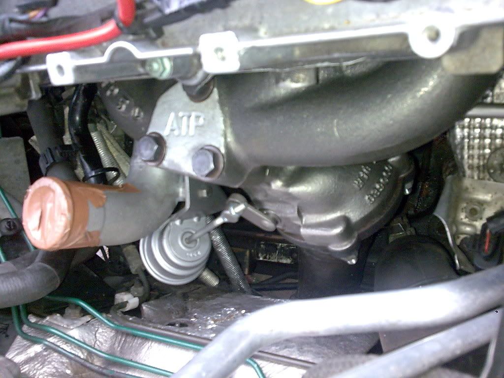

here's the turbo........

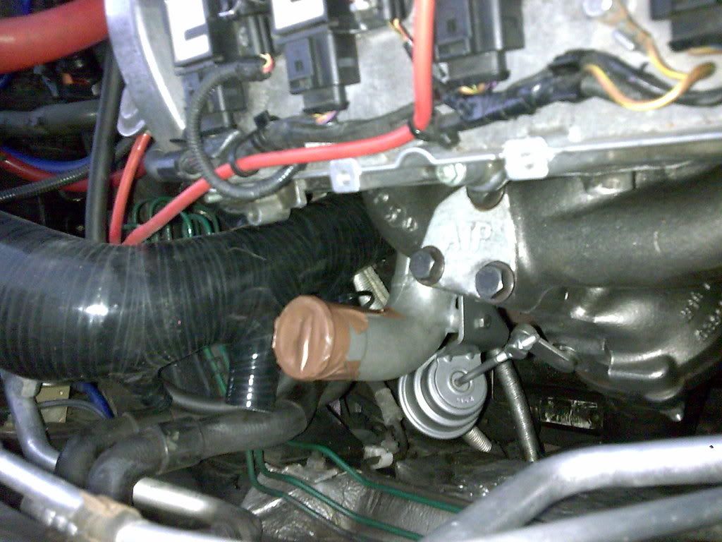

Turbo installed with mani
some problems we hit.... the extra fixing point that wouldnt allow the turbo to fit right ( tried to hackenschmitten it off but decided to take it back out and get the grinder on it )
The 2 point we ended up grinding off...
