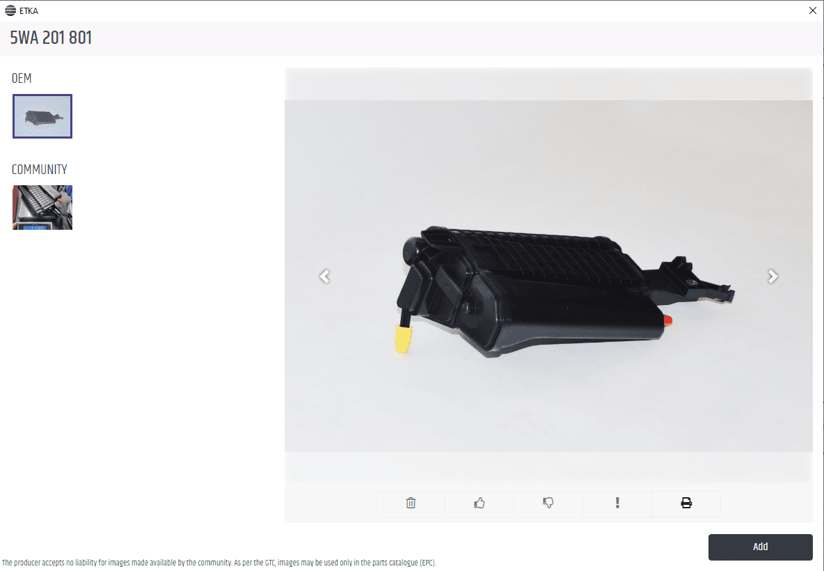

Hi, yep got it sorted.
Essentially needed to order an activated charcoal container. Cost around 150 pounds.
I fitted it myself, but there’s no real videos online to show you. My seat model I knew it was located behind the rear driver side wheel. I took the wheel off and the inner lining of the wheel slot and voila, it was sitting in there. Once you’re in there, it’s super easy to replace, the majority of the work is just getting into that area. I replaced it and put everything back together and a few power cycles of the engine and the error code was gone and it was fixed.
I’ve attached a picture of what I got, so just buy one and you’re sorted. Hope this helps
