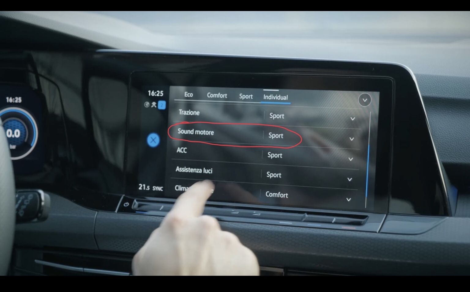

Hi and thank you. I do not have any settings regarding sound in the drive profiles. As far as I know I do not have soundaktor because mine is not the 310 cv 4motion, I have actually a golf gti!!!

So this is my question: why golf 8 gti (which shares all the drivetrain) has got an engine sound setting? What is missing in the Formentor and in the Leon too?

Well, technically speaking, what’s missing is the Soundaktor module under the windscreen.
If you’re wondering why it’s not on certain models you’d need to ask cupra directly as they make the decisions. Perhaps because it’s a lower down brand than the VW overlords?
