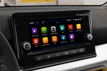

I have a 2021/22 Seat Leon ST (KL) with the smaller infotainment system.
I wanted to have full-link which as far as I know could be bought via the shop application.
Probably the infotainmnet system needs an update?
I would do that via USB but I am not sure which update files I need to install. I have the 1969 downloaded (not yet installed), but maybe there is a need to update in a chain.
Do you have experience? Can I directly install the latest or what is the proper chain?
Additional Info: I have Seat ID activated and I am set and logged in with that as active primary user.

Your system is MEN3, not MOI3 so every update you've listed there is incorrect, you've also attempted to use updates from two different projects (SE38x & SE326). Your car is SE38x
It sounds like you've prepared the USB incorrectly, MEN3 requires the meta and info folders to be inside a container folder named with the full name of the update (for example "MEN3_EU_SE38X_P3295L_MU1805").
We're legally unable to distribute software update files so my advice would be to visit your local dealer/specialist
