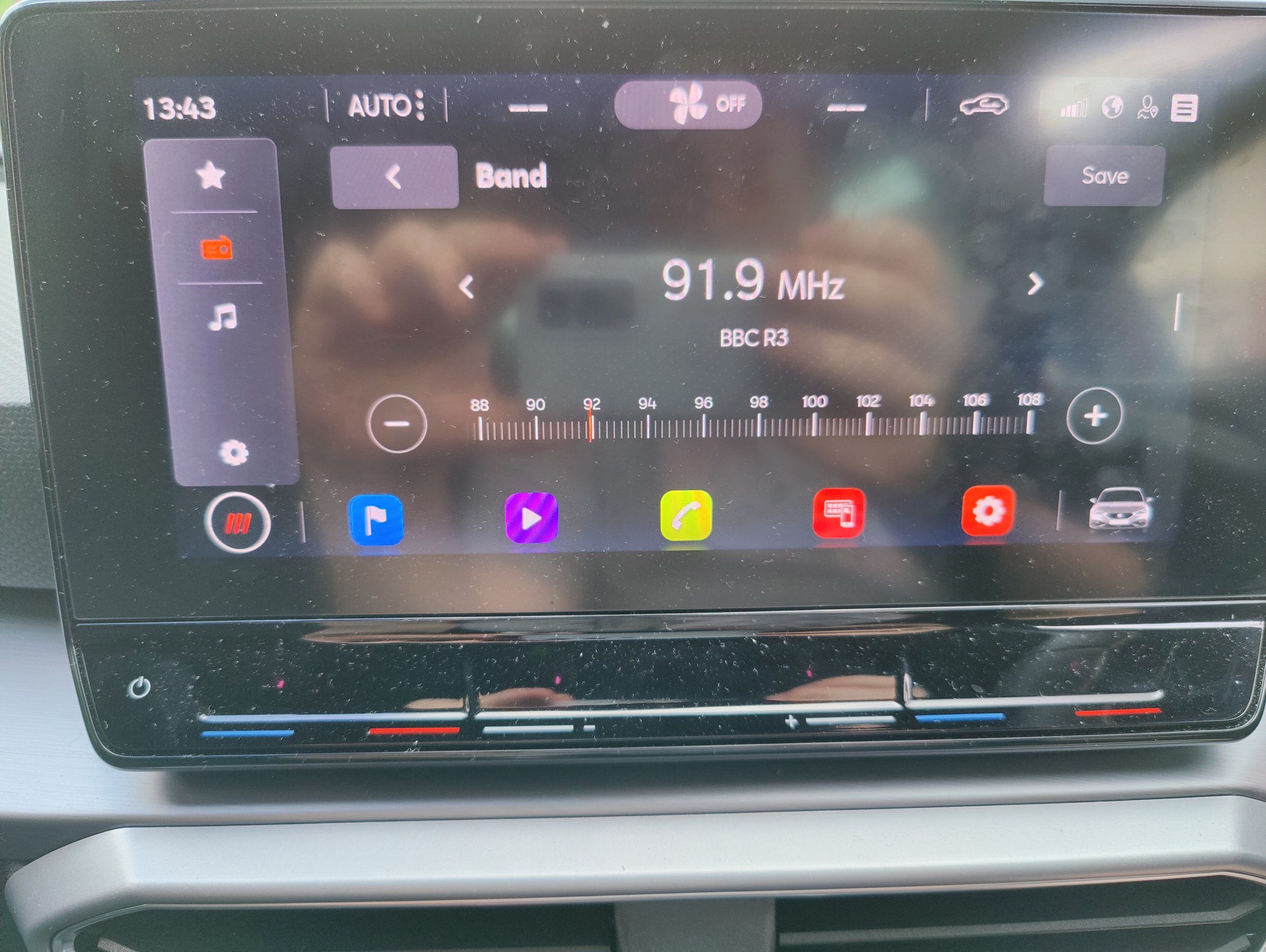

in UK , when u do scanning for the FM radio frequencies, do you get the station name ???? or it's just a frequency ?
You can only search for frequencies if your in FM mode, not FM/DAB mode (but the setting doesn't persist)
But scanning (forward/back arrows in picture) always goes to a station with a name.
If you get good reception on a station it shows the name and the logo, I'm not sure if it's doing it by frequency or name
I went to 2 different frequencies for radio 3 both times it got the name and logo, but only one had radio text

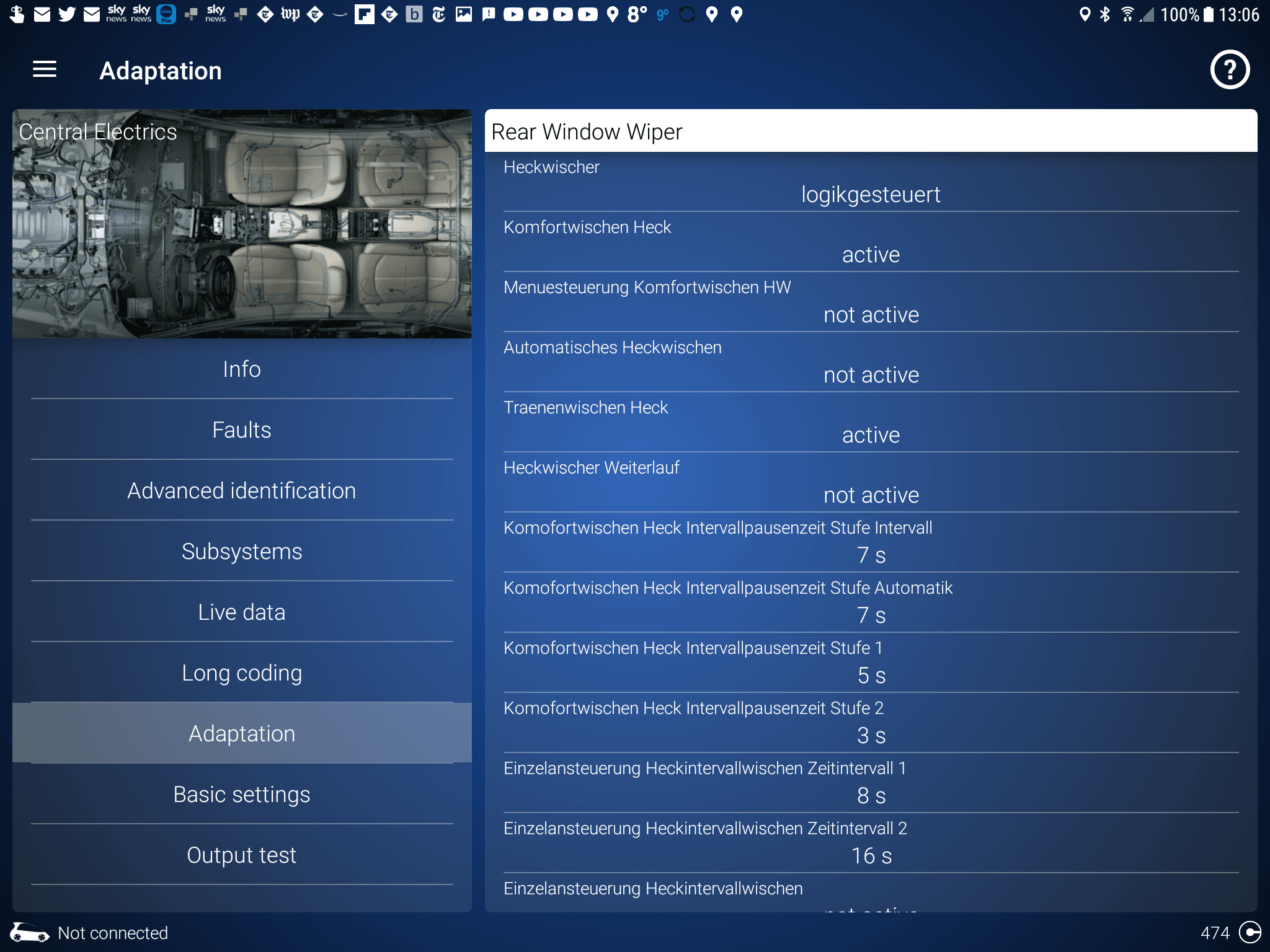

I am looking into it, it is one of the settings under the wiper section but haven't found it yet.
Not this ?
Suspect it's the comfort wipe ?.
The Golf 7 has the text
Rear Wiper Adjustment on Car Menu
Select Control unit 09 (Central Electrics)
Security access
Access code 31347
Adaptation
(2) Select Rear wiper-menu control Comfort Wipe HW
Value=Not Active
Reckon in Obdeleven it's in German.... I could be barking up the wrong tree thou.

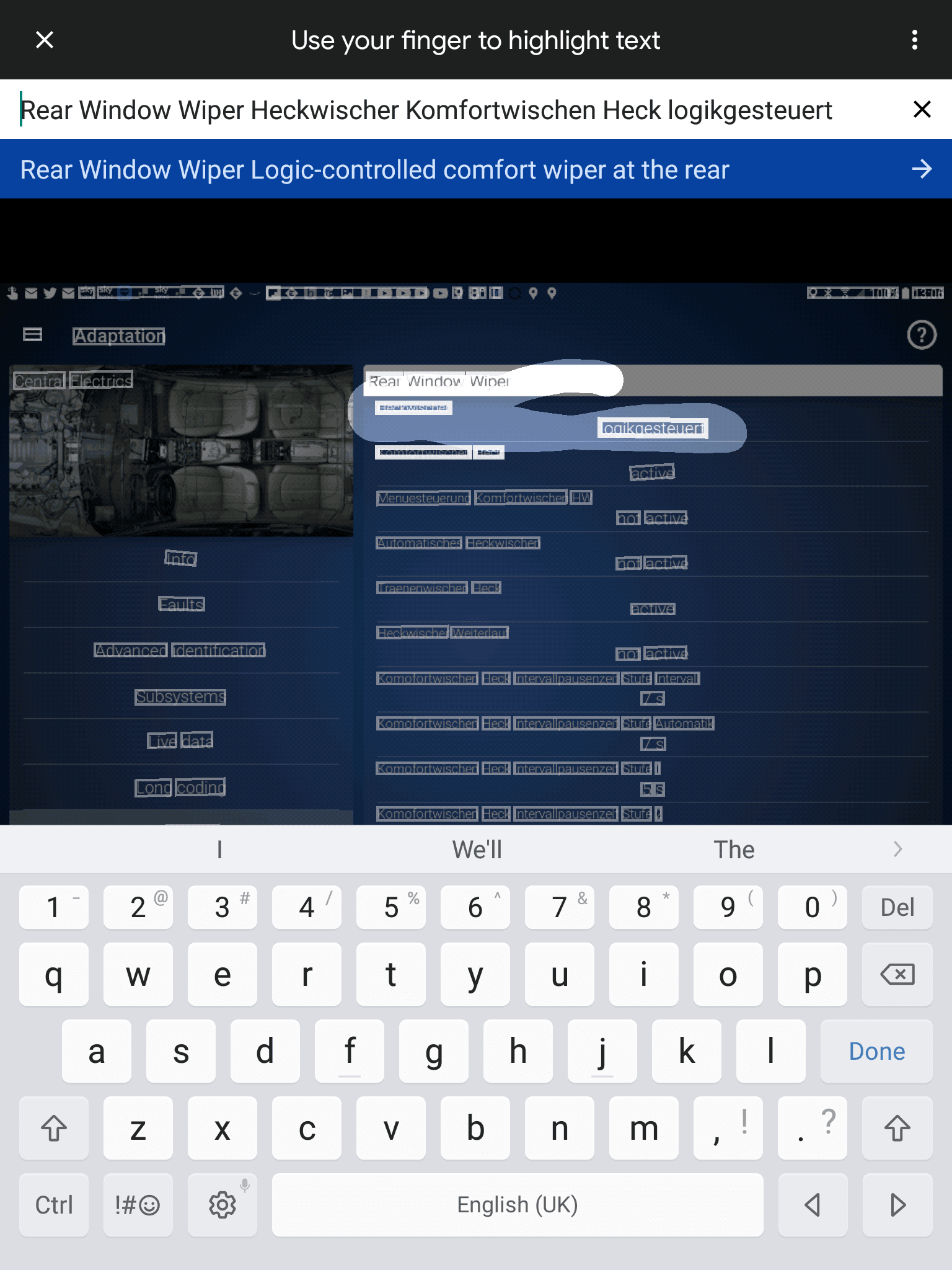

My "secret method"... assuming that's it. I use a screen shot and Google translate from image when I hit a lot of German in Obdeleven. If you don't have that wiper menu option then that will be a suppressed menu held in the infotainment unit. Which you'd find. Toggle on and reboot.

Not this ?
Security access
Access code 31347
Adaptation
Value=Not Active

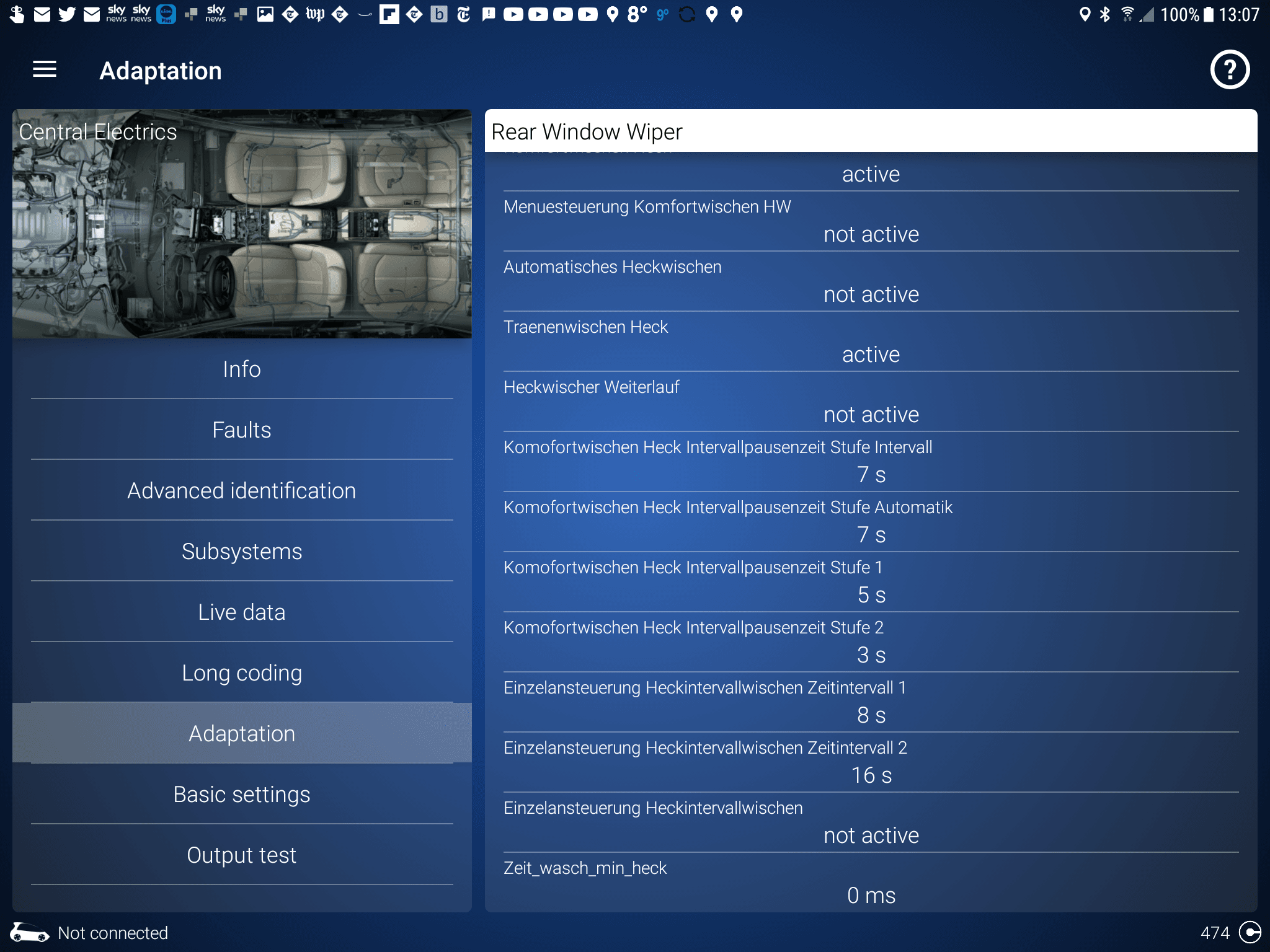

I thought you meant that there is an extra setting where the rear wipers are configured independently for wiping when raining.
The mod described above is the latest implementation I have submitted.
