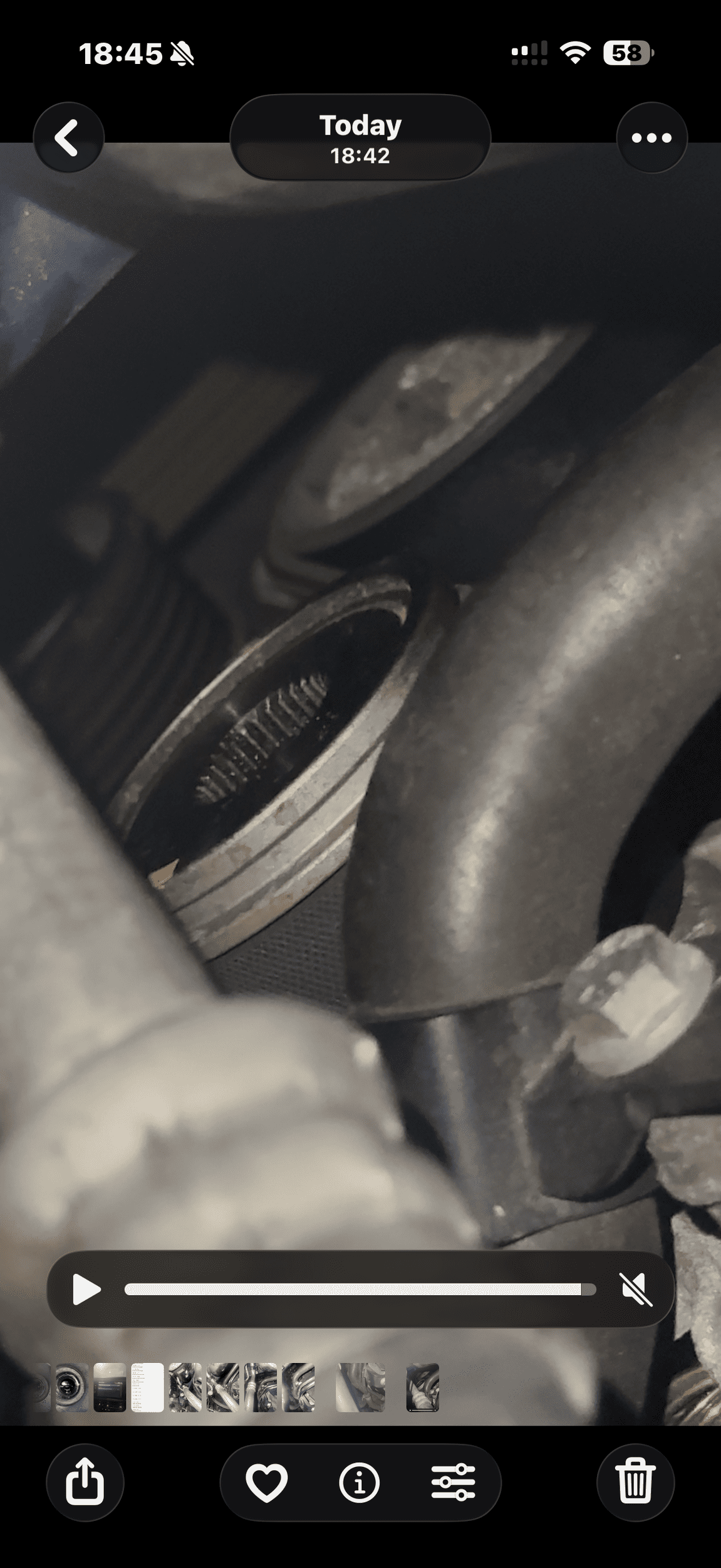

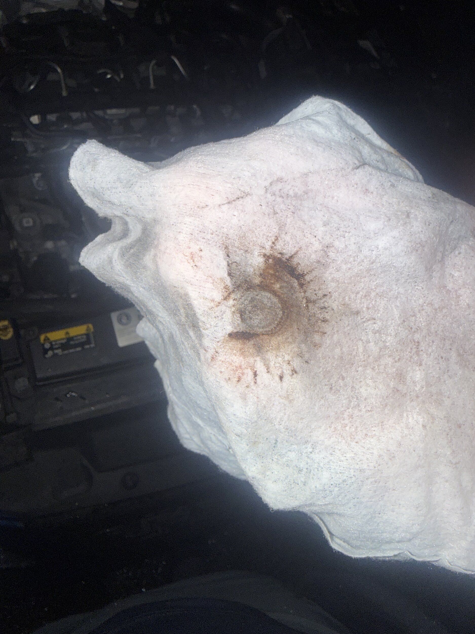

Joshfreeman03 Feb 26, 2026 5 0 Today at 20:00 #1 Hi wondering if anyone can help I have oil / grease coming from alternator pulley wondering what could be causing this 1.6 tdi 2019 Attachments IMG_4023.png 547.8 KB · Views: 4 IMG_4028.jpeg 709.5 KB · Views: 4 IMG_4026.png 641.8 KB · Views: 4

James_R 🏴🇩🇪🇪🇸 Staff member Moderator Apr 22, 2008 6,079 577 38 Manchester Today at 20:02 #2 The clutch in the pulley is failing and needs replacing before it causes issues with the alternator. Reactions: East Yorkshire Retrofits
Joshfreeman03 Feb 26, 2026 5 0 Today at 20:17 #3 James_R said: The clutch in the pulley is failing and needs replacing before it causes issues with the alternator. Click to expand... Is it oil or grease ?
James_R 🏴🇩🇪🇪🇸 Staff member Moderator Apr 22, 2008 6,079 577 38 Manchester 58 minutes ago #4 Grease
James_R 🏴🇩🇪🇪🇸 Staff member Moderator Apr 22, 2008 6,079 577 38 Manchester 53 minutes ago #6 Yes, the pulley needs replacing Reactions: East Yorkshire Retrofits
