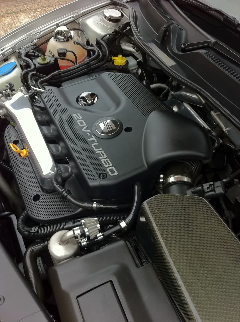

Yes a catch can will help this alot. I have one but still get a little bit of oil in the intercooler setup, this is perfectly normal thats why we have to clean our throttle bodies.

My can is fitted were the relay box goes. I didnt go to pod. Take a look at my readers ride for pics.

Unless your turbo seals have gone the oil is entering your intake tract from the crankcase via the PCV system remove the PCV system and fit a catch can this will cleanse the intake pipes of all that muck for good I mounted mine on the battery box, thought it filled the gap nicely

That said tho some engines produce more crankcase discharge than others the healthier the engine the less it will produce if I'm honest, mine barely produces any at times just oil vapour no black oil at all my intake pipes are always crystal clear, usually you'll find higher boosting cars will make more crankcase discharge due to the higher crankcase pressures.
