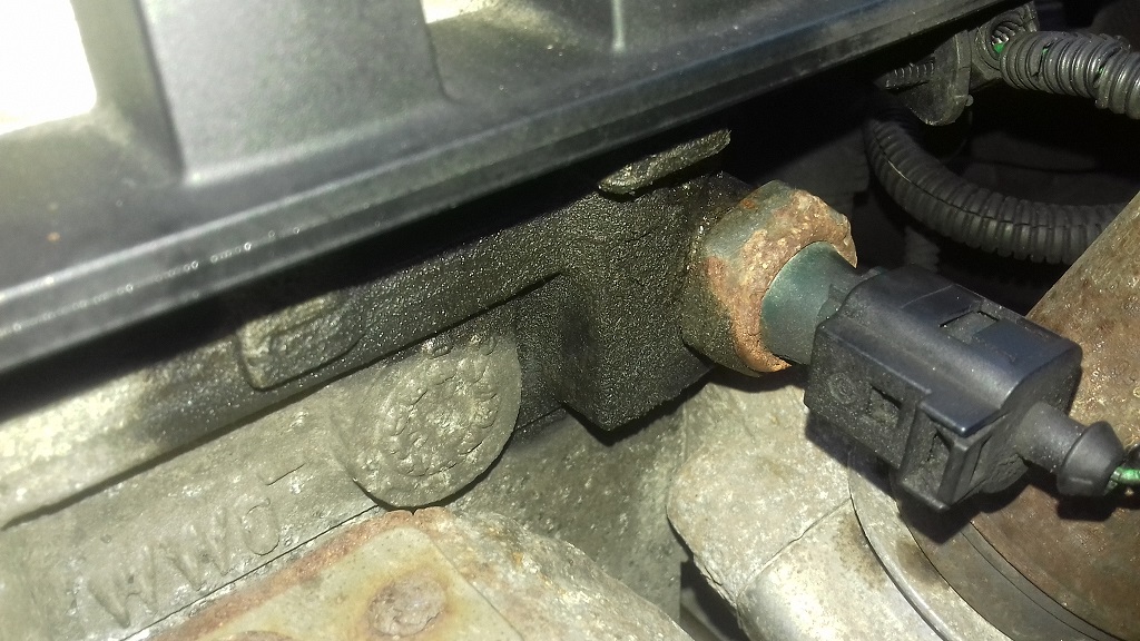

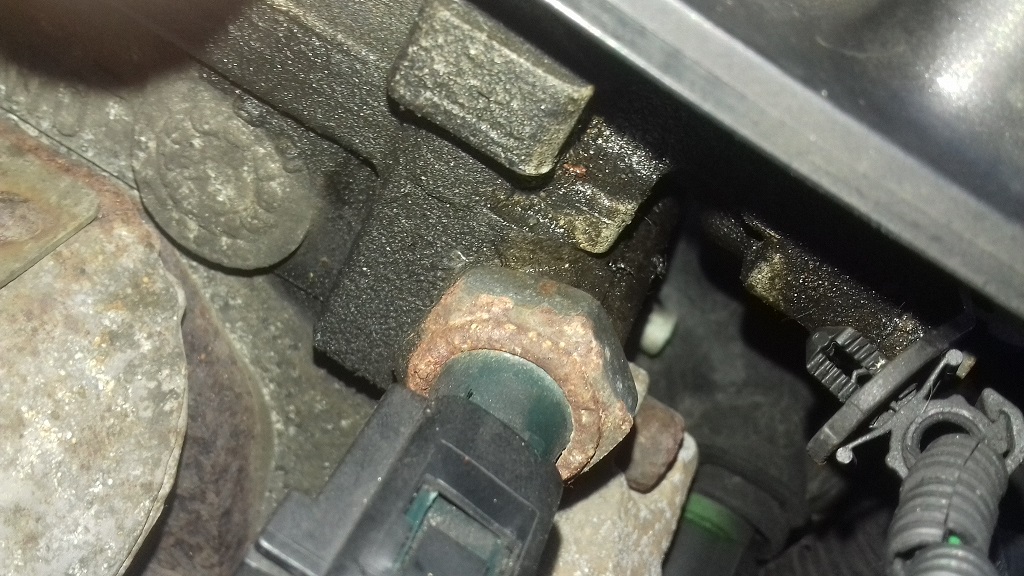

I did have a closer look at the oil pressure sensor before starting out, and the leak is worse than I thought, I've uploaded a couple of photos to show the extent of the leaking. It's probably spread around by the airflow traveling at speed, but still a leak that needs attention, it does look freshly wet just above the sensor on the block.

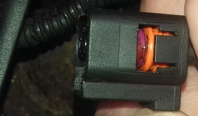

I took off the electrical connector, and there is even a bit of oil on that, I don't know if it's from leaking down the outside of the sensor, or through it.
I tried a spanner on it in case it had come loose, but it's very tight, so the plastic casing of the sensor must be cracked. I'll get a new one during the week, and hopefully that will be the end of the warning lights and beeps.
