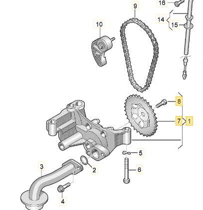

A 2011 Leon would be a Mk2 not a Mk3. The oil pump is already chain driven.

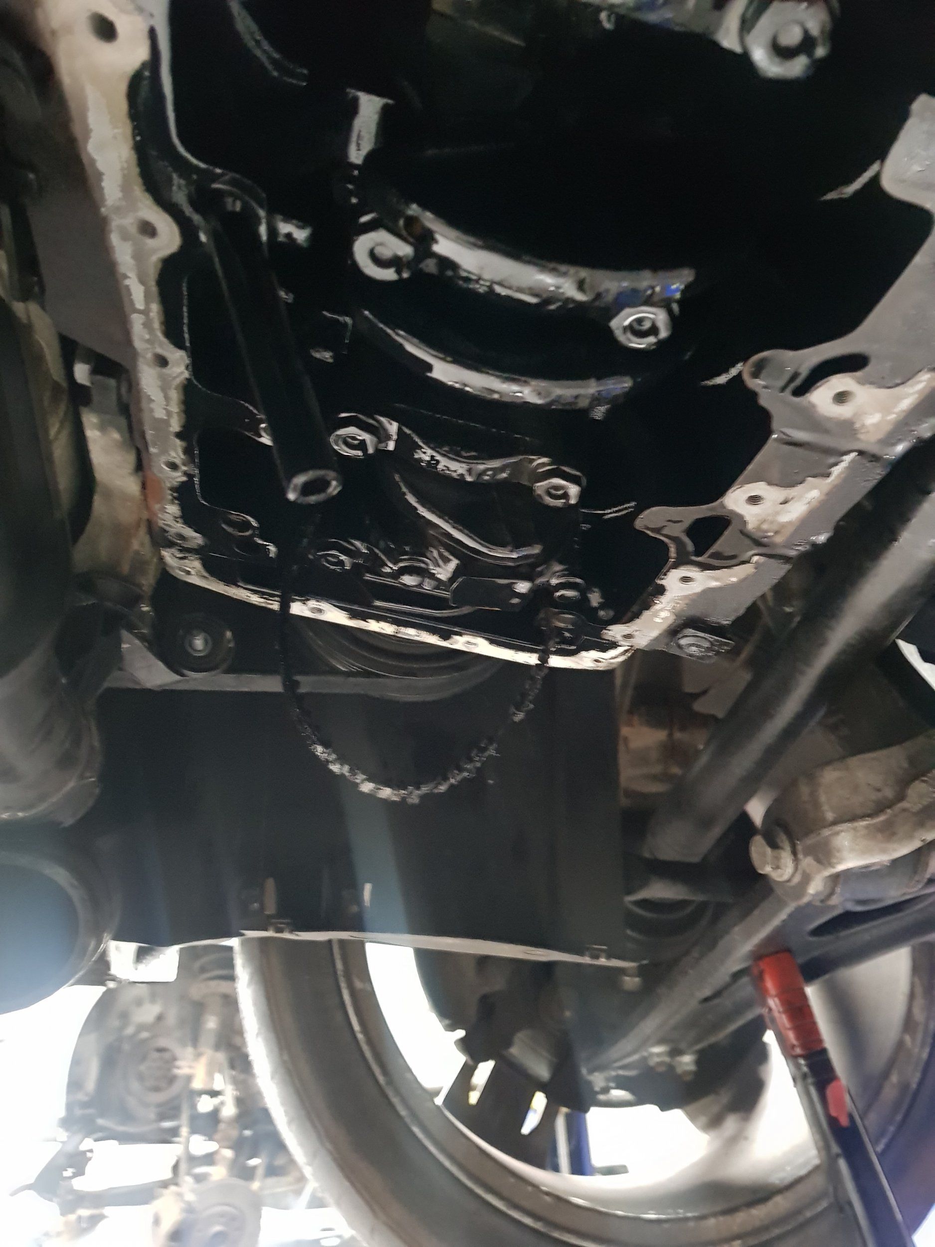

ive had red oil light flashing i knew its the oil pump..had the garage take apart and the belt that drives the oil pump was just about to come off..thought about putting chain on instead off belt..any thoughts

There is no belt that drives the oil pump. It is driven by a chain.

Ah my apologies... When you said it was a 2 litre CR engine I assumed it was the 170 engine. Completely my fault... I had the sump off my CR170 a few months ago to replace the rear oil seal and knew it was a chain I had seen on the oil pump.
To be honest, given how long it has lasted I would just fit a new belt. It's very unlikely it will be a problem for you again. You would have to swap out the crankshaft and oil pump if you wanted to move to the chain setup. That's more hassle than would be worth it IMO.

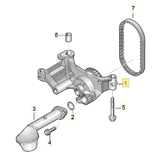

Interesting - Your engine should be the older EA189 and I didn't realise these had oil pump belts in oil like the newer EA288! but seems they do ;)
Belt PN looks like it is 03L115264A - remark Z=59
you 'may' be able to retrofit an oil pump assembly from the earlier chain version - but that would also probably require crank/DMF change - very expensive!
I would just refit a new belt - making sure the pump is working well and did not cause the belt issue?
oil pump 03L 115 105 B Diesel eng.+ CAYC,CAYB,CFJA,CFHC,CLCB
oil pump 038 115 105 C Diesel eng.+ BMM,BXE,BXF,CEGA,BKD

My EA288 184 TDI also has a small belt in oil to drive the oil & vacuum pump - as I mentioned, and VAG don't have any recommended service interval!!! 'Belt for life' they say...
Yes, because when if fails your engine's life will be over!
Your 11 year old engine needed a new belt - so on my reckoning I think changing these small belt's in oil every other cam belt change - so 10 years makes sense.
