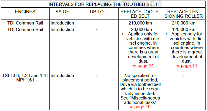

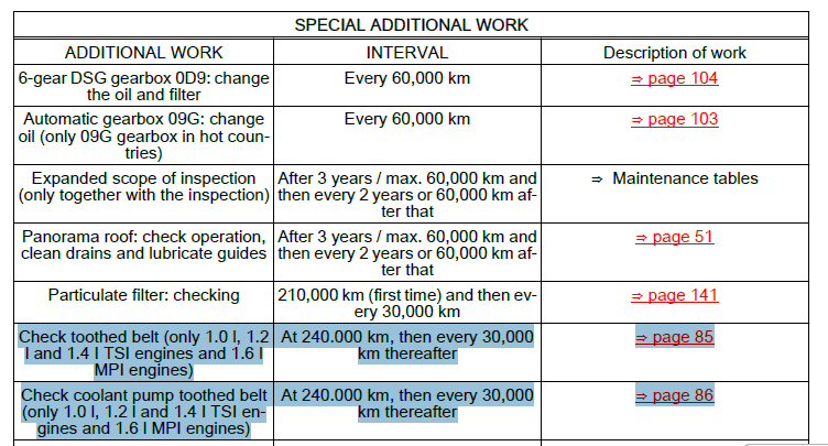

I would check with your main dealer to be 100% sure, but
From the 2017 Seat Leon workshop manual, which is what most of mainland Europe follow I believe:
And then page 10:
Full inspection (circa 150,000 miles) really needs the belt to come off - in which case you may as well fit a new one!
