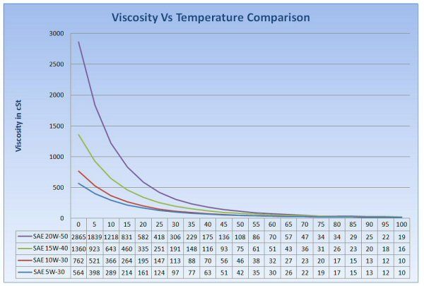

The attached graph shows viscosity vs temperature. 5W-30 has a viscosity of 161 cSt at 20 deg.C, reducing to 10 cSt at 100 deg.C.
This gives an idea of the impact of nailing an engine from cold. I wait until 80 deg.C, by which time the viscosity has dropped to 17 cSt. This is close enough to the fully warm temperature in my book.
