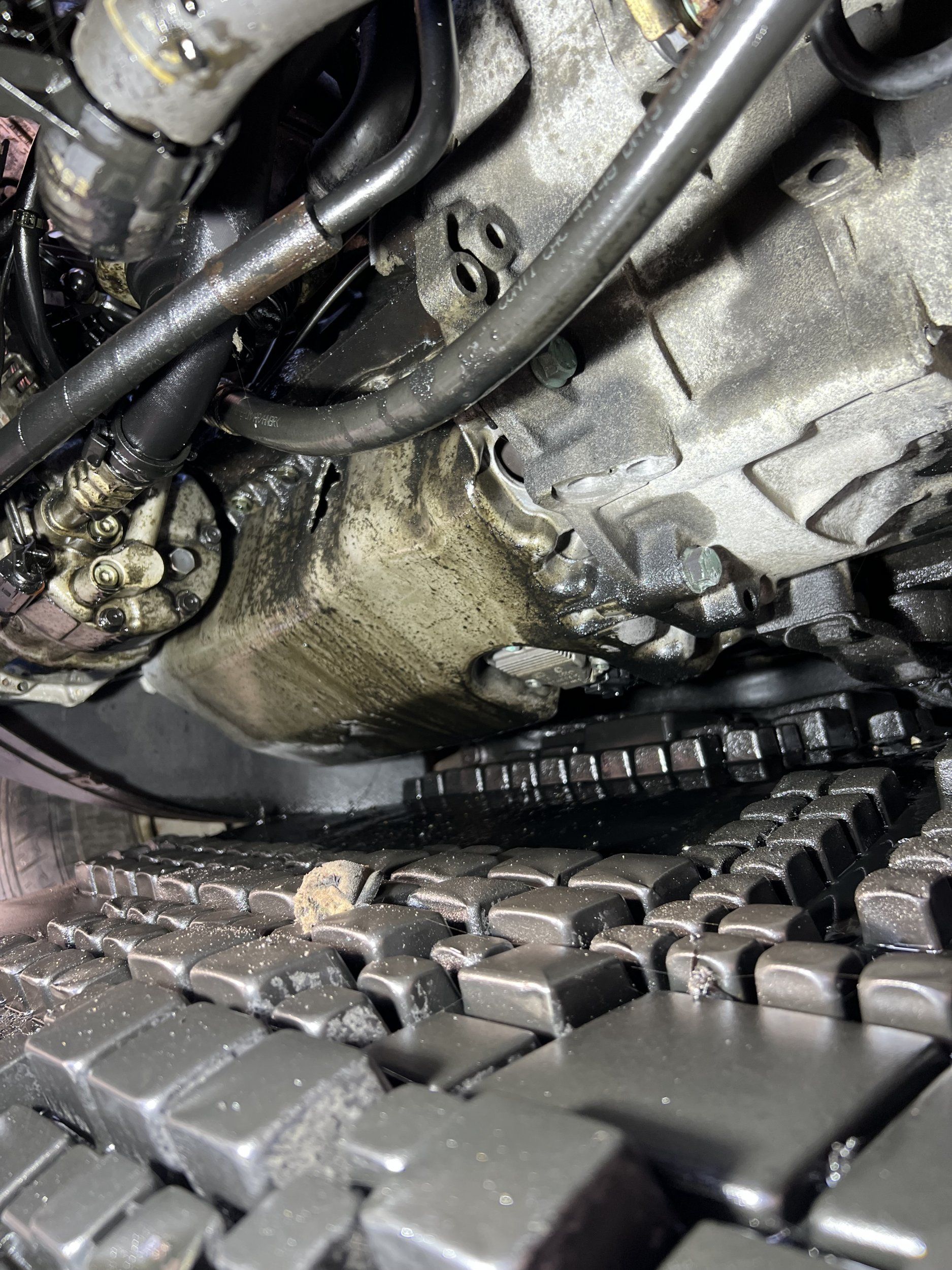

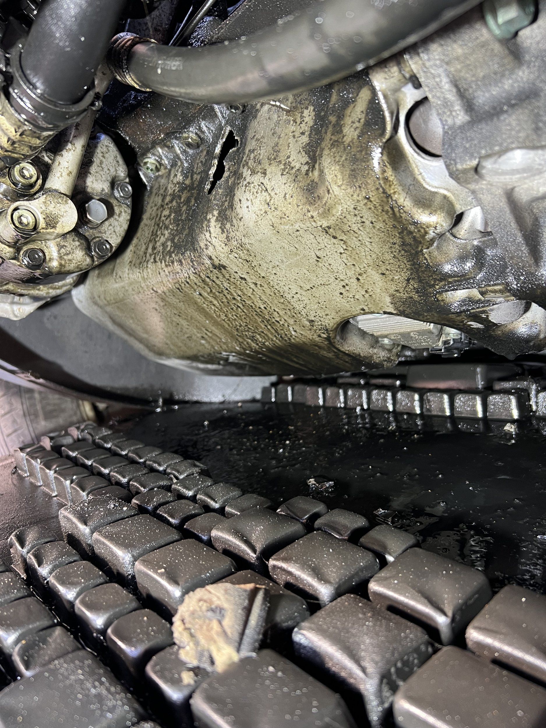

Well, I went to get our 2003 Seat Toledo 1.9tdi 110ps on Thursday this week for her MOT, she never made it to the garage as on the way there, as I began to accelerate the engine went onto three cylinders followed by a big ‘Pumpf’ sound, I immediately looked for a turn off from the main road and turned her off. I got her towed home took the engine cowling off to see oil plastered everywhere but no visible sign of what had gone. Checked with high powered light and mirror, first thing I saw was a small broken bit of ally sitting in the undertray, then I saw a hole about 13 mm wide and 30mm long in the front of the sump. I haven’t taken the sump off yet but I’m resigned to it being costly. So, I have 2 options find a replacement engine or despite her being for her year in really good order both body wise and interior having to send her to the Auto salvage guys. As you no doubt know when you’ve owned a car from new it becomes part of the family.

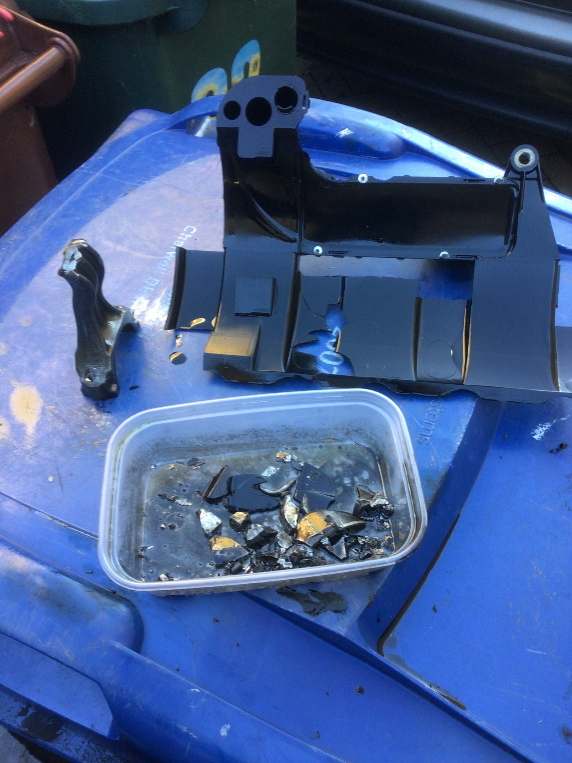

Removed the undertray and found this in the sump, the small amount of Ally I found in the undertray with a piece of metal from inside. If you’ve never taken a sump off before you’ll never bother again. Talk about over engineered with hidden sump bolt making it all the harder.

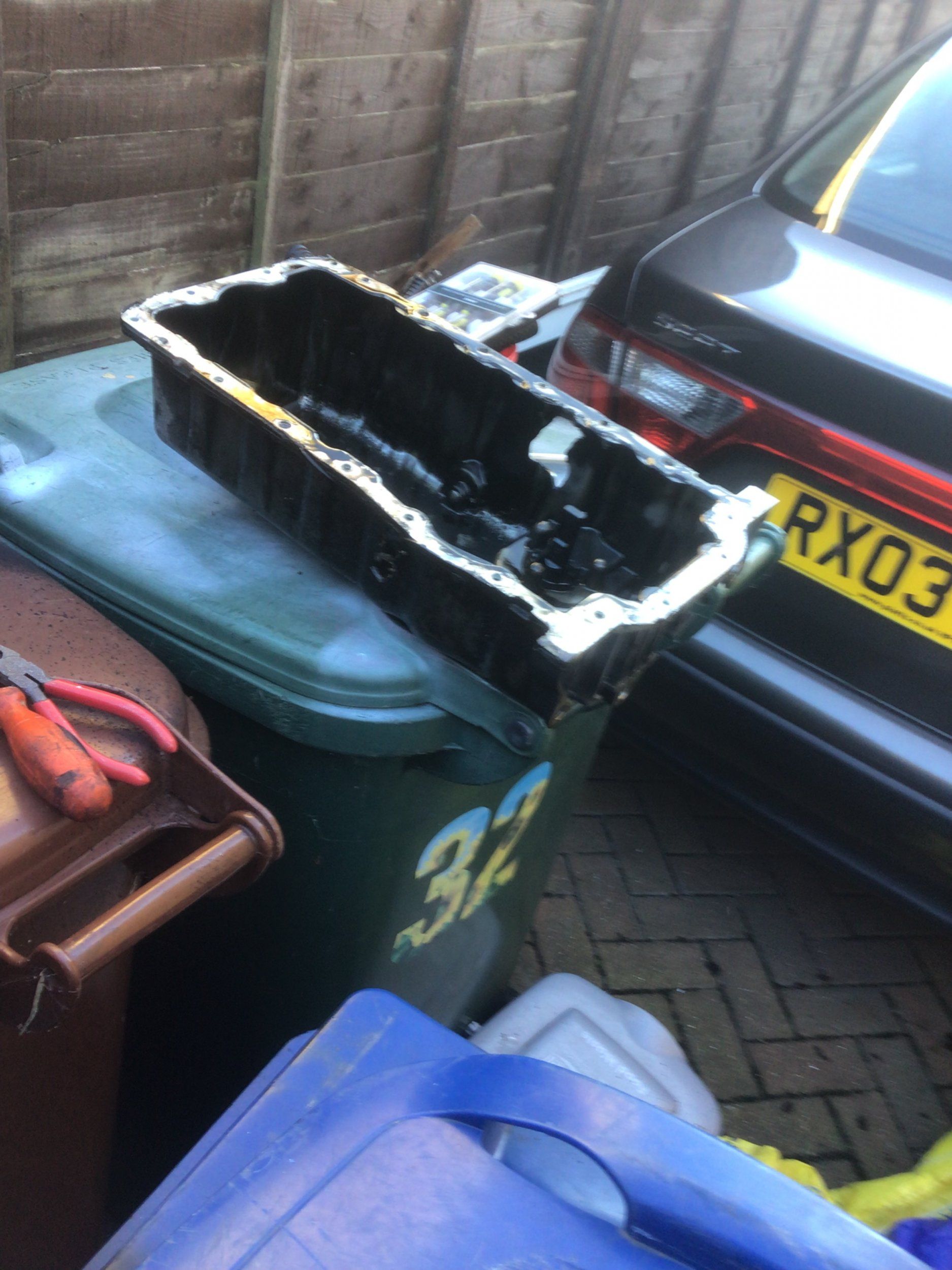

Picture of holed sump taken and looking for sympathy ( not that I expect any )

Very brave of you to rest your sump on your computer keyboard...

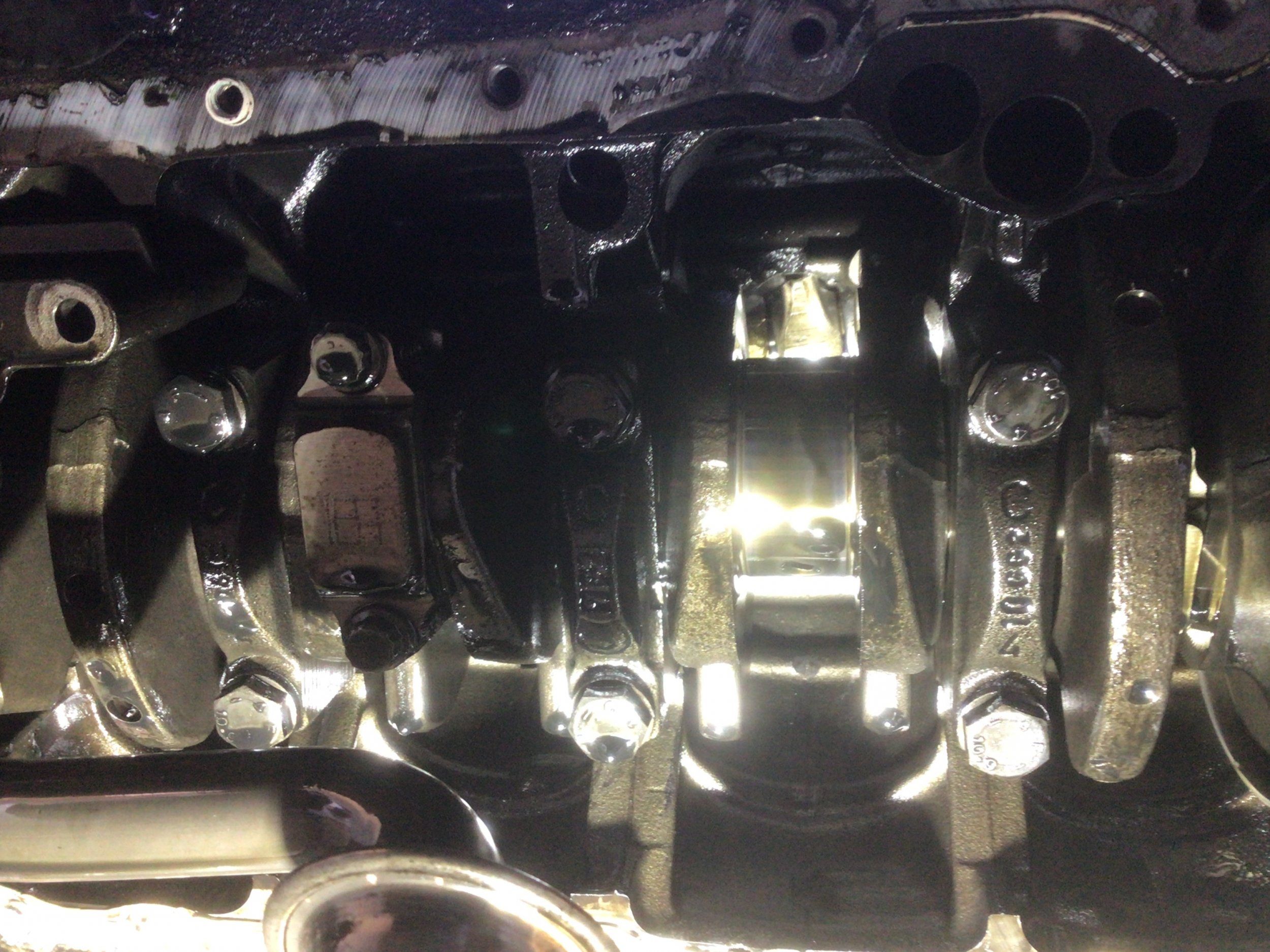

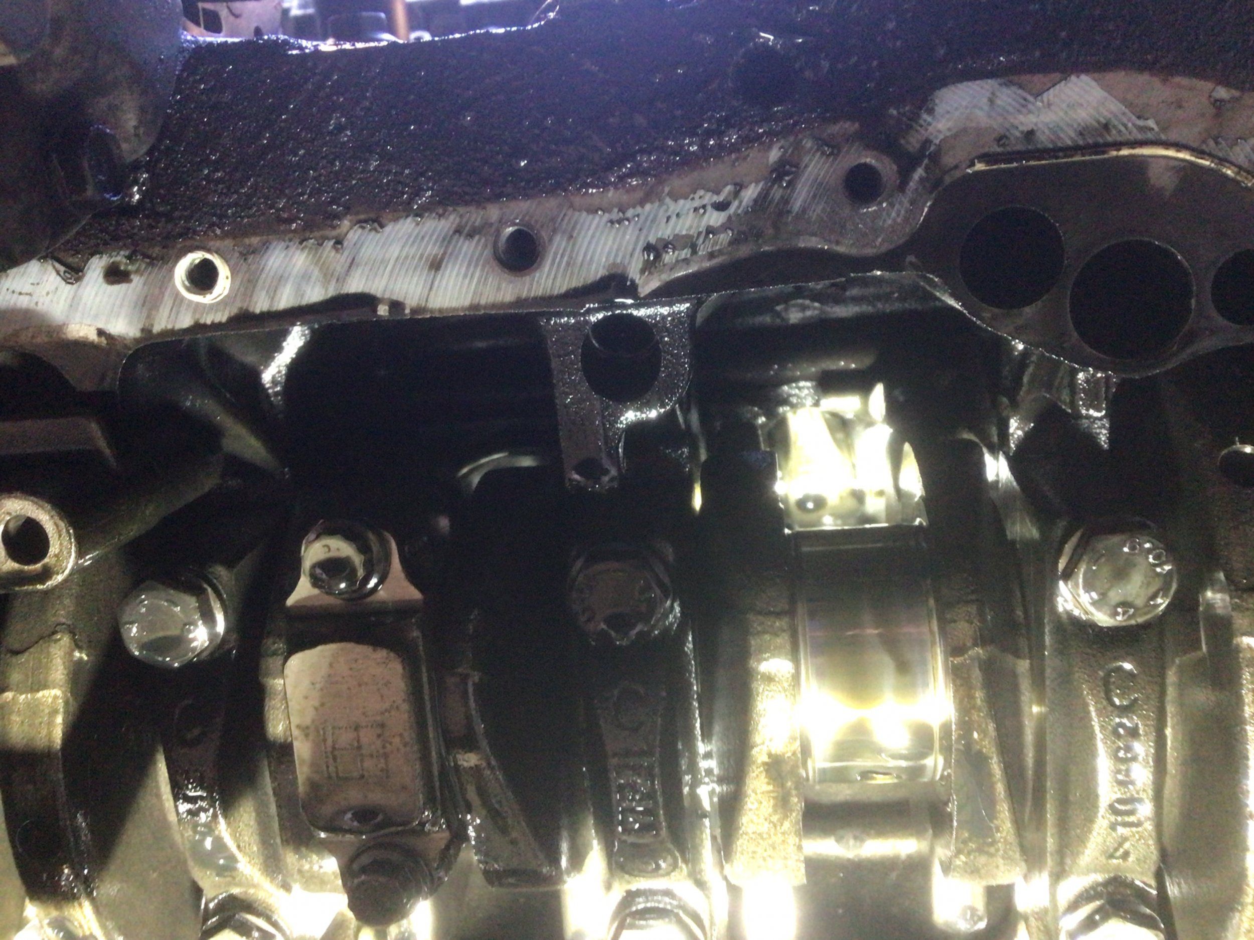

The Mechanic in me couldn’t not investigate what had happened, on removing the sump the hole at the front was matched by one three times as big at the back. The No3 conrod had snapped and detached from the piston but twisted and jammed between the crank webs, piston and other part of conrod still attached up in the cylinder. In all my years of driving (51) I have never had anything like this happen, guess it was down to metal fatigue and gutted that we’ll have send her nibs to the Auto Salvage.

Hard to see, but the crank or bits don't seem to be "blued" from an oil issue.
Had the car been through some deep water recently??
