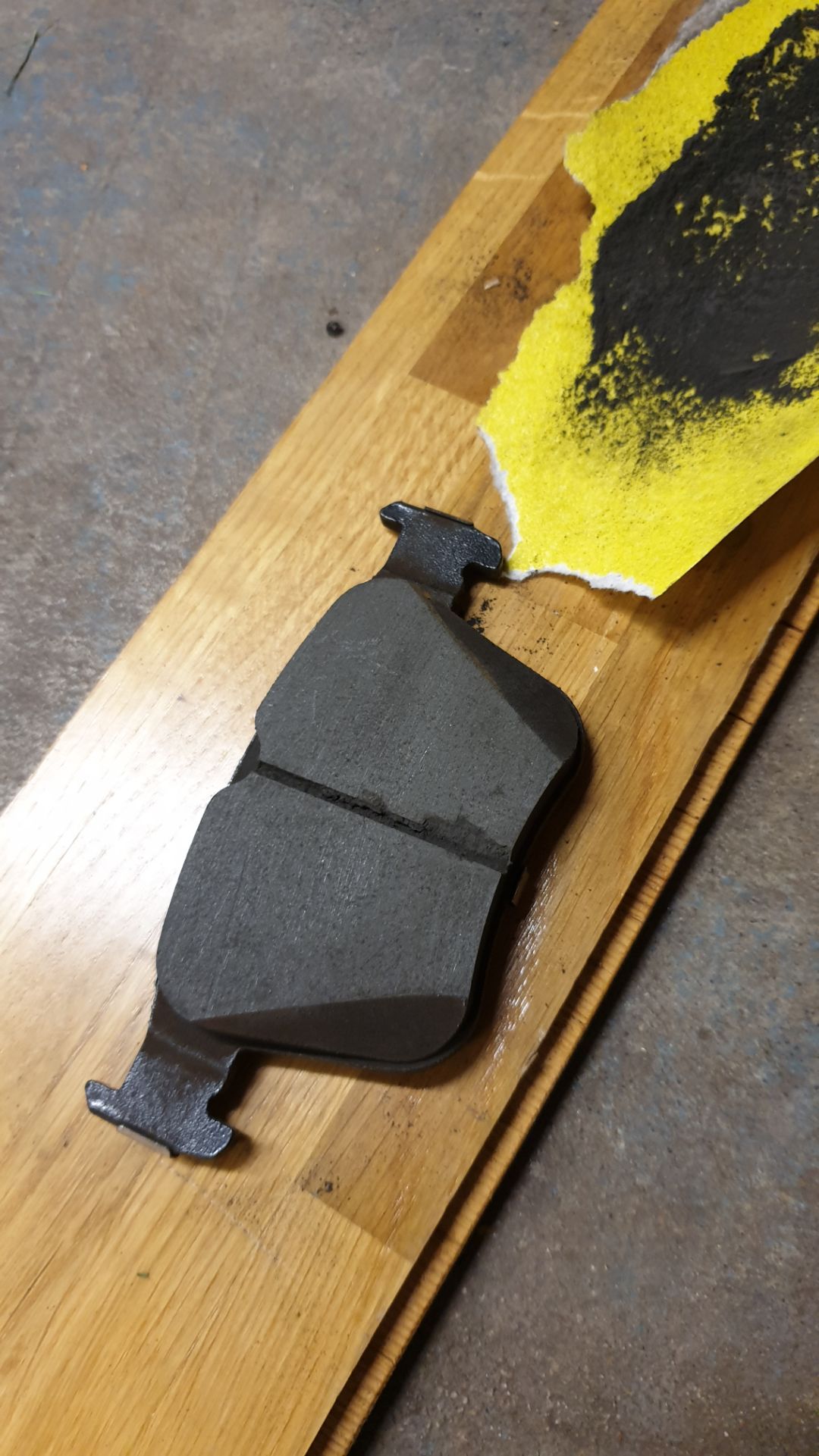

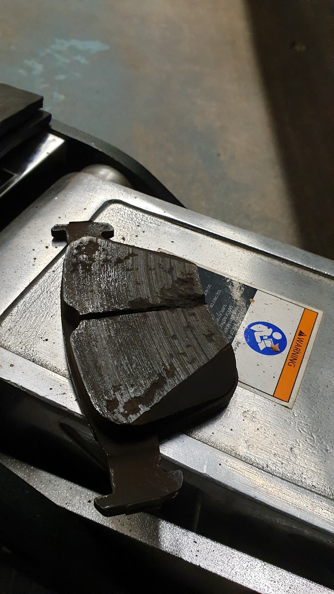

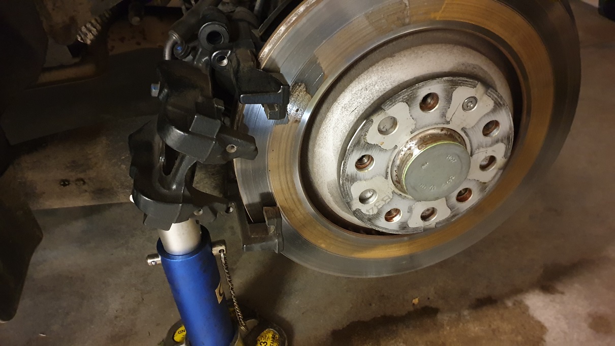

Cupra R 2018. Back in October I experienced a big bang (more than usal) from left rear brake the day after wash with handbrake activated over night..
Checked it after next wash and the disc looked not good. I dissembled the pads and as you can see on the picture material is missing on just one pad, (left rear outer). I sanded it as even I could and mounted it. After 2 sanding sessions it worked great again! Had to brake hard a couple of times from hi speed before it got even again.
Have just about 10000 km (7500 miles) on the odo now.
/Peter

B****y hell Swede that was what mine was like.
Well done good result. Such a lot of work for being a Car Nut or Enthusiast.
Thanks for the kind reply made me feel just a bit less like a total t**t
