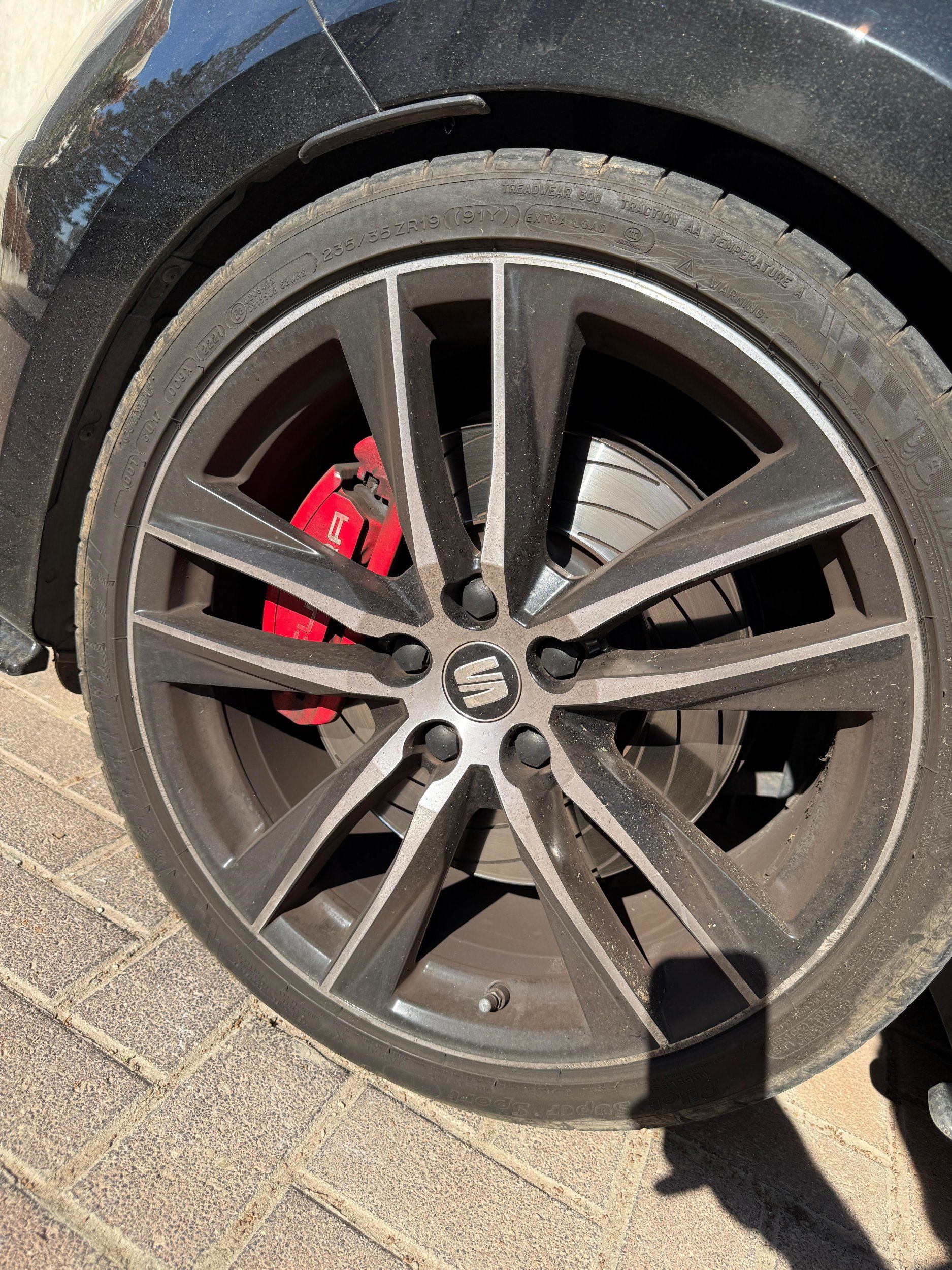

2018 5f 290 Cupra Leon
Got mine upgraded from stock around 35,000km ago when original one died.
I upgraded to full set of TAROX F2000 brakes with corsa pads.
Front ones
Rear ones
Pads
Changes the fluid also to their set (tarox) and braided brake hoses
Overall in driving experience all I have to say those brakes are significantly better and much more responsive with a higher range of baking sensitivity. In cold days the pads must be warm well before you can actually feel the strength of break because of the corsa pads but for daily use thats ok,
in track, high speed, and hot environment the brakes still function great with very responsive brake pad and strong brakes, much more then the original did. In addition, those brakes can take multiple track days and lots of laps before tear down or heats up. The claim is around 60,000-70,000k in daily use, which is also great

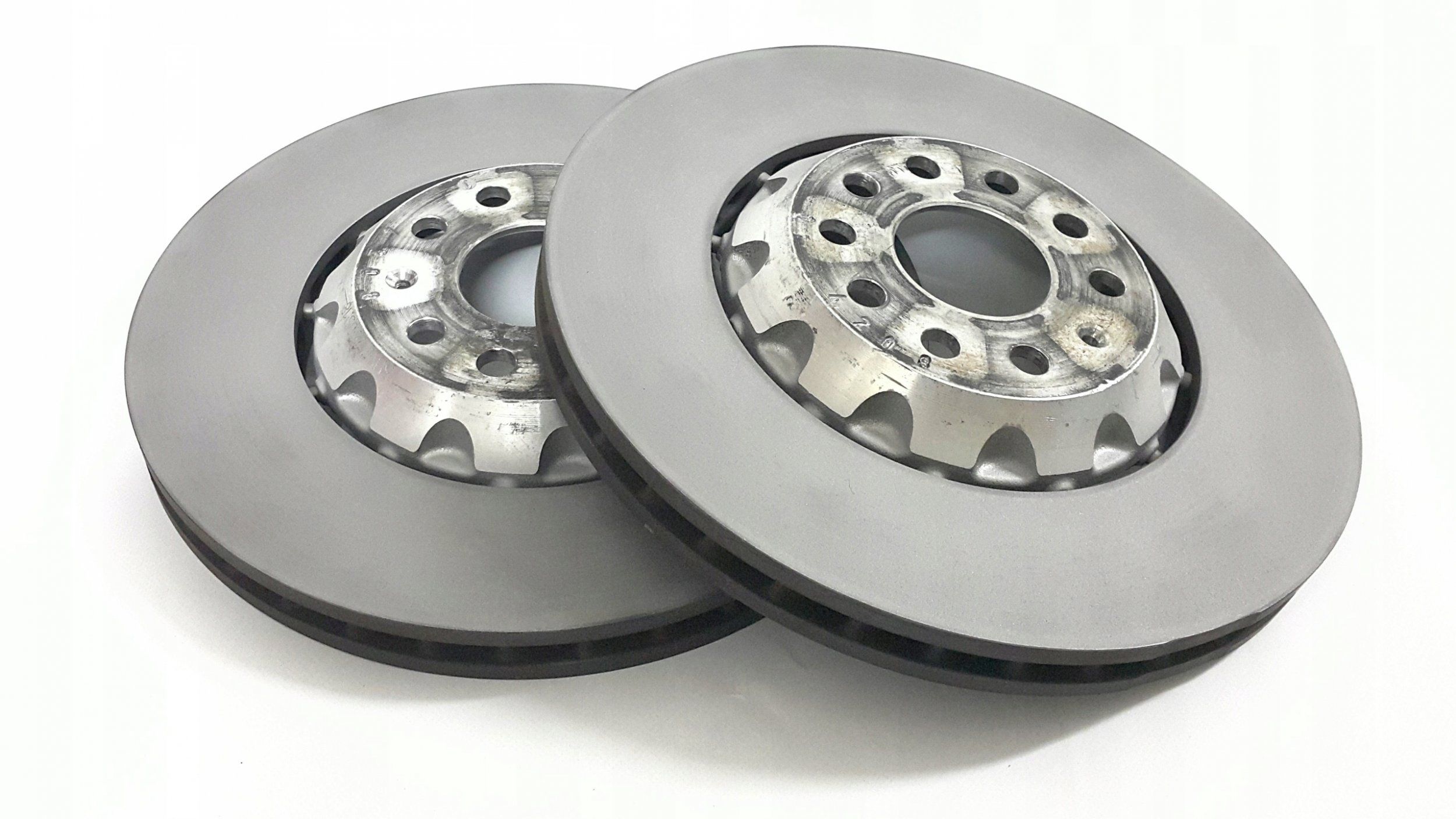

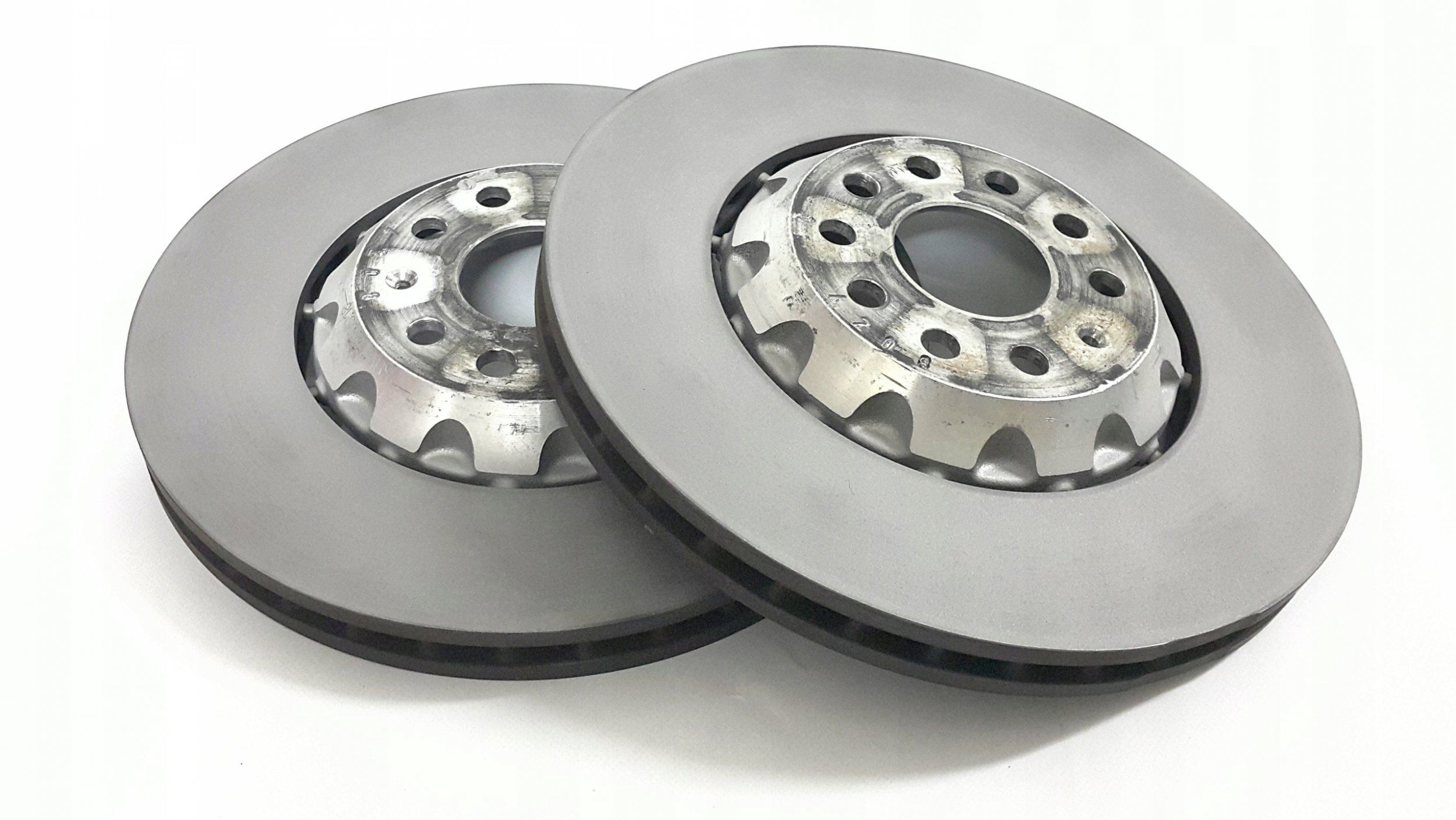

Regarding the 370mm disc - no you would need new caliper, pads and discs (maybe new hoses). Simple bolt on, nice - but expensive.
Uses a 4x fixed piston caliper & 370mm composite disc (alloy bell pinned to iron rotor) from the early TTRS.
The standard Cupra 340mm disc brake uses completely different single piston iron sliding caliper. Simplest 'upgrade' path is just fitting pads with good high temp fade resistance - which I would question their benefit if strictly a road car.

Those discs are nice - but very expensive - basically same price as the 370 versions!
Personally I would either fit some good pads to the stock discs, and fit some braided hoses and call it good - or if I was feeling 'flush' go for the 370 option.
Just the caliper swap alone will save some weight over the big iron single piston caliper.
The main benefit from fitting composite discs (two piece - alloy bell, with iron rotor) is improved thermal fatigue resistance - as discs get hot, the friction surface expands, as the cool it contracts. Over many high temp cycles you start to get cracks at the joint where the disc friction surface joins the iron top hat - this is why the better designed one piece cast discs generally have swoopy curves for the joining area - to reduce this cracking/reduce the stress riser..
Two piece discs by their nature are able to expand and contract and not crack this joining area as they are two different materials. This would only ever be an issue on the race track - you will never cycle the discs hot enough on the road.
