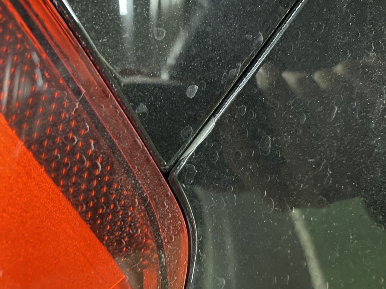

As you can see, seems odd?
Thanks for posting the picture.
It might be a reflection of the light, but along the very edge of the panel join on the metal quarter panel (metal 1/4 panel at the top and bumper at the bottom in the picture), there’s what appears to be a very thin white line - its most noticeable either side of the area where the lacquer has come away. If it's not a reflection of the light, it could be dirt, polish/wax residue, or more worrying, it might be the beginning of the lacquer coat beginning to lift. If it is the lacquer coat, then you’ll probably be able to feel it if you run the edge of a fingernail along the rear quarter panel side of the panel join.
I had a car in the 1990’s that I discovered had been repaired - not particularly well. On that car, the lacquer coat began to come away on the edge of one of the repainted panels and I put it down to poor prep prior to repainting or poor drying conditions after repainting.
If your car did have paintwork after leaving the factory and before you took delivery, I’d expect it to be recorded somewhere against your car - either on a central Seat database or at the supplying dealers.
Reactions: bgb
The white is wax and road salt. The black car curse unfortunately!
The raw edges I can see from the break don’t seem to be lifting any further, but I don’t want to provoke it with a fingernail!
I think I’ll take it to a dealer and get them to try and tell me it’s obviously my fault...
