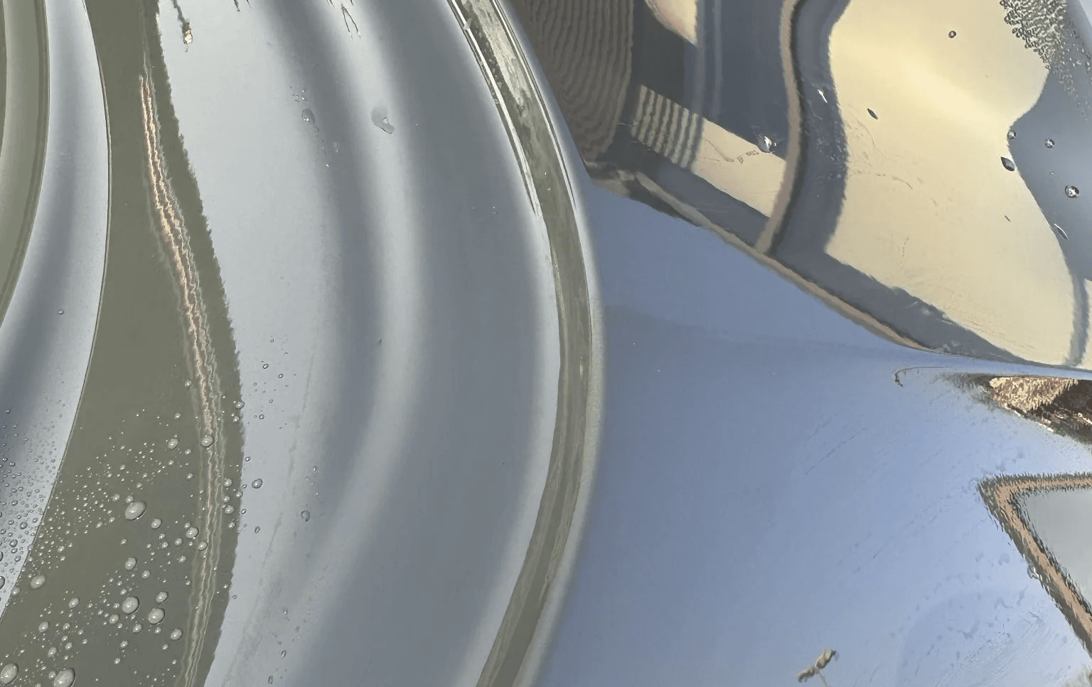

I've had a minor accident with my car close to the rear wheel arch, where a scratch caused a paint chip away entirely in about 2cm length (car is insured).
Since it's a new car, I wanted to see what the dealership would say, and they said that in order for that to be repaired by them, they needed to repaint the entire side panel.
After few weeks of waiting for the car, this is what I get. Photo is taken about 18 hours after retrieving the car (I got it in the late afternoon, couldn't see the extent of how amateur it looked to me).
Car has a very visible paint line. I've been told multiple times that VAG group requires painting entire panels in order to be up to standard so they can give warranty on the repairs. My insurance paid quite a hefty sum (in my market) for them to repaint just that part of the rear panel, including rear bumper (it had a scratch in the corner, and they insisted it needed a repaint and not a polish), with these results.
The inside of the door, edge with the outside of the panel is very rough on touch, the entire length it was repainted (I suppose this is lack of experience with a polisher?).
I don't think this is acceptable, but am I off here?
Can someone confirm whether Cupra also respects the VAG document that "paint blending" technique is unaccepted by official dealerships?
I'm really puzzled on what to do about this. I'm just not confident that they have the skills to do this properly, even at a second attempt.
I owned the car since August, it's always in garage and was sent in pristine condition, and I was hoping it'd get done properly.
Thanks everyone, hopefully someone can put my mind at ease ?
P.S. they billed 8 hours total for the work on the side panel and entire rear bumper (couldn't find paint lines there, so hopefully they repainted it in entirety)
That looks unacceptable to me.
If the entire panel should have been painted, then why the line halfway down a panel?

Basically they painted halfway, they didn't paint the entire panel, that's the whole issue. The line is visible on the inside of the door as well.
They covered about 2-4mm behind the doors on the side, masked the rest off. I can easily feel under my fingers where's the line.

I'd have said at least 8 hrs to do it properly, but they haven't.
As for your paint protection, well, I had a driver's side door dent fixed on my Leon which has paint protection and they asked before starting, so they could re-instate it, and the repair is now invisible.
I can't say what Cupra's official stance would be but I consider that a shoddy repair, any bodyshop I've used paints the entire panel and blends into the adjacent ones.
I'd say that has a high chance of failing, plus, it looks lousy. I'd reject it. For the repair I had done I rejected it for a minor ripple you had to look along the car, knelt on the ground, and the bodyshop supervisor agreed and apologised.
