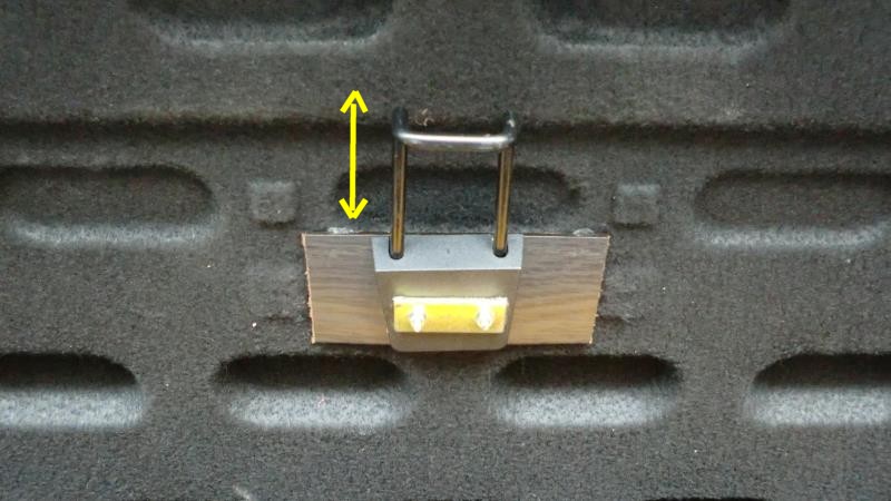

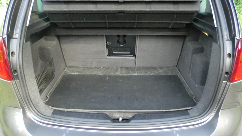

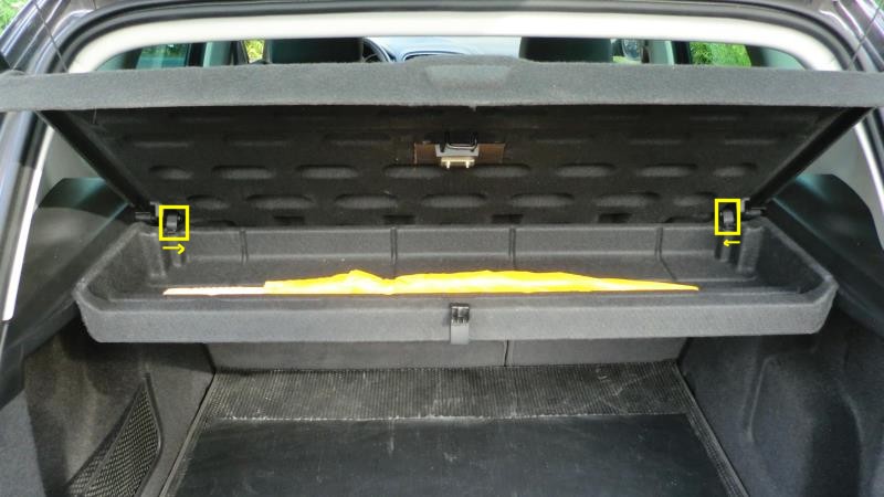

As the ALTEA facelift models come with a slightly different boot cover, the knob that formerly holds the parcel shelf (pic#1) underneath the old boot cover (5P0 867 134 E/F) doesn't fit the new cover (5P0 867 134 G) any more.
Hence I had to construct some other fastening (pic#2+3) to continue to use the old tray with the new boot cover.

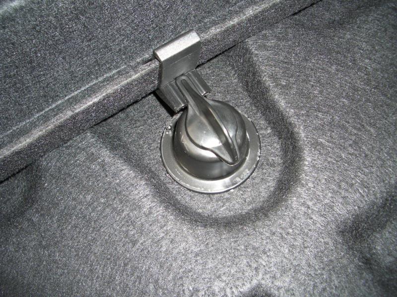

In addition, the position of the two mountings attached to the tray (pic#4) were sitting a little too far to each end and had to be moved a little inwards (~0,5cm each = as much as possible) to match the holders of the boot cover (mounting (5P0 867 575 A) + locking sleeve (5P5 868 767 A)).

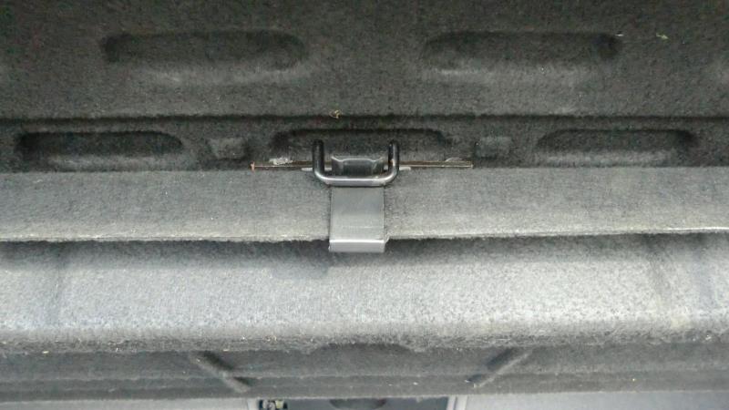

Now the look and feel of the additional parcel shelf is back in my new ALTEA (pic#5).

Hutablage_01.jpg Altea_14TSI_CIMG9337_Hutablage.jpg Altea_14TSI_CIMG9338_Hutablage.jpg Altea_14TSI_CIMG9336_Hutablage.jpg Altea_14TSI_CIMG9335_Hutablage.jpg
