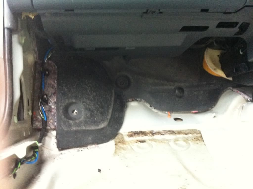

I was hovering the rear of my ibiza yesterday and noticed water appearing on the surface of the carpet, having searched the forum i found it to be a common thing. so today i lifted the carpet up to check the gromet in the rear footwell and it is fine, however i noticed most of the water had been absorbed into the carpet and sound proofing.

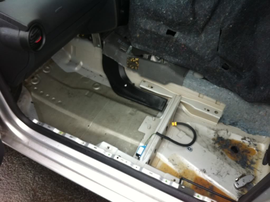

I then worked forward removing various trim/seat etc and found there was loads of water collected in the front carpet aswell. here is what the car looks like at the moment;
I'm now at a bit of a stand still and dont know where to actually look for the leak as there is no obvious one place of water it is spread in both front & rear. the carpet under the glovebox is soaking aswell but i'm struggling to remove it. does the glove box need to be removed to get the carpet out ?
Could any one help me on advise or what i can do next ?

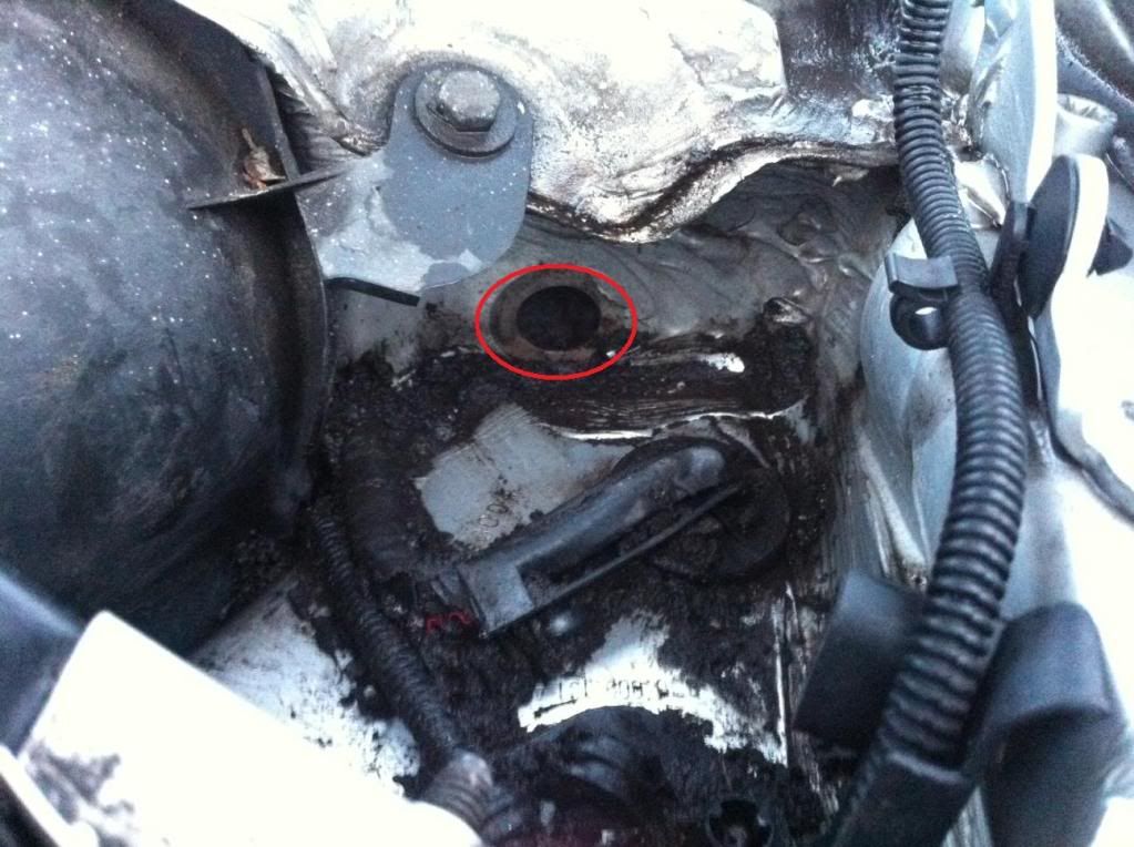

Update - this my problem ?
I think i may have found the problem, should there be a blanking grommet where i have circled in the pic, me and my dad are sure there should be as just inside that hole is the sound proofing which is soaked.
? thanks

if u remove the plastic cover around air duct for heater mine was leaking threw where the wiring loom was coming threw bulk head

Just wondered if bunging up the hole in the engine bay on the prev pic did the job as I'm also missing a bung and this'll be an easy fix. Otherwise, does anyone have any other suggestions?

My car wasn't missing it's bung, the bung just would not fit properly. So it's since been pushed in and sealed with waterproof silicone and there's been no leaks since.
I'm glad somebody posted a picture, getting to see where that bung is, is a nightmare!

Turns out rain water was seeping up into the hole as described. There was enough debris in the bit below the scutle panel creating a pool of water and not draining down. I've put a Lego brick under the cable protectors to lift the wires and stop this forming a rim where dirt was siting underneath, then I cleared all debris and there's a small channel that flows water under where the bung should be - also clear. I've plugged the grommet hole temporarily with polystyrene to see if this is the fix it needs.
Fingers crossed this is the only leak!
I'll update with pics when I fix it permanently or discover anything else it could be. Now the drying starts on the sound proofing and carpets which is gonna take time!
