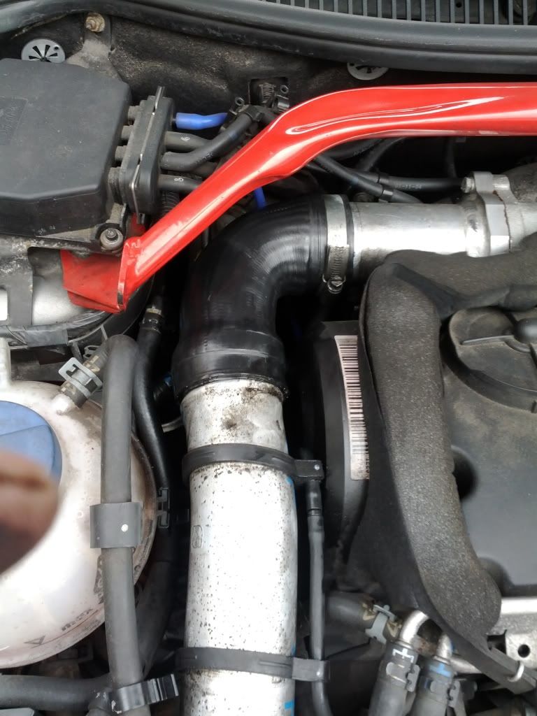

Hi peeps,
Anyone know a good way to secure this pipe?
It has come loose twice now in 2 days and its starting to really anooy me.
This time round I cant even find the jubilee clip that keeps it in place!
Would a bigger hose be a better idea? as this one just about reaches the other.
Thanks :help:

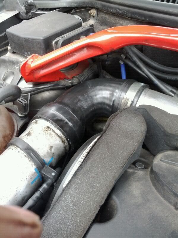

It looks like it isn't sitting over the raised part of the lower metal pipe so you may need a longer peice of pipe pointing towards the front of the engine bay
It normally is but only just, that was me just taking a quick pic inbetween re-securing it.
Where can i get another one of those from?
Im not sure if i do, ive just had a look at your RR and dont know what in your engine bay is the EGR delete.
Thanks
Egr delete is the short silver pipe at the top of the picture, runs horizontal at the top of the engine.
Picked up my new hose from AP motorstore yesterday and fitted it last night.
Took it out for a blast and there is no sign of this pipe coming off. :1st:
