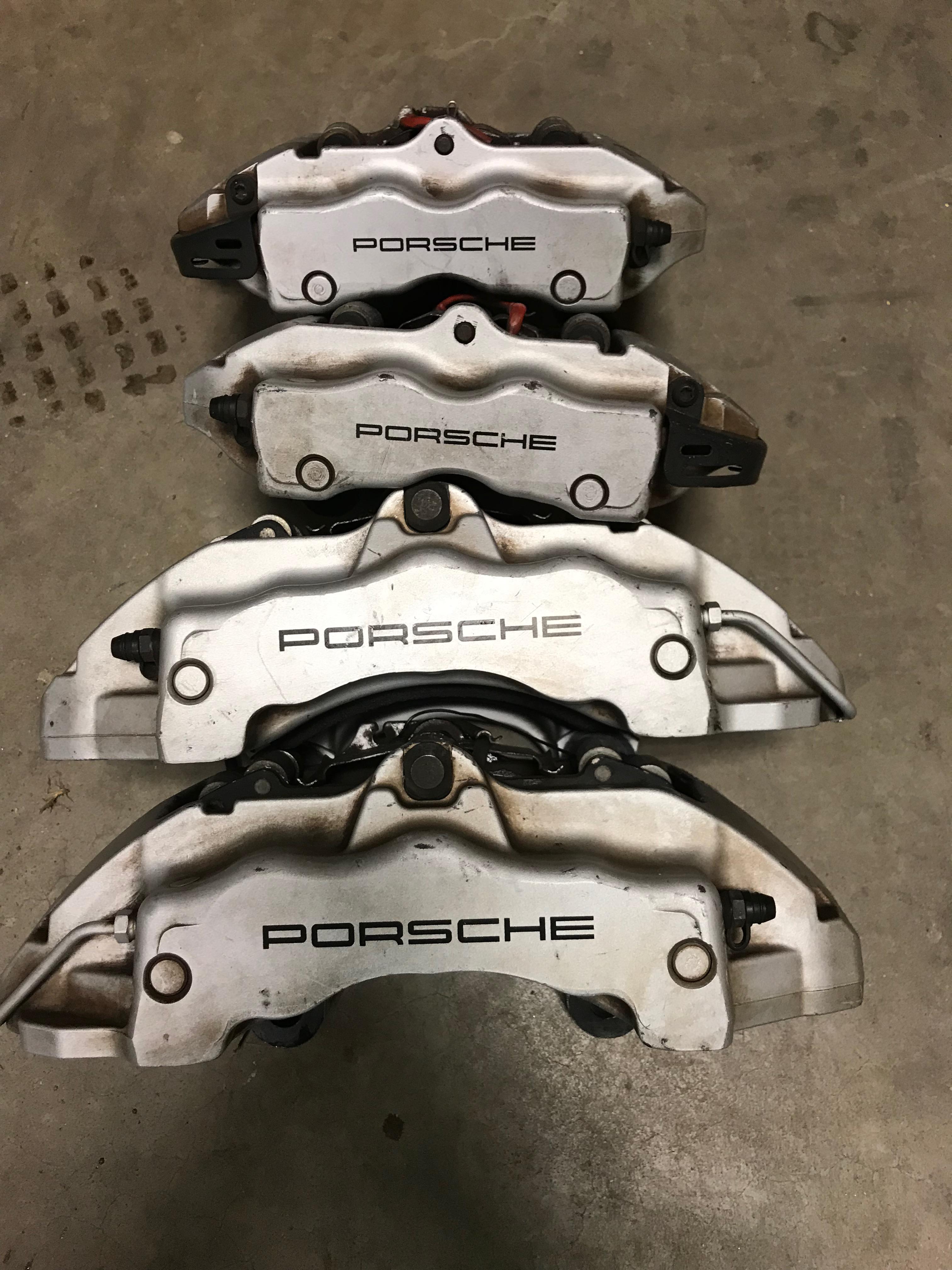

Hey guys just wanted to put this out there some proper information on upgrading Leon brakes to the big ole 18z Porsche Cayenne Brembo setup. not to be confused with the 17z's that are SHITE for our cars since the caliper pistons are bigger supposedly the master cylinder cant keep up.
That being said I'm actually doing the full cayenne setup to my car front and rear... ridiculous i know but with my FINAL HP goals now changing to 650hp on e85 and 500hp on 100/98 octane and traveling (not street racing ofcourse) on the autobahn and racing on the track i figured why not have brakes that can rip my face off when needed and also be daily drivable that are not loud race pads / Especially not burn my wallet everytime i need to replace a warped rotor...
There are many options for brake rotors and setups but im swimming up river on this because im disatisfied with premanufactured options. You can have 360 or 370mm audi ttrs or Rs5 discs that will cost you 500 minimum for a pair. Or 334mm R32 discs that are technically too small for these pads as it doesnt utilize the entire pad surface and those cost around 175 to 200 for a pair.
Here are the Caliper and rotor specs incase anyone was wondering.
LCR 4 pot brembo front: 36/40 (4549.02mm^2)
LC/4 2 pot slider front 54mm (4580.44mm^2)
LCR 2 pot slider rear 38mm (2268.23mm^2)
Porsche 18Z 6 pot front 30/34/38 (5497.78mm^2)
Porsche 18Z 4 pot rear 30/28 (2645.22mm^2)

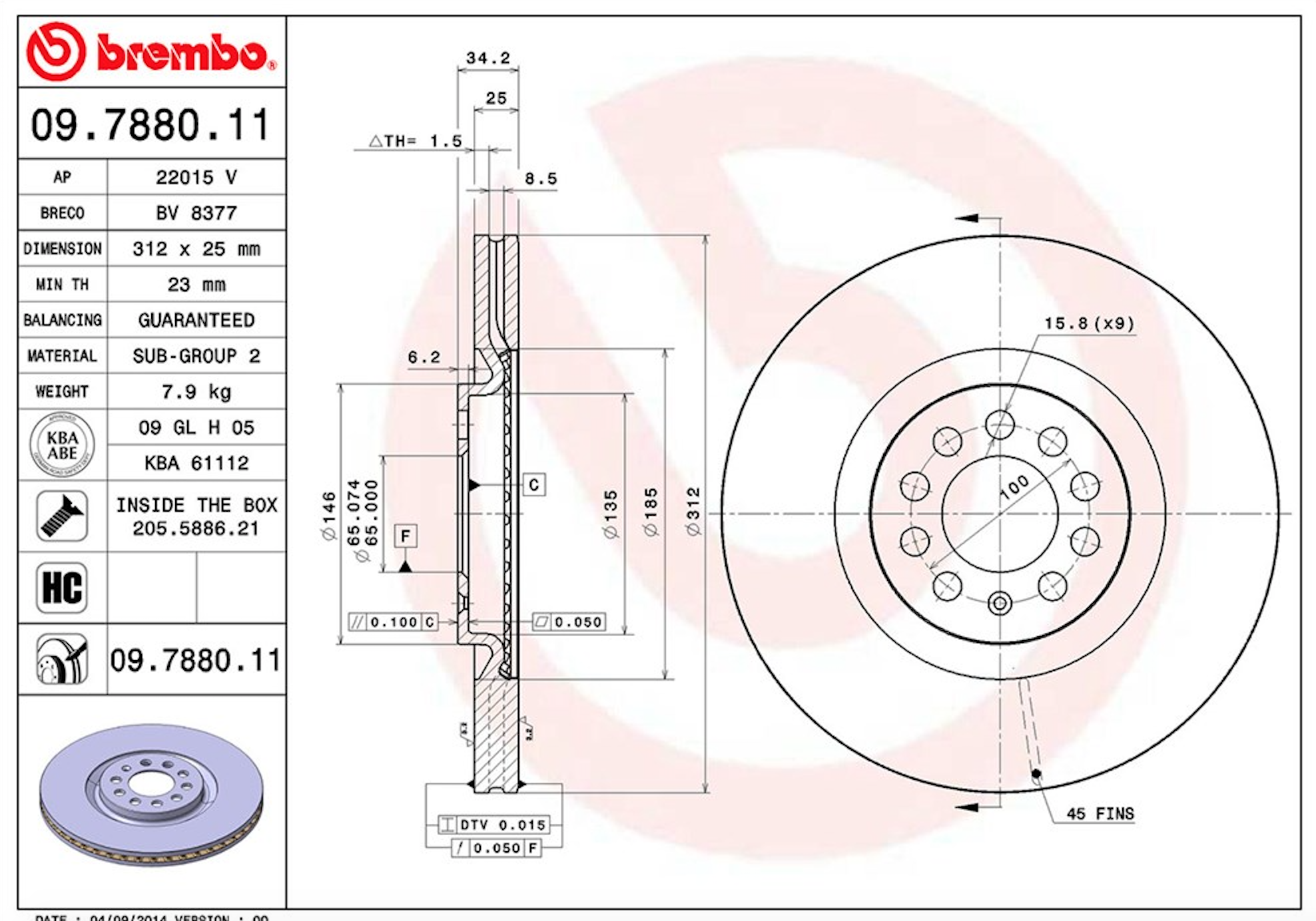

LC/4 Front discs : 312/25mm
LCR Front discs : 323/28mm
R32 Front discs : 334/32mm

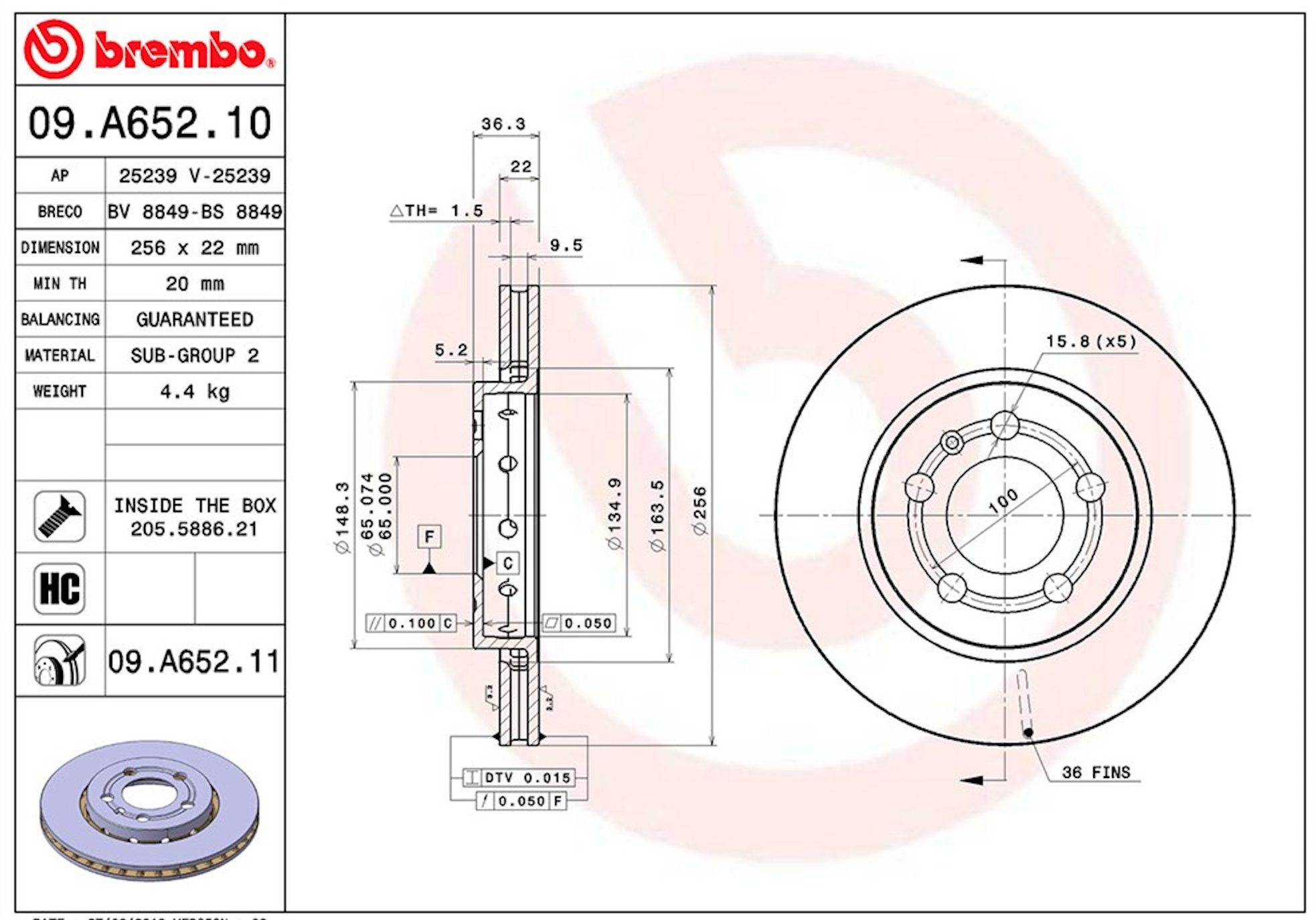

LCR/LC4 Rear discs: 256/22mm
Phaeton Rear discs : 310/22mm

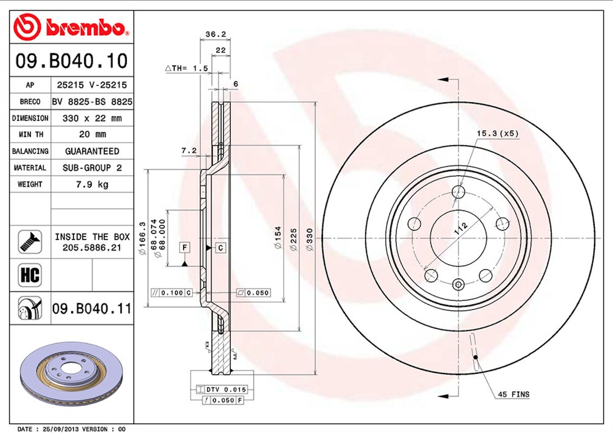

The best choice for least headache and plug and play kit from epytec for the porsche calipers is the mk4 R32 334mm fronts matched with the VW Phaeton 310mm rears. With that setup you will have a 68% front braking bias. But something to consider is the Cayenne 18z stock runs on 350mm front discs and 330mm rear discs. With a larger sweeping area than these discs have, so you wont use the entire pad surface.
If you want a better brake bias and want the perfect front disc sweeping area with the smallest lightest (cheap) disc possible than go with the Audi S4 quattro front discs and Phaeton 310mm rears. Epytec will make you a custom adapter for the front discs and change the PCD when asked. This will increase your brake bias similar to stock above 70% front brake bias and youre utilizing the entire front pad.
But I want to have bigger discs because why the hell not im doing a custom setup i might as well do what will make me drool every day i look at the car and see massive ass brake discs behind my 18" wheels.
I will be going with the XC60 II front brake discs at 366x30mm and the S4 Quattro Rear discs at 330x22mm.
This will give me a 71% front braking bias and will be using all of the pad surface area front and rear.
Epytec will make me custom adapters for both the front and rear and i will have to change the PCD to 5x100 for all 4 discs.
