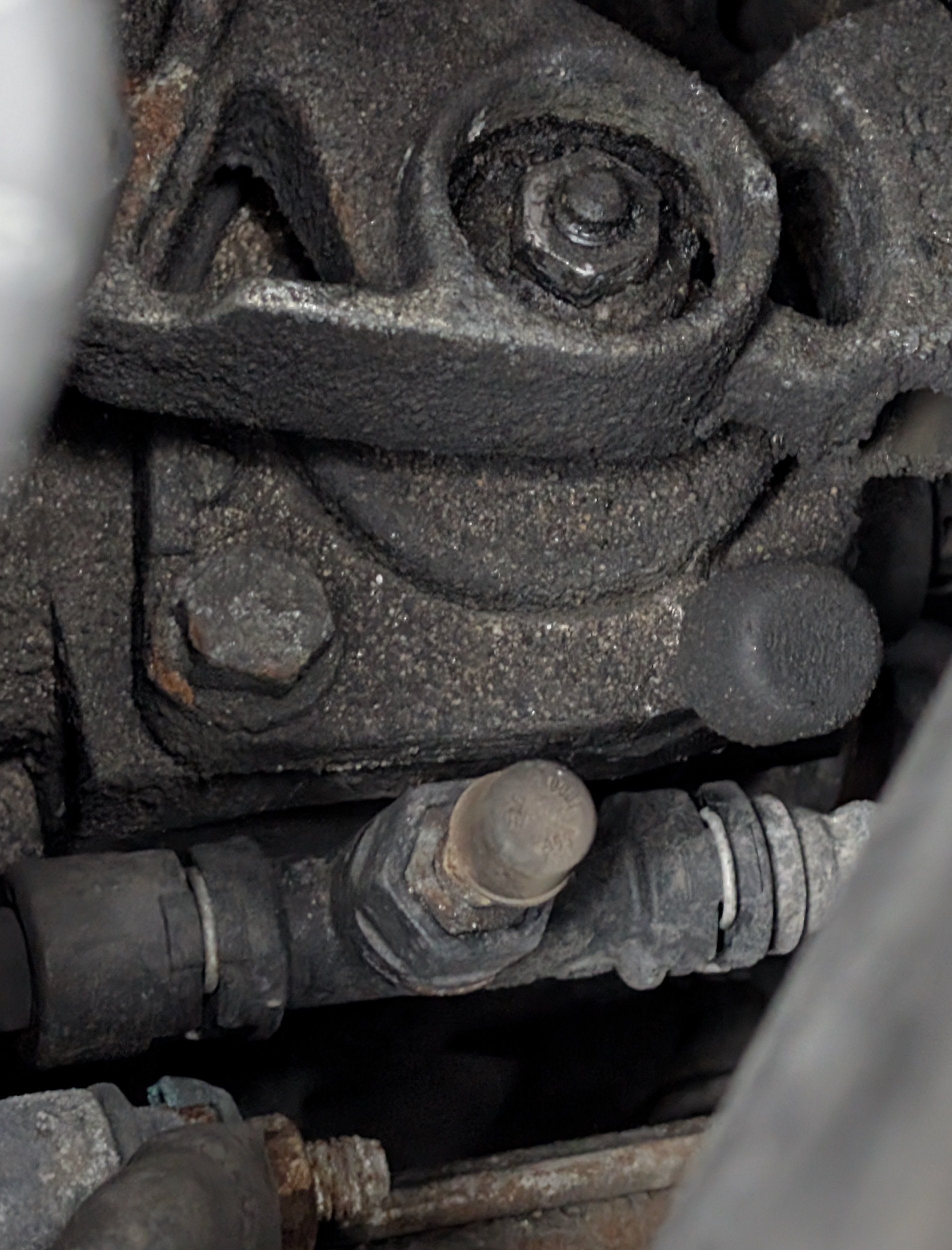

In regards to the clutch, when I bleed them I think I've found the bleed nipple, I'm assuming it's this in the picture?

Which bolts are seized?
The large M12 triple square caliper carrier bolts? or the smaller caliper slider bolts?
If the triple square bolts - ensure you clear out all the junk/rust out of the centre and give the tool a tap with the hammer to ensure its fully seated - assuming you have the correct size triple square tool?
They are tight - 90nm + 90deg - so you would need a breaker bar to remove, which can be tricky to get access of a floor jack.
On some versions you can change the rear discs without removing the caliper carrier - you can just maneuver the disc under the carrier.
Whenever you are fitting new discs it is critical to ensure the hub is spotless. I use a small needle files to carefully scrape any rust away, and a rotary wire brush in my drill.
