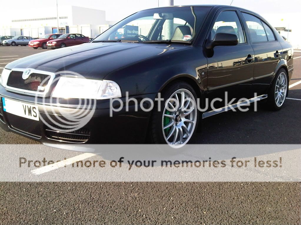

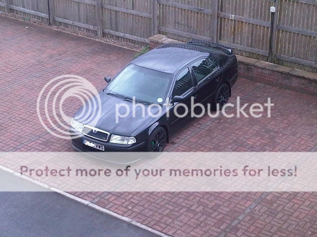

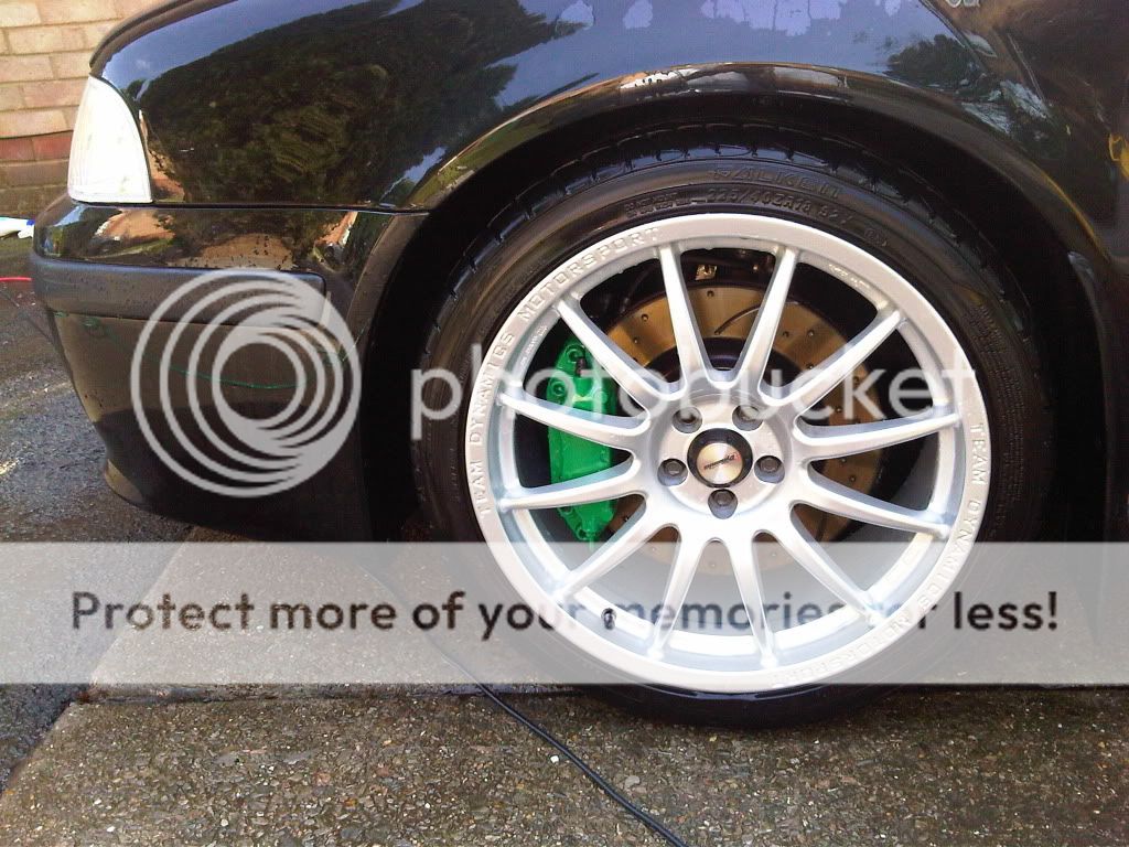

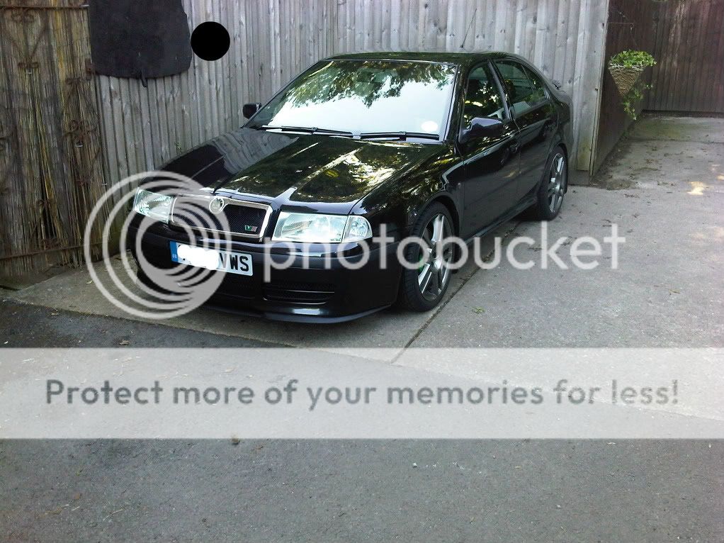

Hi guys,
I am not a Seat owner but have a similar car.
How she is now:
vRS Spiders 7x17 et38 + 5mm spacers
My plans are to take the best bits from all the mk4 Golf platform cars and put them into my vRS as the vRS imo is the best looking and most practical, the only thing I need now is to swap the AUQ engine and the 5 speed gearbox to the BAM and gearbox out of the LCR. but till then the Quaiffe box and remap will do.
Right on to my question. I have the LCR brembos on my car and the spiders dont go over them without 5mm spacers which makes the car really twitchy and naff to drive. I also have some TD Pro Race 1.2 that need 3mm spacers.
I then got some LCR rims so I dont need spacers and its really nice to drive but I cant stand the look of them on the octavia, they are stunning on the LCR but dont seem to suit the vRS so I was thinking of getting the Golf R32 rims that are the same as the LCR 7.5x18 et38?
What I need to know is do they fit without spacers?
cheers
Billy
LCR Ronals' 7.5x18 et38
Team Dynamic Pro Race 1.2 8x18 et35 + 3mm spacers
