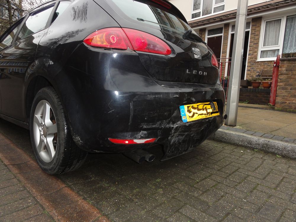

So after nearly five years of owning my pride and joy, yesterday evening saw me experience my first accident :(

My insurers are arranging for my car to be collected next week and taken to an approved garage to assess the damage to my 58 FR TDI.
My boot lid shuts and locks, but the car tells me that the boot is open according to the MFD display, and my reversing light no longer works which means I'm uncomfortable driving the car in the interim.
I haven't the foggiest clue as to what lies behind the rear bumper of my Leon, so I'd be really appreciative if those more expert in these matters would please advise on how much structural damage there is likely to be behind the bumper.
I'm praying that there's not been enough damage to warrant an insurance write-off so any advice is gratefully received :(

I can't see that needing much more than a new bumper, a few plastic brackets, adjust the boot catch then paint.
No way a total loss.

I've never had the bumper off, but i'm thinking there is plenty of space between that and the chassis. From the pics it looks like bent plastic and will be a case of a new bumper - although, if' you'd been the first car the VW hit then it would be a different story...

If the boot lid is not shut on the second catch, it will say the boot is still open. So it's highly likely the rear panel has gone it a bit.

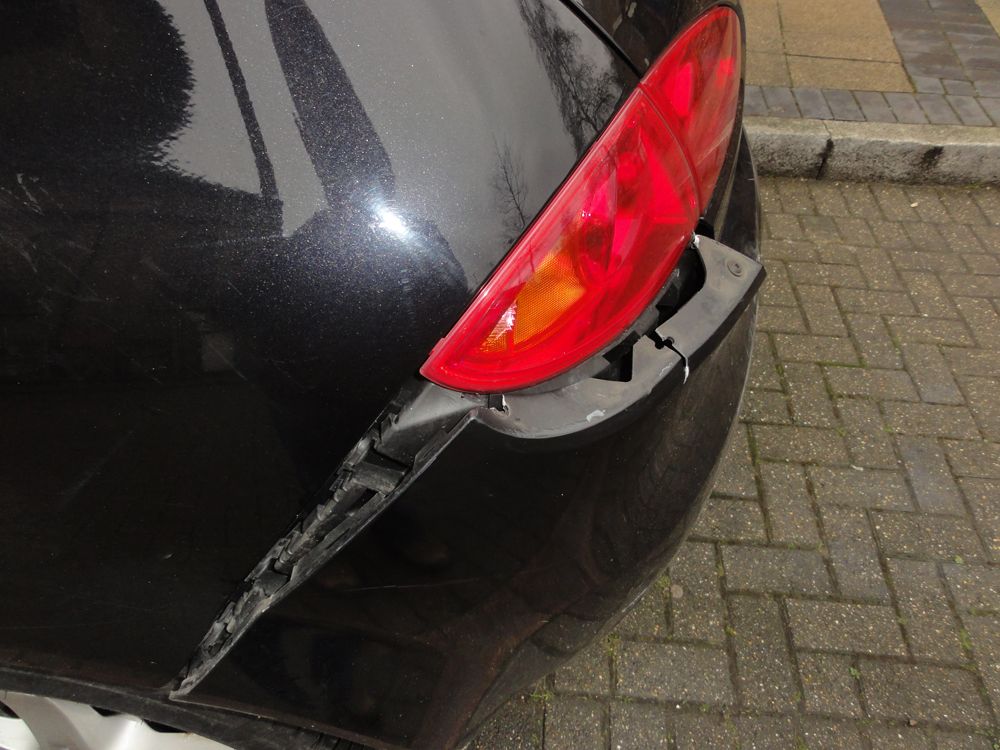

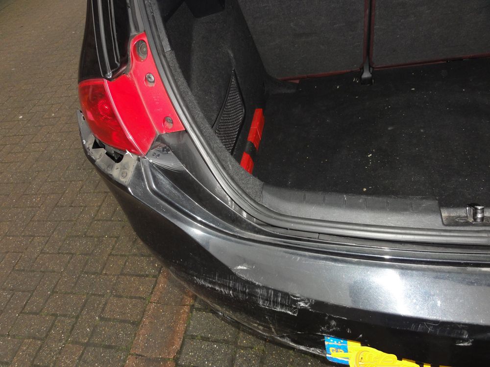

Watto_UK, I've noticed that when the boot is shut, the boot lid touches the bent bumper at the area highlighted. I'm wondering whether the malformed rising bumper is now preventing the boot lid from engaging the second catch? It might be a daft idea but I'm wondering whether the lack of a second catch engagement is also preventing the reversing light from illuminating?
For what it's worse, this is what happened to the Focus who took the impact from the VW
And this is how the clio fared against the Focus. The poor lad's boot didn't shut at all as the catch had been pushed too far forward.
None of the lights fitted to the tailgate will work if the tailgate is open. Reverse light, rear fog light, and 2 small tail lights.

You may be able to adjust the striker up a bit to compensate as a temporary fix. I can't remember if it's tx30 or tx40 bolts, though. Just slacken thim a little bit, pull the striker up and re-tighten them.

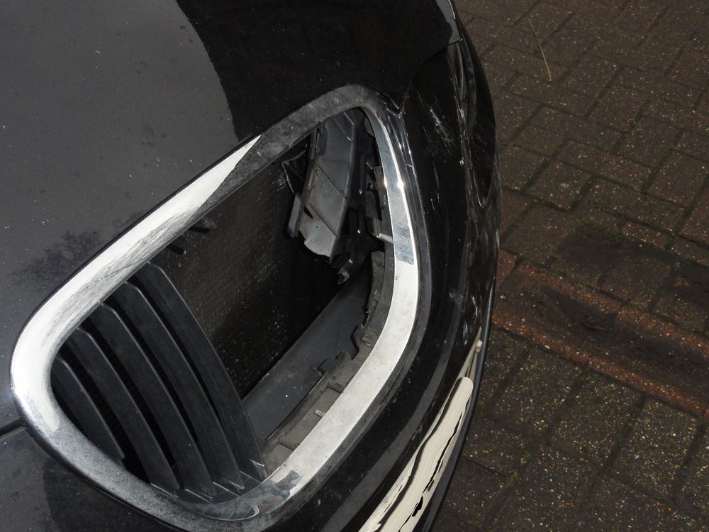

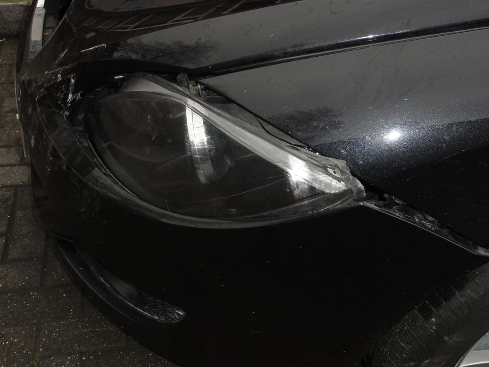

There is no way that is a write off. I was rear ended at the end of January and was pushed into the car in front and mine wasn't a write off and my car is 2 years old than yours.
My car needed new rear and front bumpers, new nearside headlight, new grille, new radiator, new exhaust (rear section only) and a lot of small bits.
Here's what mine looked like once i got it home.
